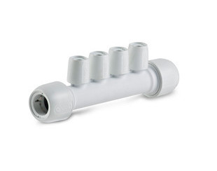

Hi, I am working on my new bathroom and have the plumbing to plan. At the moment there is a hot and cold feed coming up under where the bath (in 15mm) will be. I need to split the cold four ways (Bath, toilet, shower and sink), and hot for the same except for the toilet.
I could do a T connector for each, but wondered if there is something more convenient like a multiple splitter that I could put in. it would be accessible by removing the bath panel, so maintenance would not be a problem.
Any thoughts ?
Owen
Well you do get multiple branch manifolds but never seen any WRAS approved for Potable water.
like rab said, you can get these but don't know if they can be used other than for heating?
