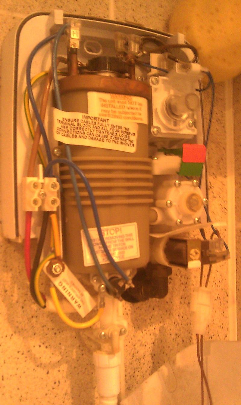

Here's a pic for you all - see if you can spot the rather worrying problem (no its not that the cover is hanging off! ;) )
This was a job I went to last week where the customer told me the shower wasn't working. Checking in the meter cupboard and finding the trip switch down I thought it would be the simplest job I've had for a long time. But since there had been some issues I decided to check inside the shower.....
Apparently it has been like this since a 'friend' came to look at it two years ago.
Apologies for the pic quality - my super duper new phone decided not to include a flash :evil:
ok, who's going to be first to say it looks ok to them?
besides the dodgy looking earth bolt?
might be the quality of the photo, but it's not imediately obvious to me..
ah, is that earth actually in the neutral blobk then? looked like an earth cable doubled back to me..
Earth linked to neutral, cable looks rather small csa for a shower and whats that thing dangling on the right hand side?

Yes, apparently said friend knew enough to put a meter across it when it stopped working a couple of years ago, and discovered there was no connected neutral, so decided that connecting Neutral to Earth with some 10mm stranded was the perfect answer - which is how it has been running ever since....... :eek:
As conny noticed, its 6mm, and a 9.5kw shower, with a 45A wylex plug in trip switch. It used to be a kitchen with a cooker point, so I suspect the person who installed it just extended the existing cooker cable, quite possibly with a junction box under the (tiled) floor.
The 8 years or so of slight overload may be to blame for the neutral fault, or a screw may have worked loose. I dread to think what state the 2.5mm earth is in after running like this for two years though!
Needless to say I recommended they didn't have a shower for a while, and am returning to run a whole new 10mm cable..... :rolleyes:

More like just plain TN-C! Dodgey at the best of times (but has been used in the past* where the CNE conductor is off a much larger CSA than the phase, so that volt drop is minimal - think single core MICC), but in this case this case the exact opposite is true :eek:
*wouldn't be allowed today, TN-C is actually illegal to install these days (The Electricity Safety, Quality and Continuity Regulations 2002 [section 8, sub section 4])

I couldn't persuade them to replace the entire fuse box, so I will be fitting a new 1/2 Way CU for the new cable
