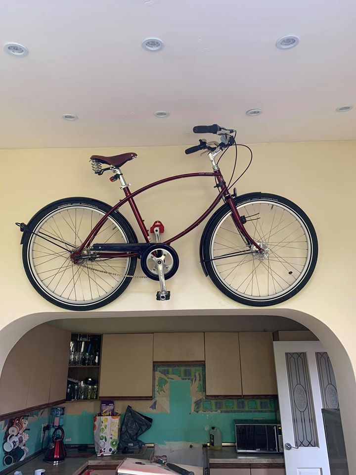

upload_2022-1-17_12-17-48.png Some thing like shown can be good, but turning a ceiling into a planetarium seems a little pointless. My kitchen had a single fluorescent lamp 65 watt, was far too bright and when I fitted a 22 watt LED tube found that ample, then son moved in, 98361719_10158572386853420_1054327038518755328_o.jpg can't remember how many, seem to remember 16 so 16 x 3 watt = 48 watt, over twice what I had used. He did not even arrange them as the great bear.
However did not look too bad, until the lamps started to fail, he blames using cheap lamps from toolstation, I am not so sure, had the first LED to replace the fluorescent also fail, not happy as back then LED tubes were around £24, price now dropped a lot, possible a poor switch causing spikes, or spikes from the supply, but small LED lights can't have the size of smoothing capacitor used in large lamps.
I have not lost many LED lights, just a couple, but he has lost around 20, and it gets expensive.
