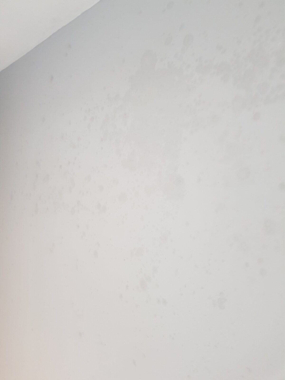

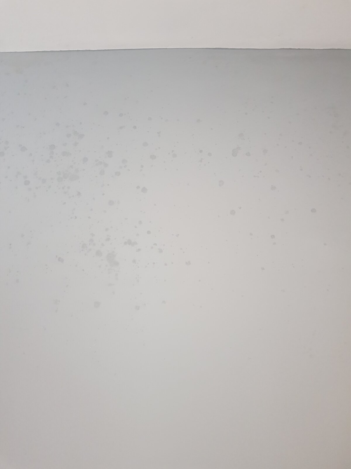

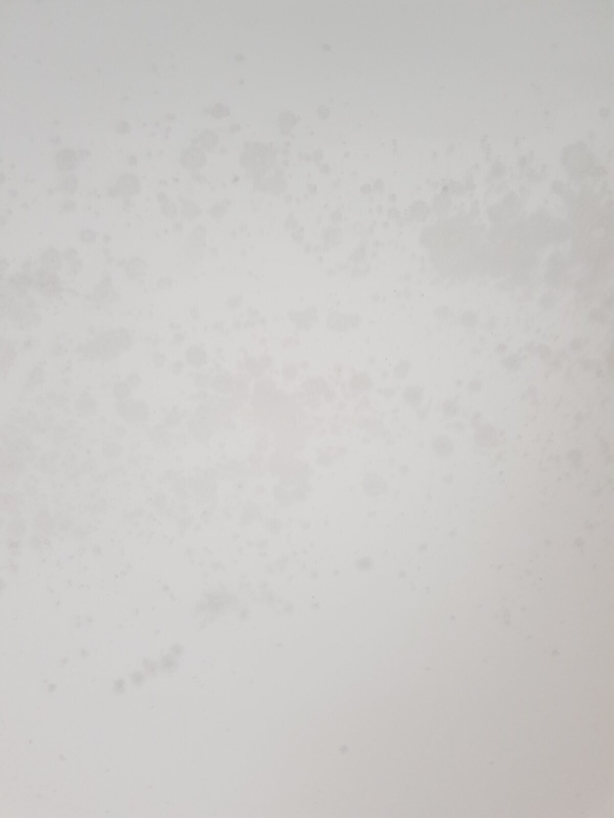

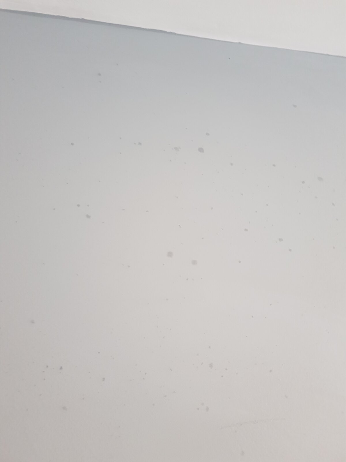

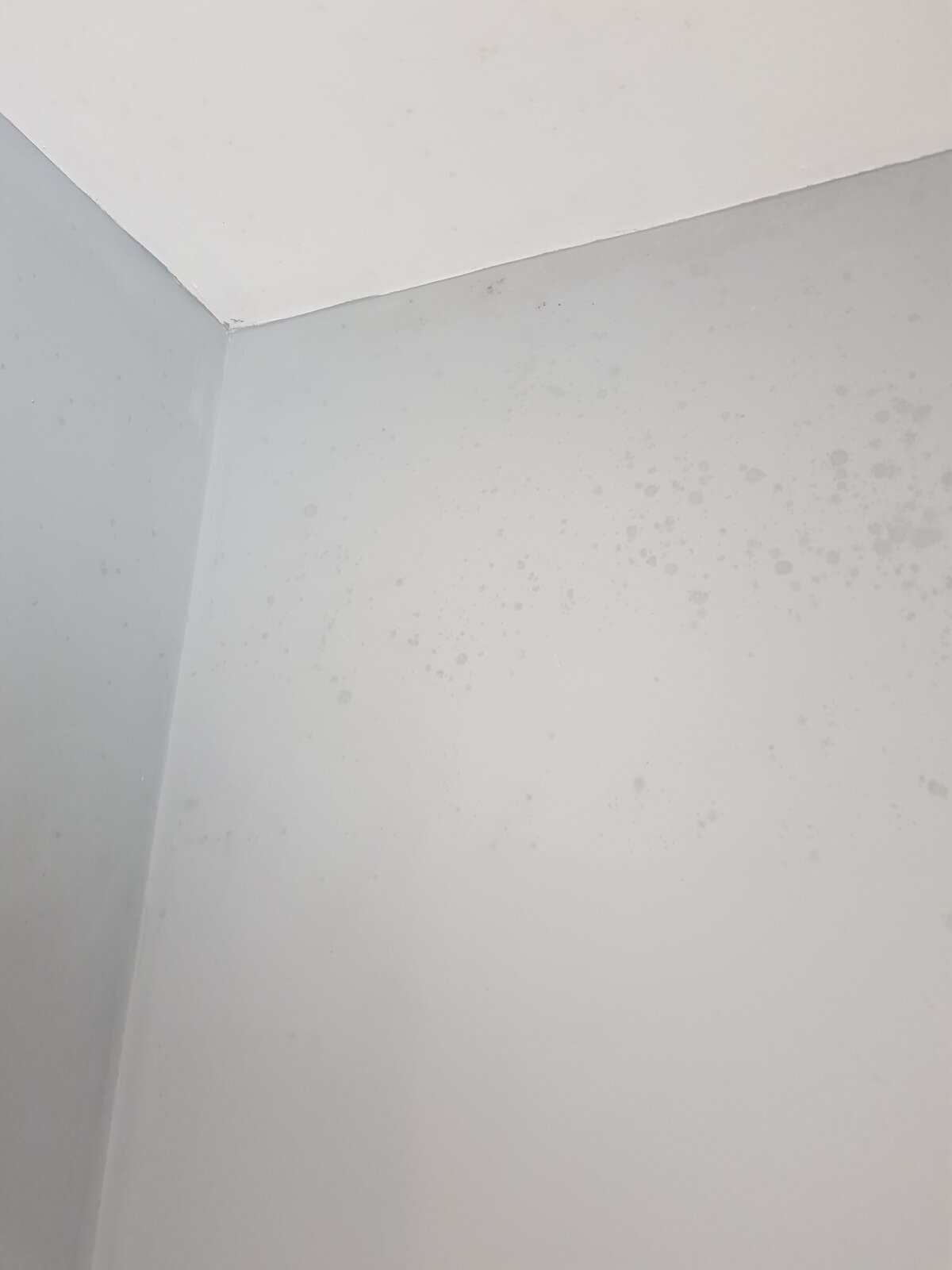

Hi all, over the past few months we've had spots appearing on all 4 of our bedroom walls, I'm just wondering if anybody has had similar resolved the issue? It's on the first floor, the room does suffer from high humidity and we get a lot of condensation on the windows, we've recently started using a humidifier but from what I can tell this hasn't stopped the spread of them, I've tried mould sprays etc to try bleach ir and wipe away but they don't make a difference so I'm not sure what it is? Any help is much appreciated

It doesn't look like the typical mould, either in location or appearance. Might something have been splashed, or something oily been on the plaster/wall before painting?
Not to my knowledge, we've lived in the house a couple of years now and it's just been over the last 6 months or so it's happened, the walls were white originally when we moved in before we painted anything and there was nothing showing at the time, as you say it doesn't look like typical mould and anywhere we've had it before in the house I can bleach it and get rid of it easily enough, but this just stays visible
I have something very similar in the wetroom of a house I moved into last year. The spots have been there right from day one. Although they're not in the typical locations I would expect mould to occur, I'm guessing either old mould spots have been over-painted with emulsion, or (perhaps more likely) fly-spray or similar residue has reacted with the emulsion.
Are the walls Dot&Dab or solid plaster?
Are the walls solid or cavity?
Is there render on the outside?
the fact that you've got so much condensation is significant but the dots, as above, dont look like typical condensation spotting.
Solid plaster, the house was built in the 30s I believe and is cavity walls, and there's no render on the outside its just brickwork.
Yes it's really strange, as I say nothing seems to get rid of it, I could probably paint over it but without knowing what the issue is, it could just start to come back through
A little test - does placing a warm iron (don't tell the wife) on the spots make them better or worse?
