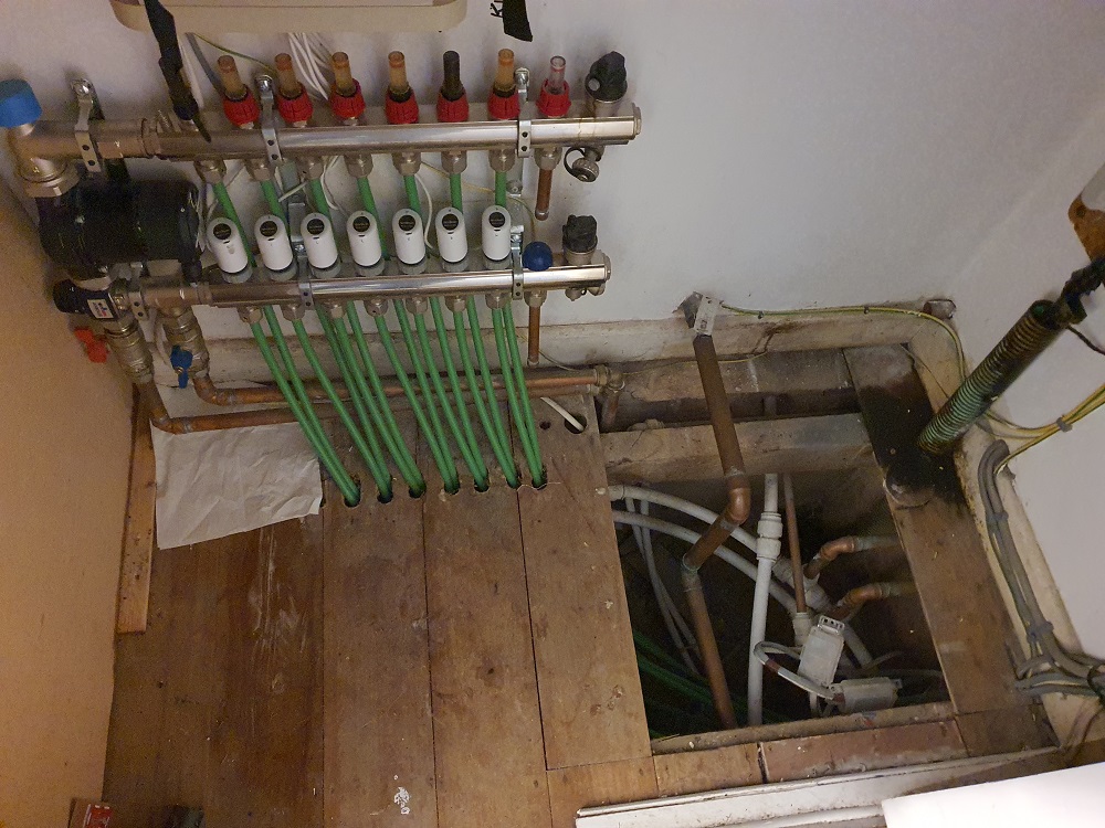

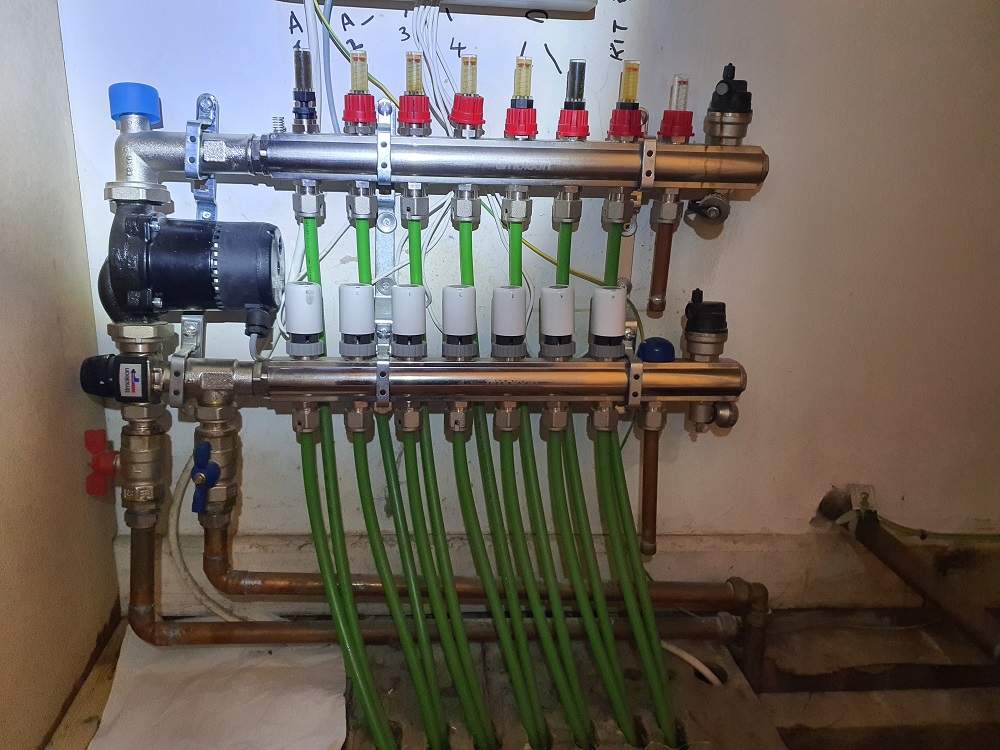

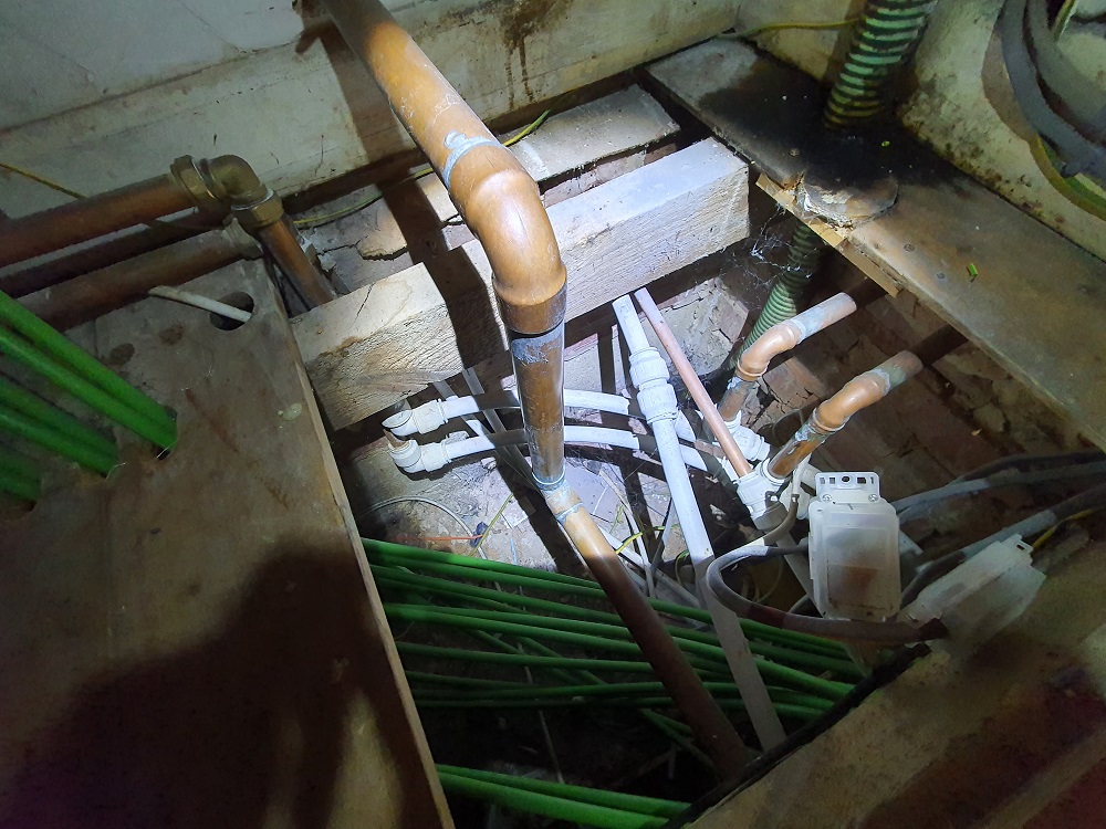

Bit of an update today. I lifted a couple of the floorboards under my stairs. From what I can tell from the visibility I had, there is no foam/PIR boards under the floor between the 100mm joists. I got a couple of photos from above and it looks like the hot feed from the boiler to the UFH manifold is just dangling in the floor cavity uninsulated. I'm assuming this isn't best practice or standard insulation?

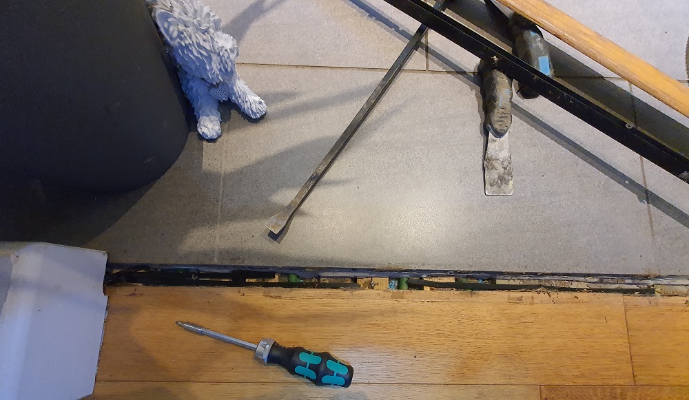

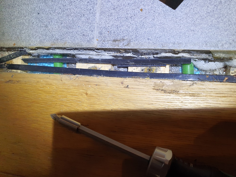

I removed some wood trim between my tiled/wooded floor to try and gauge what was under there and there appears to be some plastic with polystyrene balls. I didn't want to poke or split it, but it looked wafer-thin. What a mess! I'm tempted to rip it all up one day, insulate between the joists and install rads everywhere.
A friend of mine also commented that the underfloor heating pipe looked a little slim. I measured it and it's just over 12mm. Is this standard?
Looking at the pic below, the pipes appear to be spaced about 15cm apart also.
Without wishing to add more misery, 15mm is standard pipe, as far as I'm aware.
The insulation I'm presuming is underlay for the wood floor, and will be a few mm thick, this will do nothing but leach heat out.
Others will comment with suggestions, but I'd address the insulation situation, doesn't look like a lot of room to get under there.:oops:
It’s a manifold system which allows smaller diameters pipes to aid installation .
Your timbers need ventilation whether it be loft or flooring .
Thanks everyone, one thing's for sure. This place is an absolute disaster.
So, guess I'm back to having to rip out the floor at some point, insulating with PIR board and starting again. If only people could do things properly first time.
