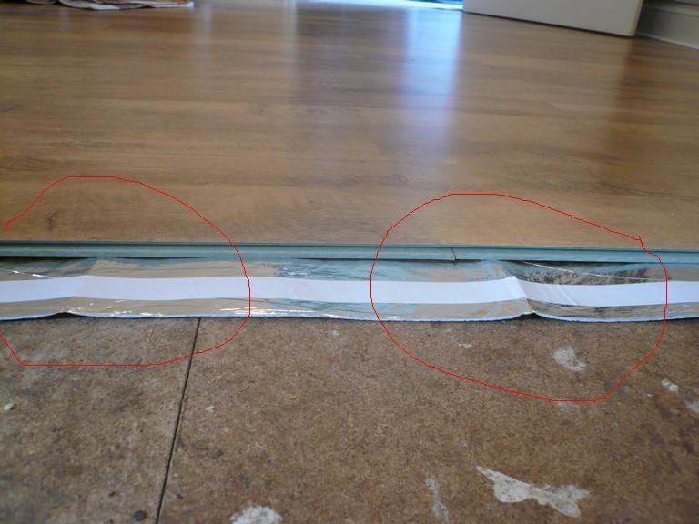

Hi
Half finished fitting laminate floor (Kronofix) in our living room and noticed it feels sort of springy/bouncy when walking on it. I used the high-performance underlay from Homebase (http://www.homebase.co.uk/webapp/wc...ay?langId=-1&storeId=20001&partNumber=1630864) to reduce the noise as this is the main walking path in the house.
Having read other topics and flooring FAQs in internet it seems that this sort of problems is normally caused by the sub-floor not being flat or floor expansion. Neither former nor latter applies, as this is a new installation (week old) and the sub-floor seems to be flat enough.
Can it be the underlay (see the picture attached) which hasn't flattened yet ? Will it settle down eventually ?
Looking at the picture on Homebase website it seems that this is how it should be laid ..
Thanks!

you need a long strait edge to check more than 2mm up or down can cause this problem
you have a 12mm expansion gap all the way round with nothing in it !!
you have undercut the door frames and architaves or left a gap!!
you have used joining strips in door way with 12mm expansion underneath!!
you have no run greater than 4metres without an extra expansion join!!

As for the bouncing, your underlayment - no matter what type of underlayment - needs to lay flat, especially underneath thin laminate flooring that has/can have a lot of flex of its own.
Didn't the Homebase stuff come with instructions of use????
=== nope, measured it this way - seems to be flat
you have a 12mm expansion gap all the way round with nothing in it !! === I have 15 mm all around
=== undercut
=== no strips there yet, gap - just started
=== it is 3x3 meters so far
=== yes but it is as simple as "put it silver side up and seal together", does not say anything about unevenness in places where it used to bend while packed flat, as on the picture
I used the cheap white one from IKEA in other rooms and it feels much firmer, but it is softer and probably straightens faster under the weight of the floor
The cheap one no doubt come on a roll? And your laminate floor hardly has any weight of its own. Trust the DIY-sheds to explain as much as they did when selling you stuff!
I think the ridges of the underlayment are causing you this bouncing problem. And I hope for you that once the furniture is in place it will start to "flat out".

Looking at the photo it seems that there is a peak in the chipboard and a void to either side under the laminate (gap between the laminate and underlay) - if this is the case then it will spring as you walk over it.
I think big-all's coment about the use of a straight edge might show you your subflloor is probably uneven, you can't tell if a floor is flat by looking at it, you have to check !! A few mm is enough to cause your laminate to bounce. Also what petest67 mentions about a peak being there sorta proves the point !! Your subfloor is uneven.
Yep, did more measurements in different areas and directions and it seems to be uneven by up to 5 mm in some places.
Is it too bad ? You can't really feel that it is bouncy while walking, one can only see from the perspective that it is actually waving.
other things that can cause problems tack screw nail sitting proud grit or foreign object and folded/trapped underlay
so you need to look for high points in the laminate as well as low points on the floor
