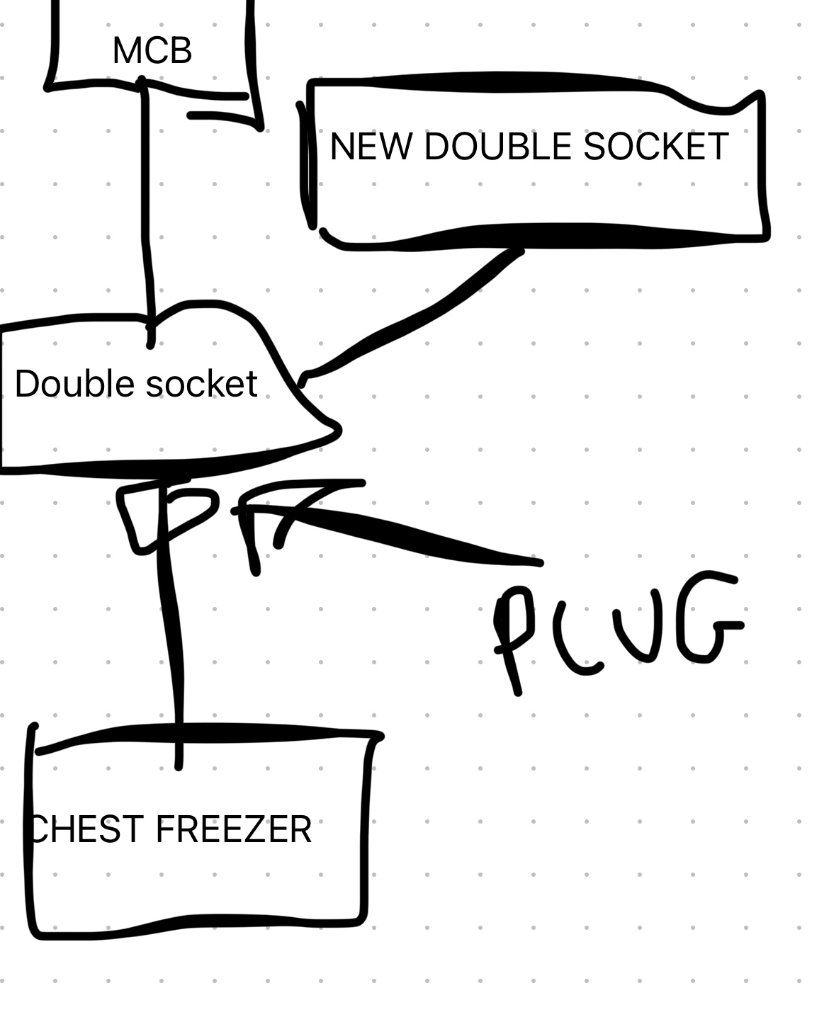

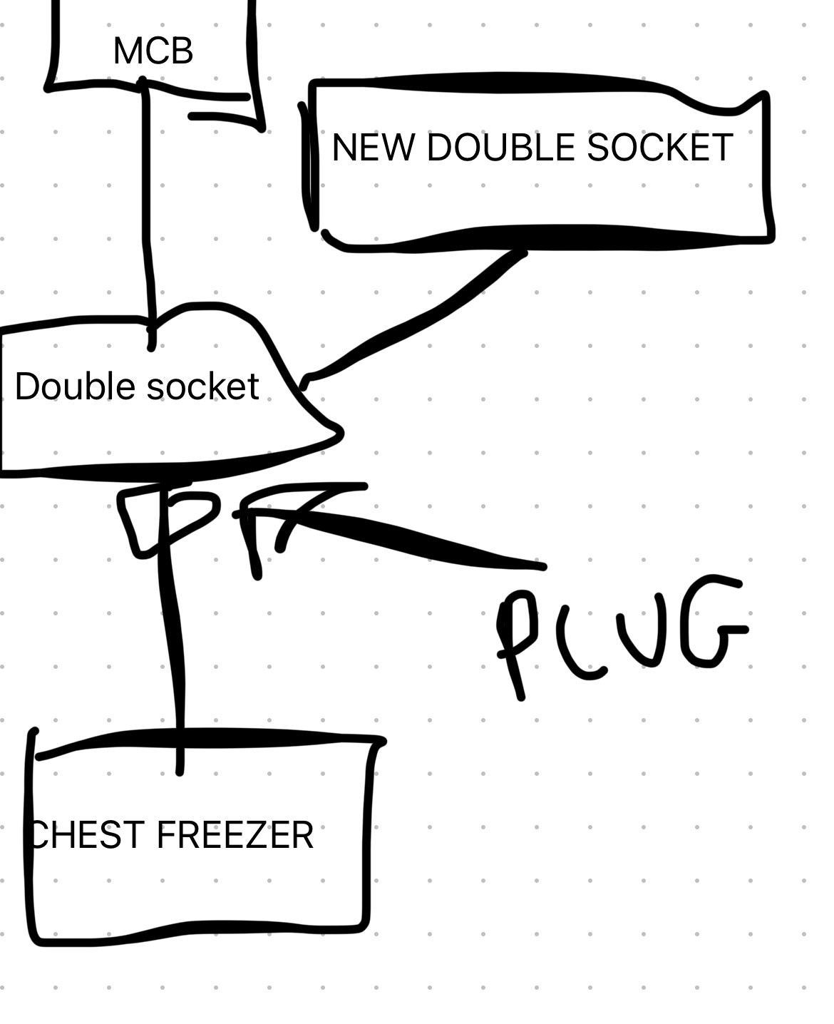

We have a double socket which is wired directly to the MCB. I want to put another socket about 6 feet away. Can I just spur off this? Have attached picture to give an idea of what it is.

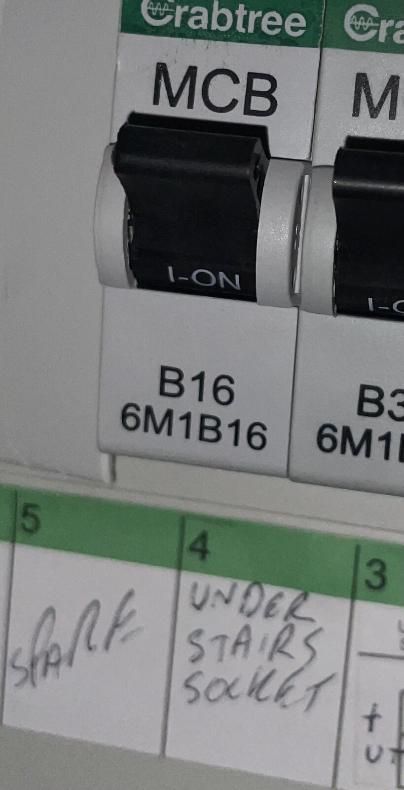

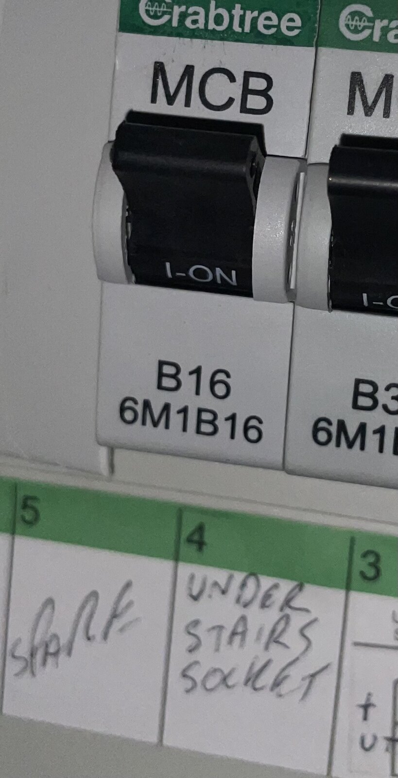

This is the breaker

Thank you. It won’t have a big load on it, just a plug in air freshener or some fairy lights
It's not really a spur, it's a radial circuit. Currently a very small one.

No, it’s just a double socket in the kitchen which has the small chest freezer plugged into it. The kitchen electrics are on a different breaker.
Assuming it is a B16 with RCD protection then no problem, I would guess originally supply to an immersion heater, I know my last house there was a kitchen switch for the immersion which when immersion removed was made into a socket, however this house also has a supply for the freezers, which is very different, as it comes from the solar panel inverter, and is an uninterruptible power supply (UPS) and the current draw is limited to 3 kW even when the MCB is rated higher.
