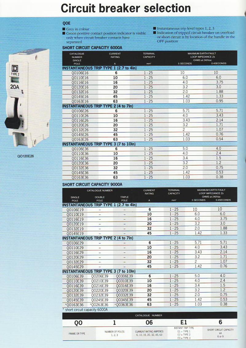

Has anyone got reference for the maximum zs values for these mcb's?
All Square D, BS 3871, Type QO-E
I need 45, 32 & 10 amp.

Do they have the catalogue no on them, such as QO110E16? (the digit after the E is the type)
I havn't been given that information. Judging by the content of the periodic I will be visiting anyway before I sign off.

I have an old square D catalogue which has the max Zs figures in, if I think on I'll try and scan it in tomorrow evening.
First figure is for 5 seconds, second is for 0.4 secs.
45amp type1 1.42/1.33 type2 1.42/0.76 type3 1.42/0.53
32amp type1 2.00/1.88 type2 2.00/1.07 type3 2.00/0.75
10amp type1 6.00/6.00 type2 4.00/3.43 type3 4.00/2.40
Those figures are straight out of some original Square D literature
