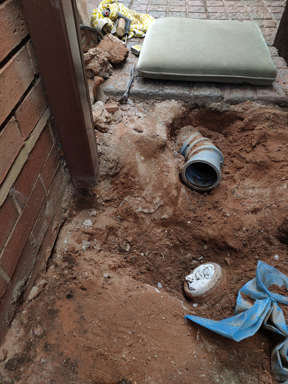

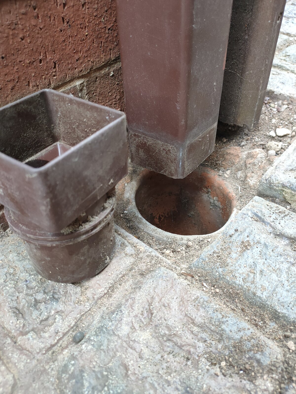

Hi, I've just swept cracked concrete away from around downspout at side of house, and it came away in a few lumps.
Pushed around the side of the downspout was plastic bags and someone just cemented on top of the plastic around the downspout.
I'm trying to locate a 100mm grid drain that will push fit into the old clay pipe but can only find 110mm fitting.
The top of the 100mm clay pipe is only
40mm ish below slabs height.
Any ideas appreciated.
Thank you

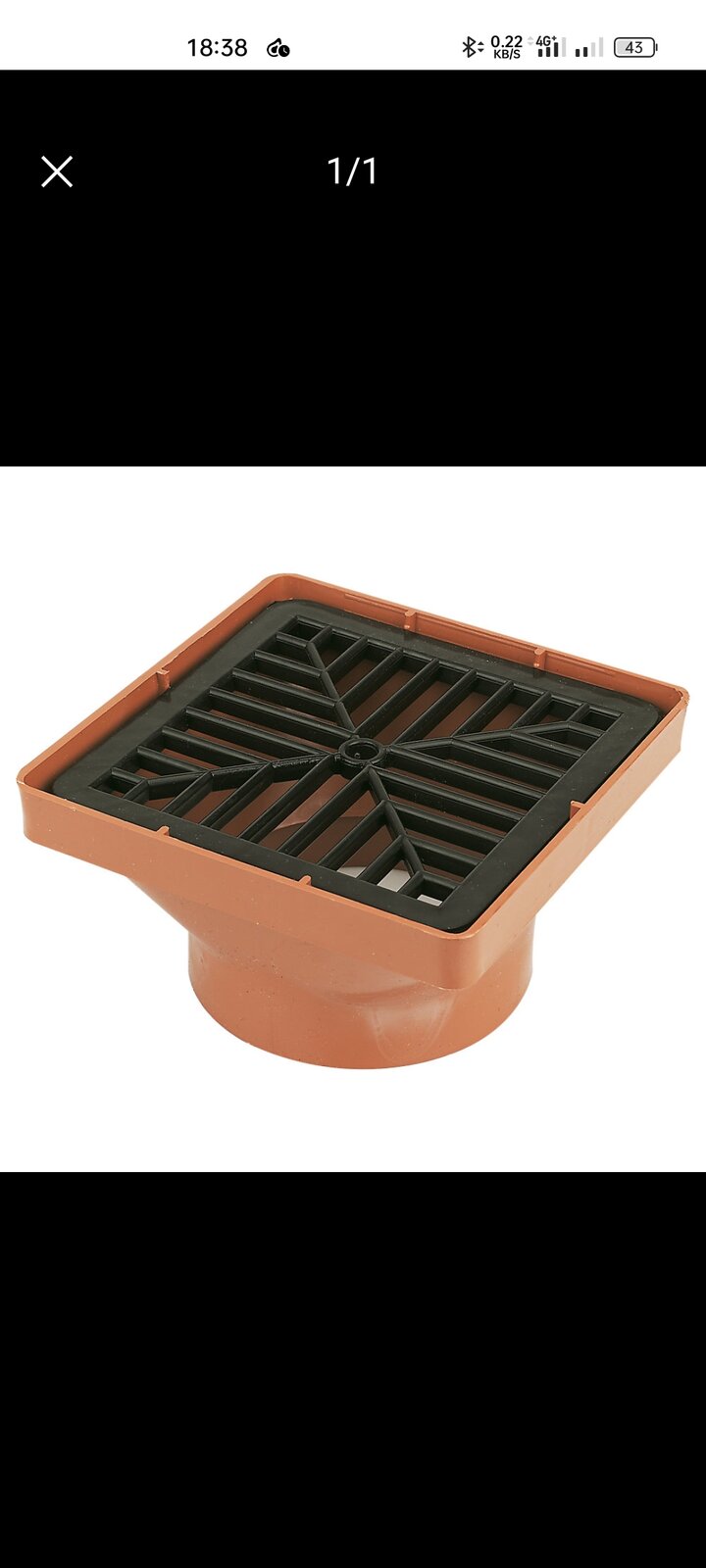

1.Photo of problem.
2.What I'd like to fit in it's place

May need a bit of creative alteration to space the downpipe from the wall to line up, but one option is https://www.screwfix.com/p/floplast-rainwater-adaptor-square-65-round-68mm/38593
Ideally need something with an offset socket, for the downpipe, but I think you will struggle to get anything that will fit inside the drain.
Alternatively, fit a McAlpine DC-1 into the clay spigot, then that will take you to a 110mm plastic socket, and you can go from there, but will look a bit bulky and not very aesthetically pleasing above ground.

If really like to fit the drain type in the photo, but may have to go with the Screwfix adapter you linked.

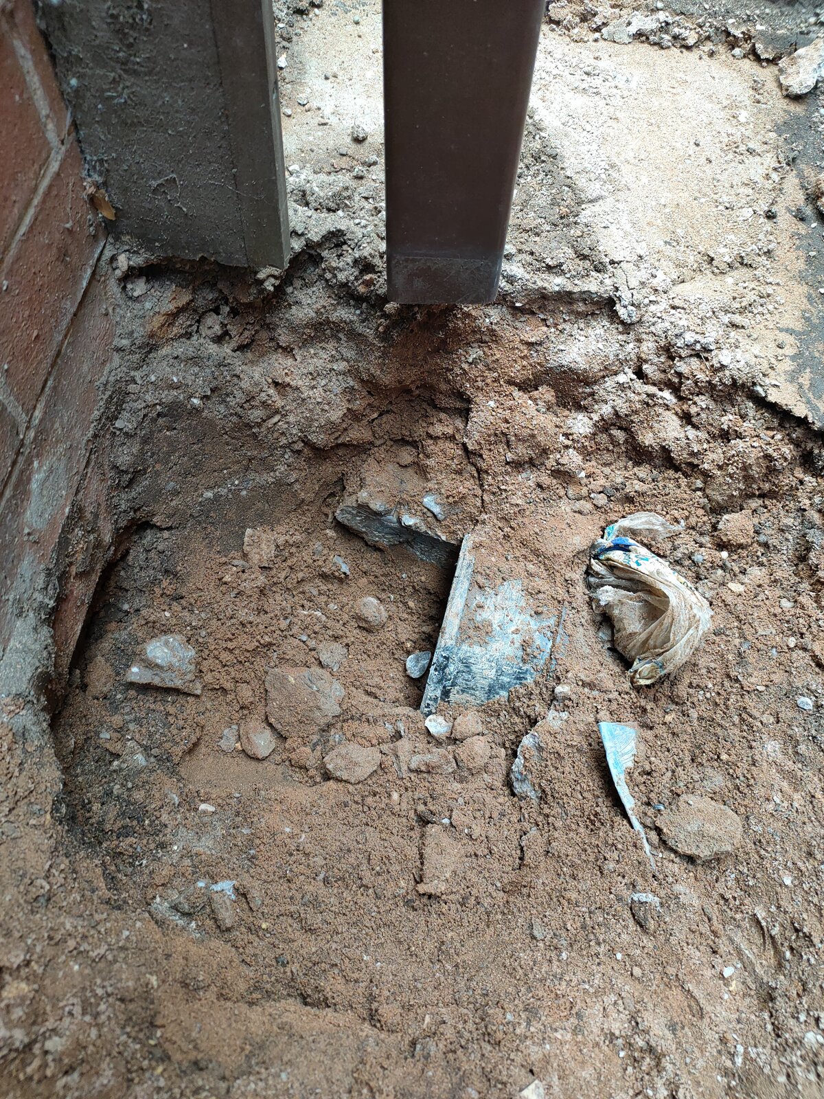

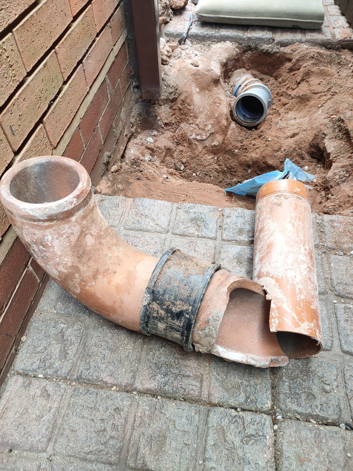

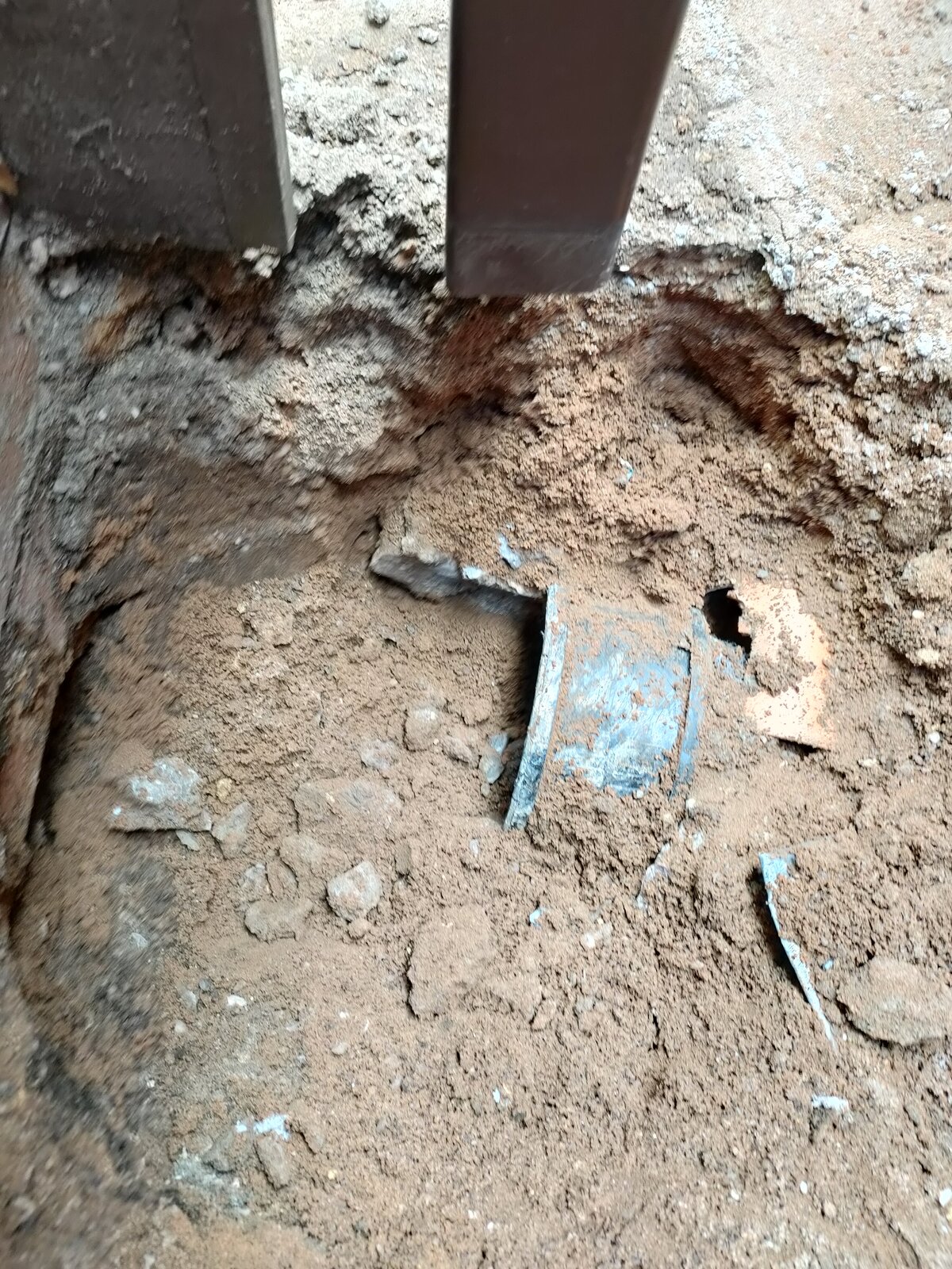

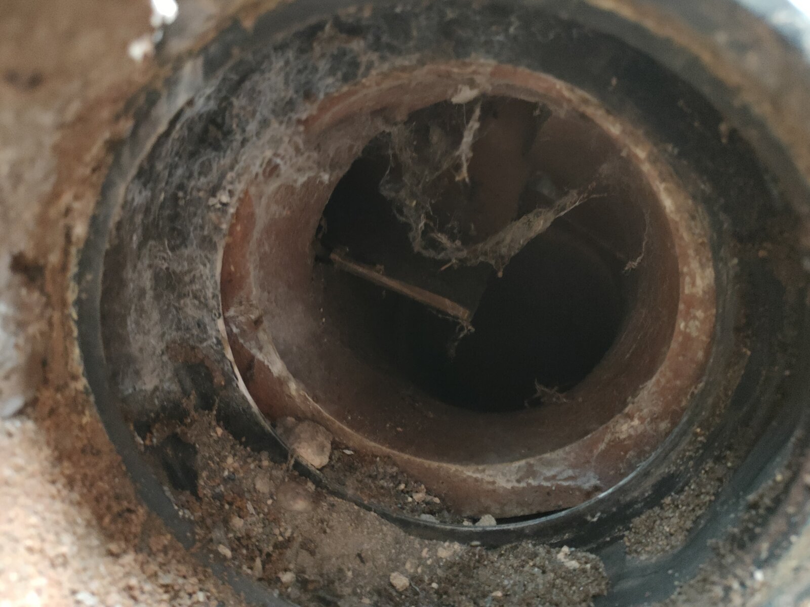

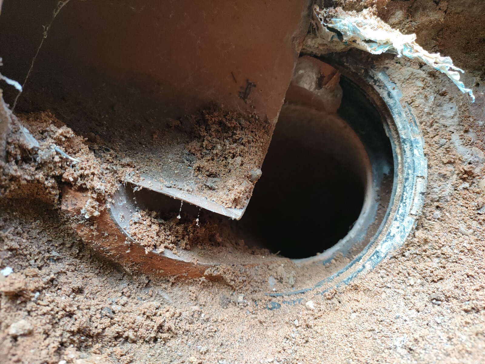

I decided to have a dig around the pipe and see what was there.
What a bodge job...
Plastic pushed in around the pipe again.
None of the broken pipes were what I did.

What are you left with now? That looks like Hepsleve clay drainage, so I'd get a appropriate clay to plastic coupler, and replace what you've removed with plastic. If its a Rainwater drain, (not a combined sewer), then you dont need a trap,, and can make a direct connection to the drain.

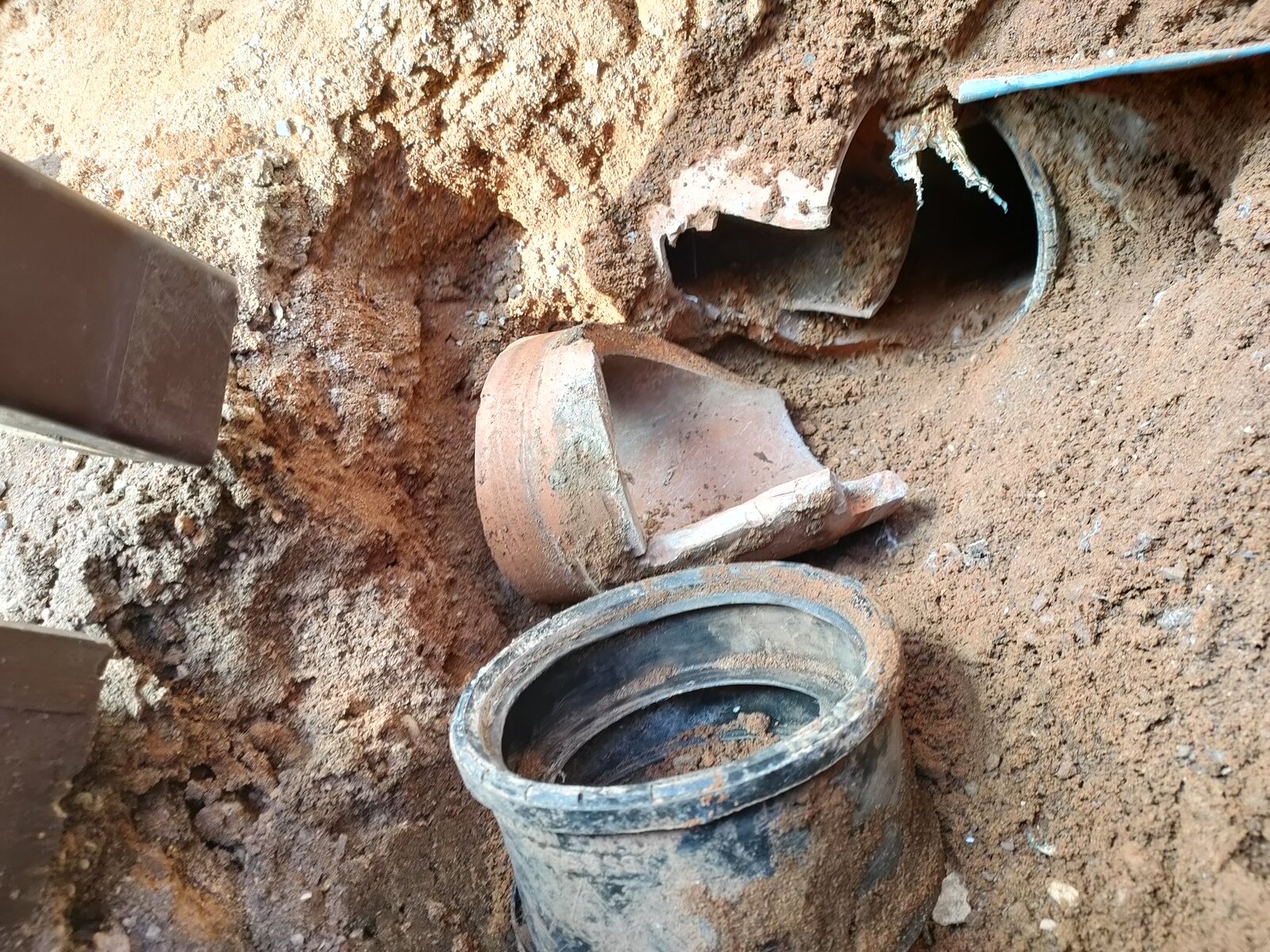

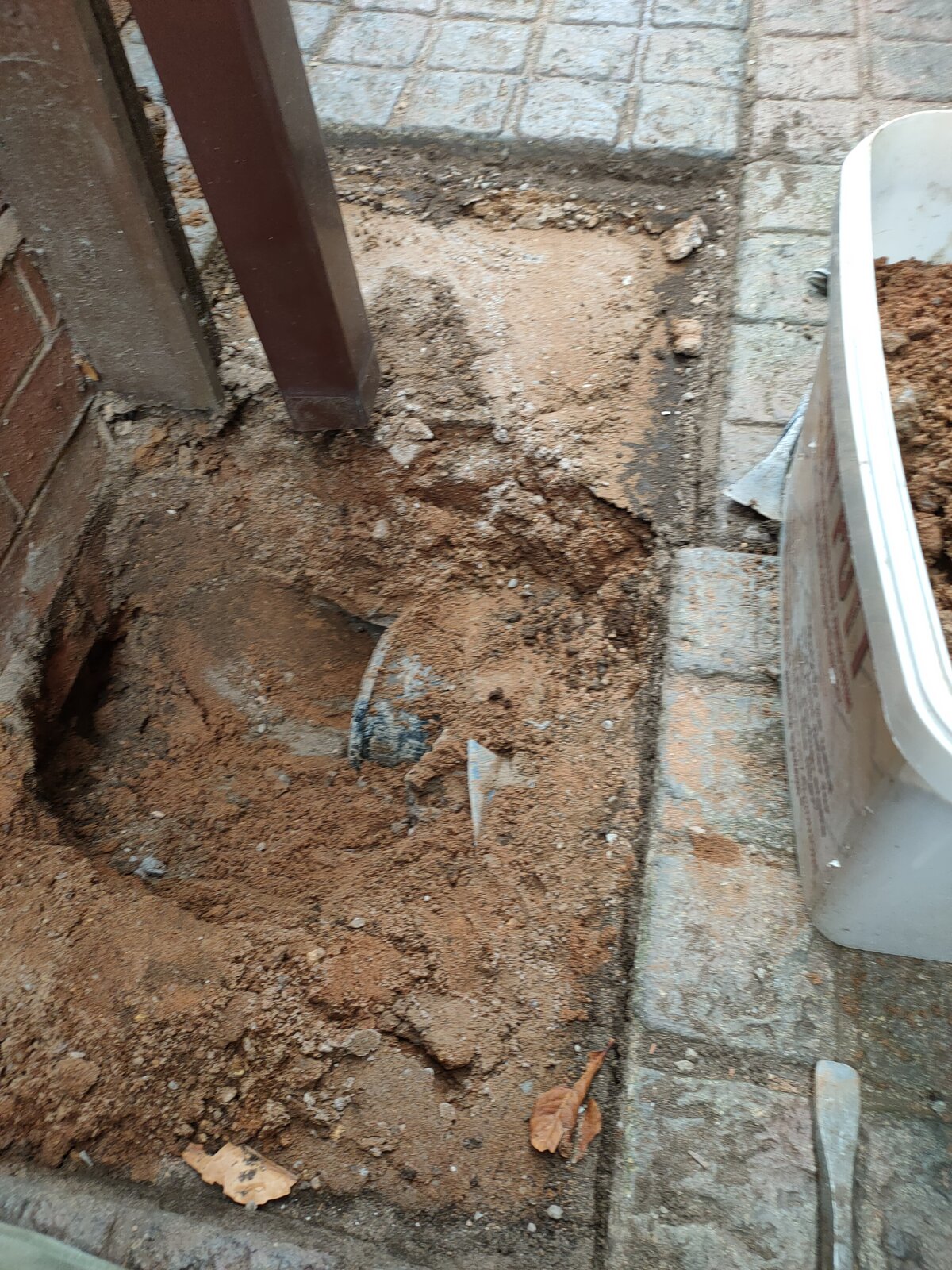

1st pic what it's like now.
2nd pic what it was connected up like.
Sorry missed off another plastic connector that fitted between the pipe in the ground to the 3 way mess.
I'm not sure whether it's combined sewer or not. Never smelt anything around that area in the past.
Might be the plastic wedged around the pipe that kept the smell in.

You've got the room by the look of things, fit a bend onto the clay spigot you've got, short piece of pipe and drop a Bottle Gully in, will cover all bases then.
Sorry I'm lost at what I'll need to connect all 3 pipes together (which are at different heights/directions) and line the top of bottle gully with the top of the slabs in that not big space?

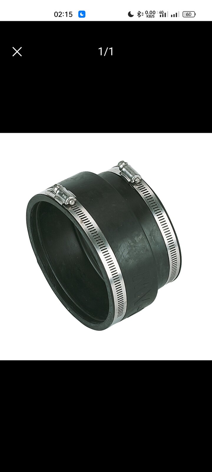

110mm Bottle gully I can get from Screwfix.
Grey pipe in photo is for 110mm.
Clay pipe is 100mm/4in internal.
Hoping this flexible adapter will connect 100mm clay pipe to 110mm plastic so that's a start.

Have a look at the Osma bottle gulley with rotatable top and extra inlets
I tried the bottle gully option, but I really haven't got much room to play with and that would have ended up way too close to the clay pipe to connect.
That's probably why it was botched originally.
My final decision was to just connect the roof guttering downspout into a grid hopper, then 110mm pipework into 100mm clay pipe with McAlpine DC-1 (thanks Hugh).
The grey pipe from conservatory guttering was disconnected totally and I'll now reconnect into house roof downspout at just below conservatory guttering level.
