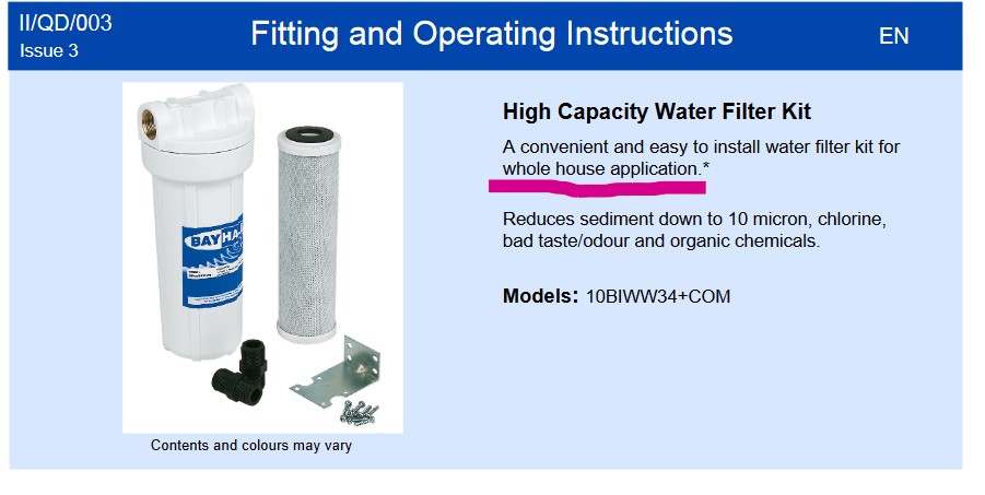

1. Can you be more specific about which filter you have fitted?
2. If its Screwfix 16747 its not designed to be fitted in-line with your water supply. Its designed to operate a single tap. Not sure why Screw fix say it offers "whole house protection" then go on to say "can be installed on supply to single drinking tap."
If it didn't squeal before it was fitted, it squeals when it is fitted and then doesn't squeal when it's removed, guess what's at fault ;)
There may be a seal inside that isn't happy, maybe take it back and replace with a new one and see if it still does it.
If it is the one in screwfix, as suggested, then the MI does state it is for whole house protection so is would be fitted on the mains. The way I read it is it could also be used just to filter a single drinking tap if preferred.
Yup... it is the Screwfix 16747. And contary to the first suggestion, it is meant for whole house (see attached picture). Sadly I need whole house protection as we have had issues over time with crud comming through the mains and clogging up shower/tap filters.
