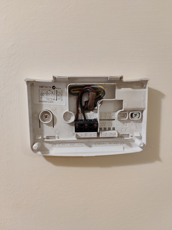

A downstairs thermostat wired into the wall, a Honeywell CM907 (photo attached).
An upstairs thermostat wired into the wall, another Honeywell CM907.

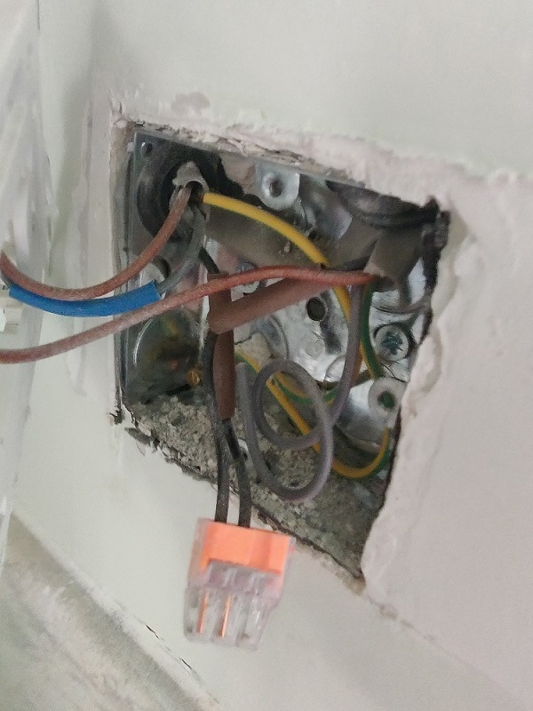

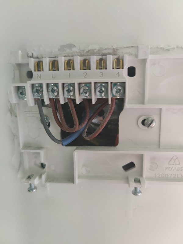

A panel underneath the boiler, a Honeywell ST9100C. (Photo attached of both the backplate wiring and the wiring behind the plate. I note there seems to be an unused brown wire, not sure what this is?).

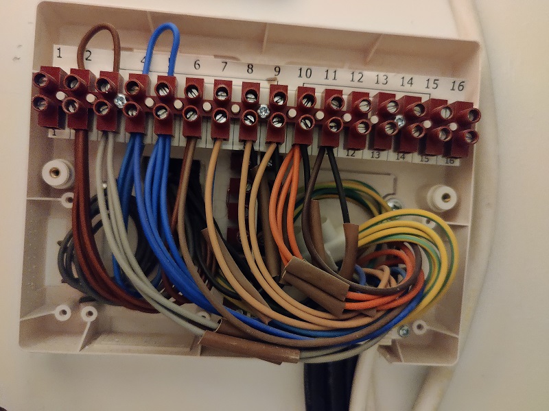

In the same cupboard, a big box on the wall full of wires (photo attached).
There seem to be 3 metal box valves in the cupboard upstairs.
I believe the two wired CM907 panels control the two separate heating zones via these valves, and the third must have something to do with the hot water?

Easy enough to do. I'd recommend two Nests. Heat Links can be wired directly into your wiring centre (last pic) and the wires supplying the existing CM907s repurposed to provide power to the Nest thermostats. The 9100C wires can be made safe and put behind a blanking plate

Often it's simply a matter of replacing individual components with smart devices. The design of your system currently presents some difficulties for a novice. To start with you currently have 3 devices at different locations; 2 CM907 room thermostats, and a ST9100C timer for heating the hot water cylinder.
To go fully smart would normally involve re-routing the wiring from one of the room thermostats and the water timer together at the same point. [Nest, Hive, Tado for example] so as @muggles pointed out this rewiring would be done at the wiring centre. ["box full of wires"] However it would require a good working knowledge of how the heating system is presently connected and functions as well as a good understanding of electrical circuits. Do you know how to find out for example where each of the wires in the wiring centre goes and what it actually does?
The next problem is the CM907 room thermostats are battery operated so do not have a 230V supply connected to it. With most smart stats either the receivers (the device where the thermostat wiring goes eg Nest, Hive) or the thermostats themselves are mains powered so a new 230V supply will need to be installed for them.
As I see it, the easiest route to go 'smart' would be to leave the hot water controlled by the ST9100C timer as it is now, and install two battery operated smart thermostats to replace the existing battery operated room thermostats. Tado make a wired smart thermostat with a two wire connection.
Another alternative would be Google Nest-e The two wires at the existing room thermostats would each connect to a battery operated Heat link. The downside here is that the Heat link and Thermostat are two separate devices so unless you wanted to move the existing thermostat wiring somewhere out of the way, both would be out on display.
Finally if you wanted to use a mains powered thermostat instead, one of the existing thermostat wires (most likely the brown wire in the 'A' terminal) will already be a 'live', and there appears to be an unused grey wire that already goes to the wiring centre. If so, that could be connected to a neutral to provide 230V power to a thermostat.
