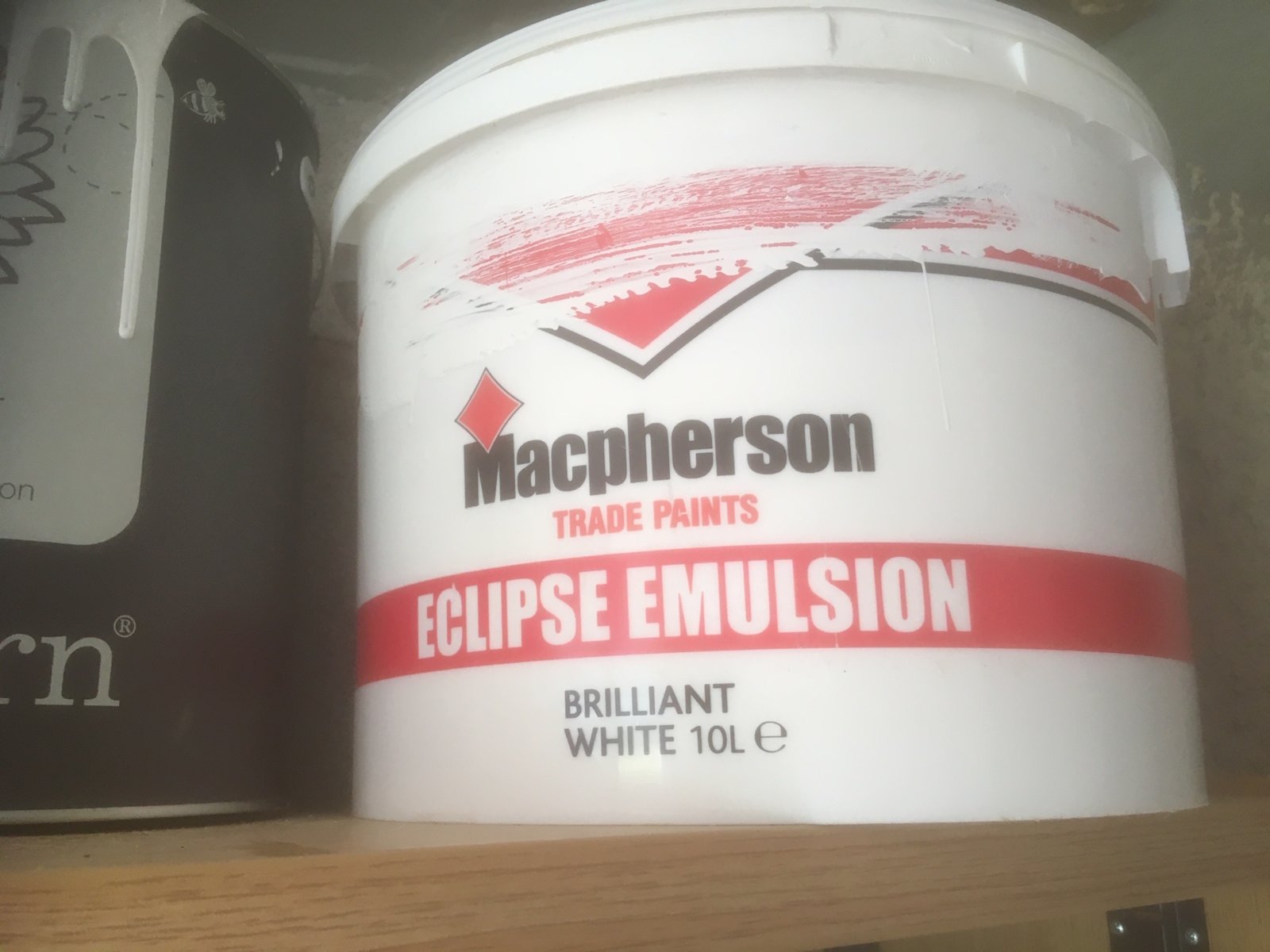

Coverstain is a good product. I think your emulsion is probably rubbish.
I once made the mistake of using Crown (not Crown Trade) white emulsion which was on special. I was repainting a client's rental property. After 4 coats I could still see the black scuff marks I was trying to cover. I binned the remaining 9 litres and purchased some Dulux trade matt emulsion which only required 2 coats.
Thanks guys. Ill take a photo of the paint Im using and see what you think. It probably is cheap rubbish.

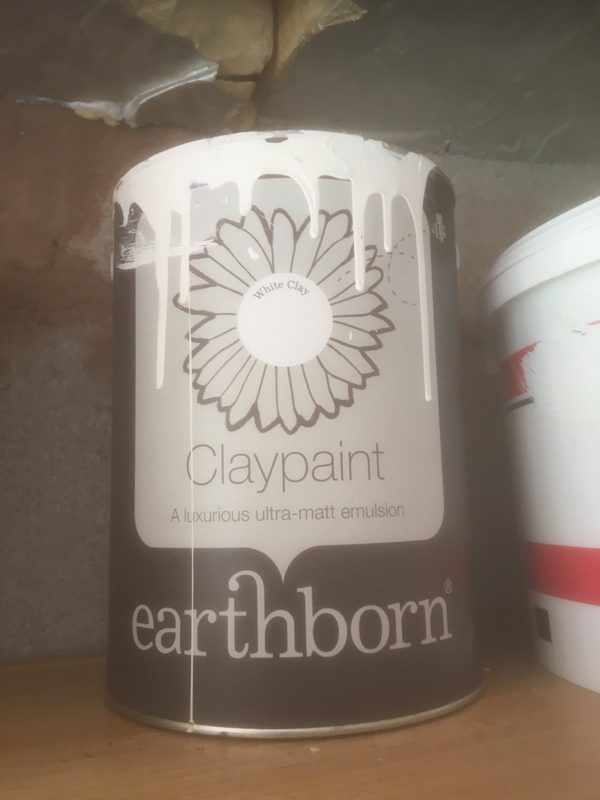

Ive just taken some photos. This is the white paint Im using to paint over the Cover Stain:

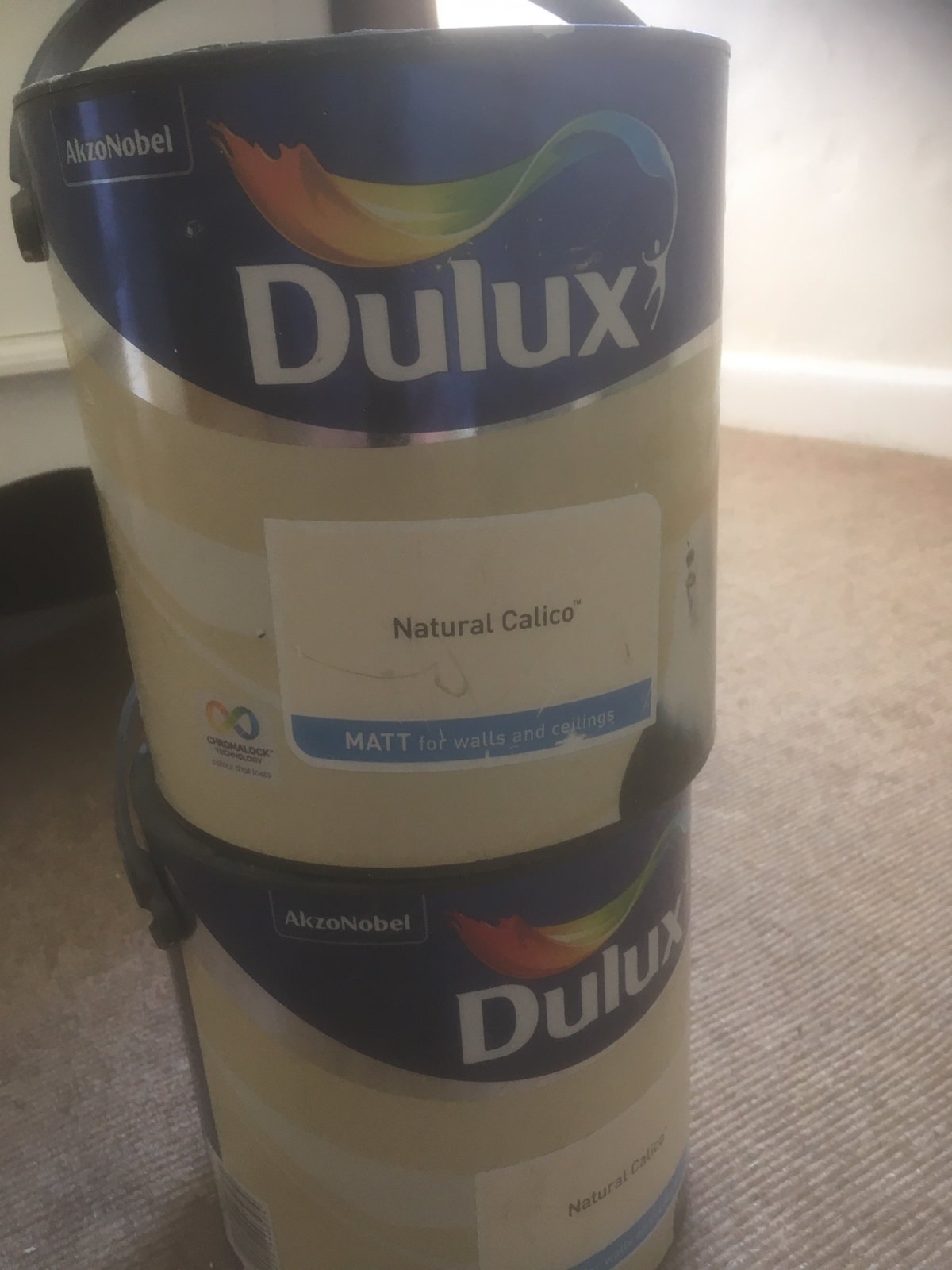

Ive got these tins if they would be better? (These are obviously not white, but perhaps I will just do that one wall)

Coverstain is oil based- water cannot penetrate through it if properly applied (assuming you stirred it first). If the walls were damp the coverstain would eventually blister. In the absence of blistering it is pretty safe to assume that the emulsion that you used is rubbish.
