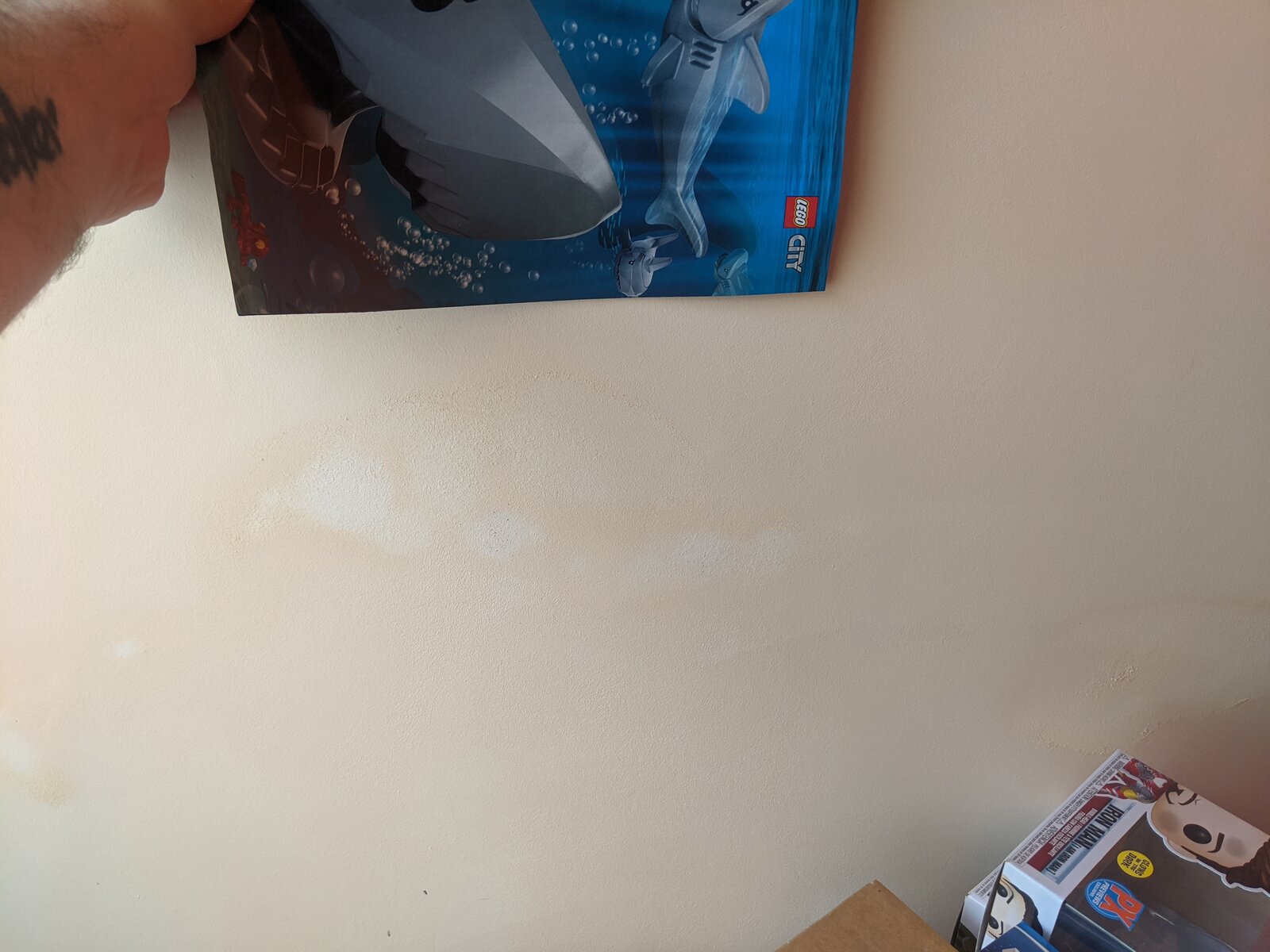

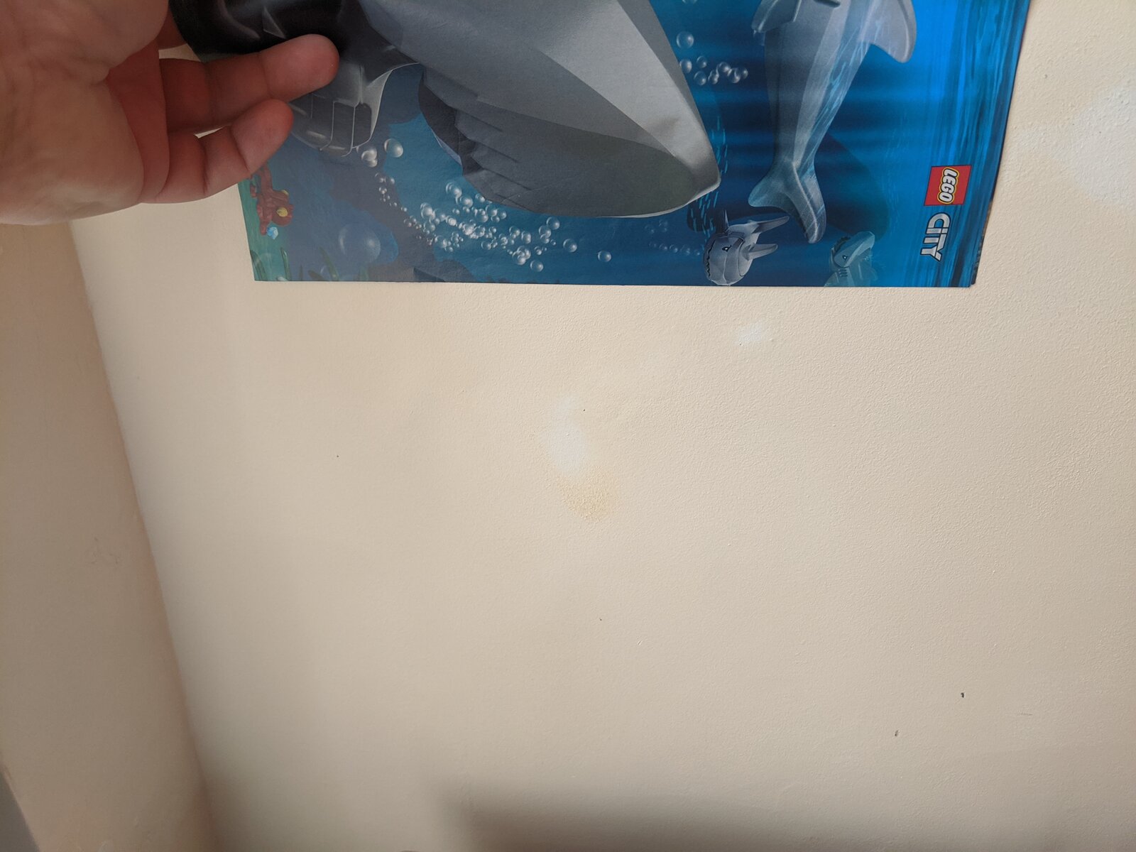

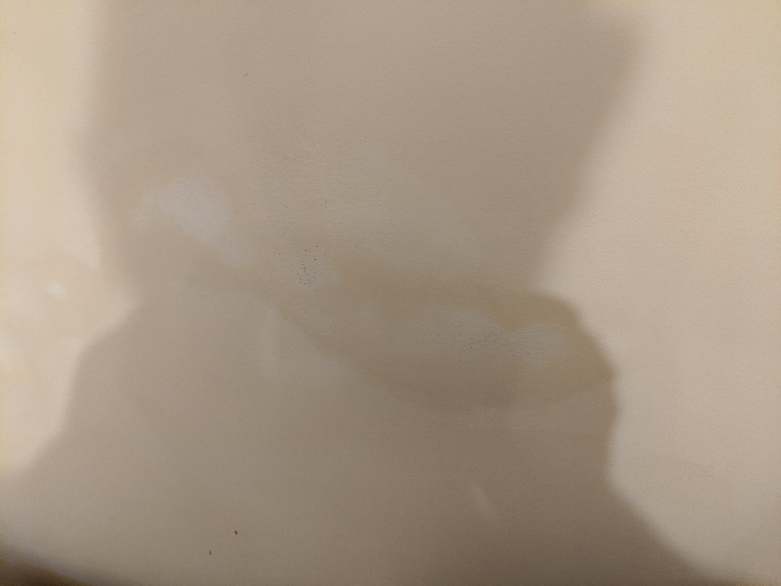

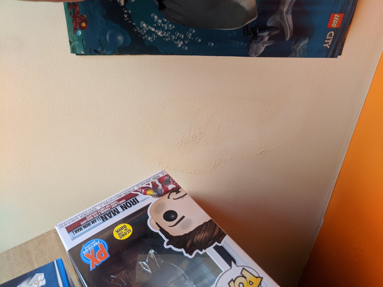

Evening all,

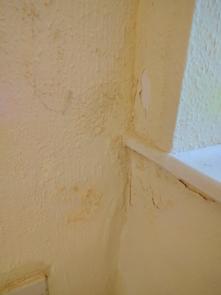

Got a bit of a conundrum with regards to a possible water stain half way up my dining room wall.
It's kind of always been there, albeit a lot smaller. Was never there when we first moved in years ago, appeared maybe 4/5 years after we moved in.
Of late though it seems to have got worse, as in bigger. I have attached a couple of pics but can do some in the daylight tomorrow if needed.

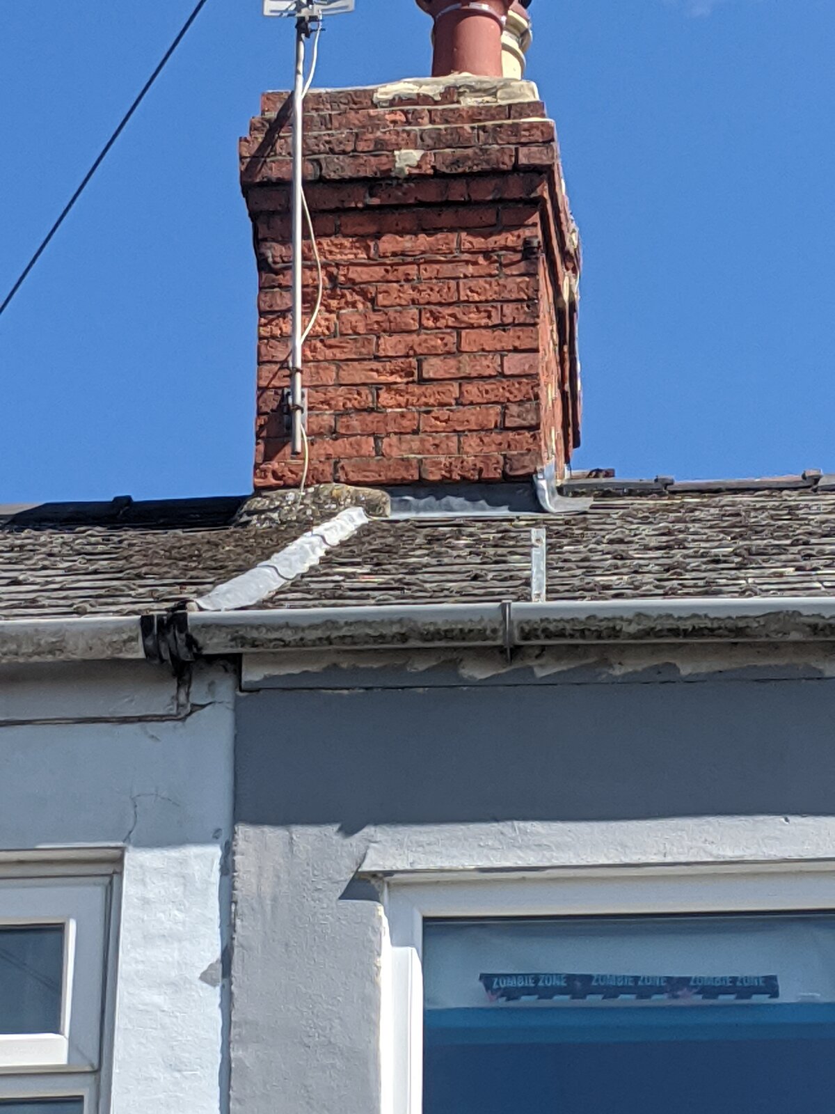

In a nutshell, the remedies I have tried are to get the chimney stack repointed and caps put on the 2 chimneys which aren't in use, in case water was coming down 1.
When there is a prolonged dry spell it pretty much goes and then appears in autumn/winter with the rain, and also the last few days since the sunny weather has stopped.
I would point out that this wall is an internal wall although it is close to the external wall.
I'm running out of ideas with regards to things it could be on my house, the flashing on the chimney stack looks good and being an internal wall there's no guttering or downpipes by it.

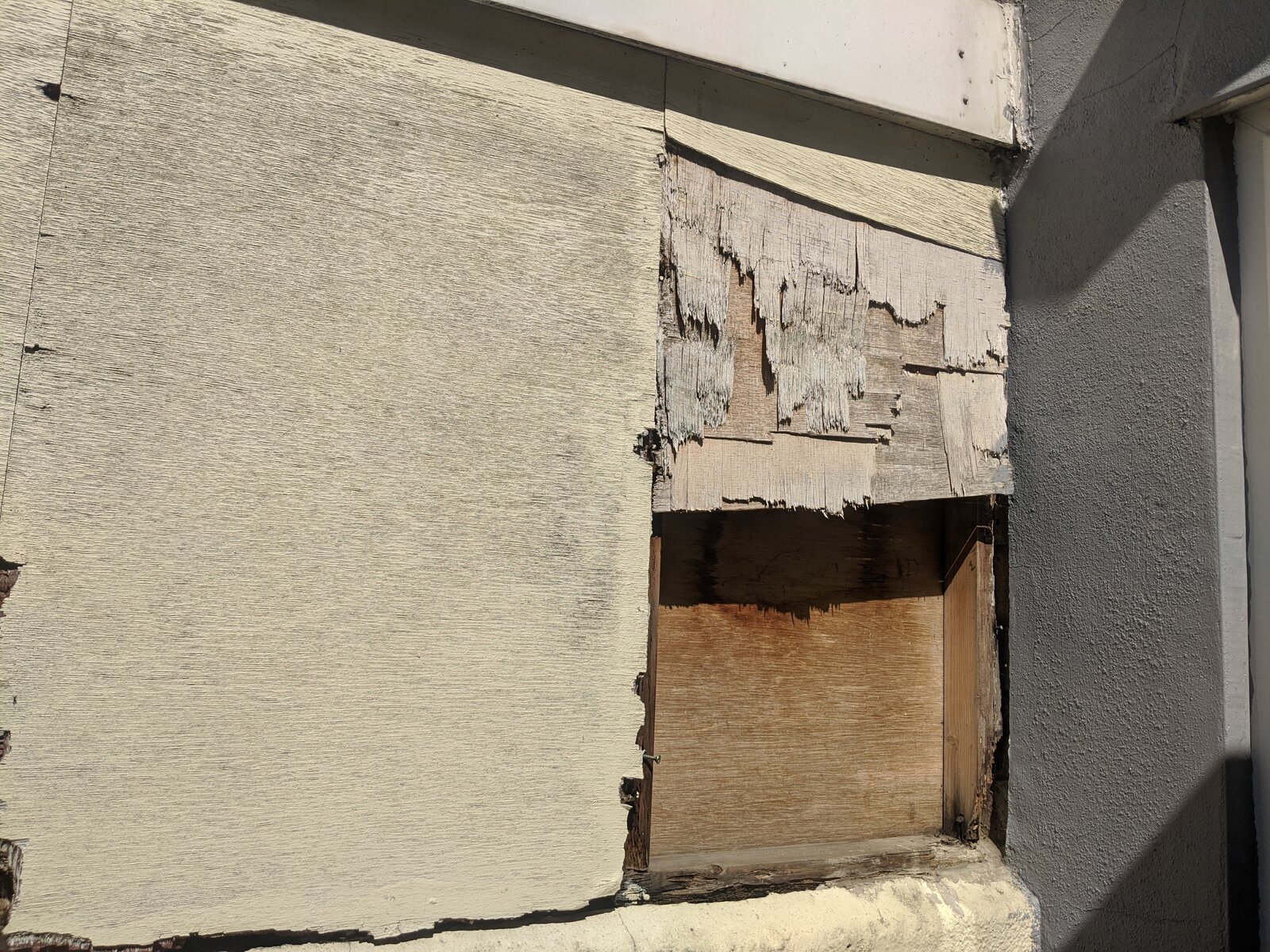

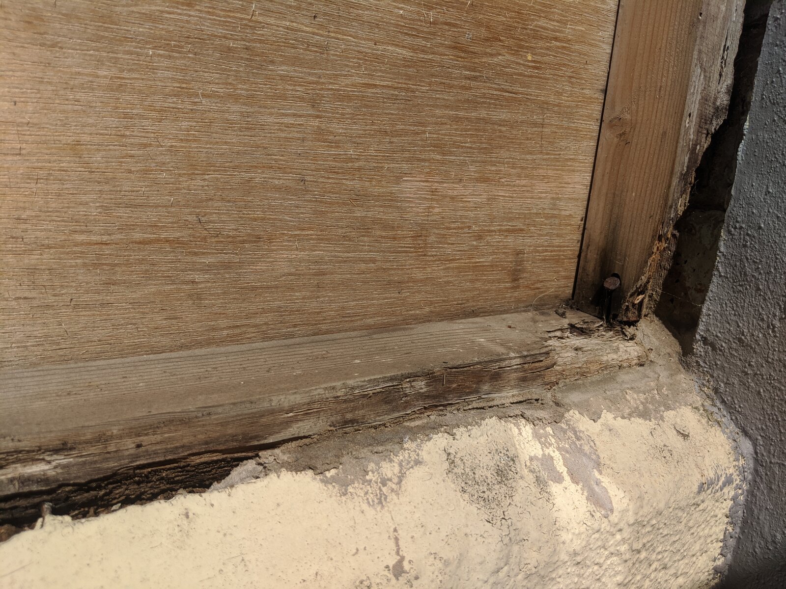

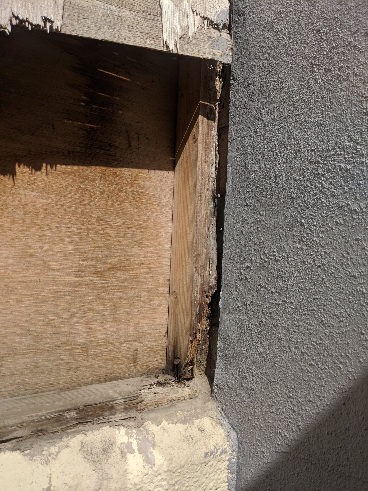

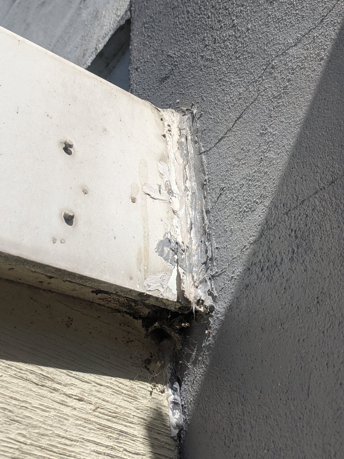

There is a lean to on the property next door which is pretty much falling apart due to whoever doing it using plywood which has now decayed. Secondly, the roof of said lean-to just butt's up to the house, no flashing as been chased in and the seal is going. The external render at the back of the house is failing badly with multiple large cracks, so my guess is that the water is ingressing around the lean-to or render and then working its way along.

Is the stain on a chimney breast? Is the chimney ventilated top and bottom? What, exactly, is on the other side of the wall
I can't make out your pics. Put something by the mark to show scale please. And no shadows.

Hi john,
the stain isn't on the chimney breast, other side of the wall is the neighbours room. The fireplace next to the wall where the stain is, is in use as i have a stove in there. There was an old opening in the bedroom above the dining room but that has been long sealed up, before we moved in and there is an air brick in the breast and also the chimney cap i had put on has a gap to allow air flow.
I can take some pics in the morning as the light isn't that bright in the dining room.

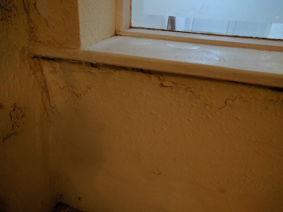

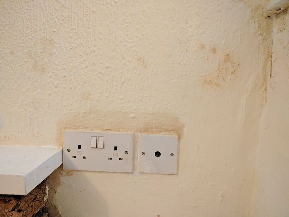

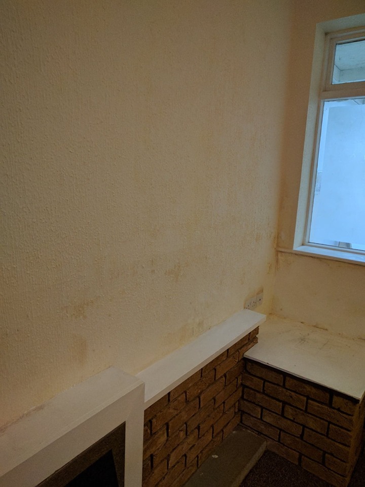

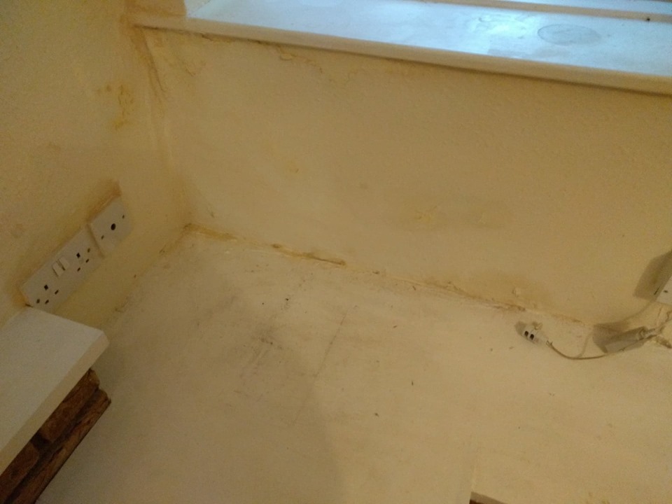

I've attached some pictures of the neighbours house, as the old tenants let us in to take some pics before they moved out. The wall where the sockets are is my wall, so you can see the extent of the issue next door. I might add that the new owner has since done some work, i think he removed the faux brick thing and other bits but got no idea if it sorted out the issue. the neighbours side was/is far worse than my side.

What is on the other side of the wall with the window, and the wallpaper falling off?
Is the floor concrete
Or wood, with a ventilated space beneath?
What is inside that box in the corner?
Is there a bathroom above?

Their floor is floorboards, mine is concrete. Other side of that window is the knackered lean to that i mention in the OP. God knows what was, if anything, inside the box thing and i believe it has now been removed. No bathrooms above, in either of our houses, as they are all downstairs.
I might add that I don't know if next doors floor is ventilated. I know there isn't an airbrick at the back of the house as it's has the lean to and extension on the back, and I don't recall seeing an airbrick at the front of the house but i can double check in the morning.

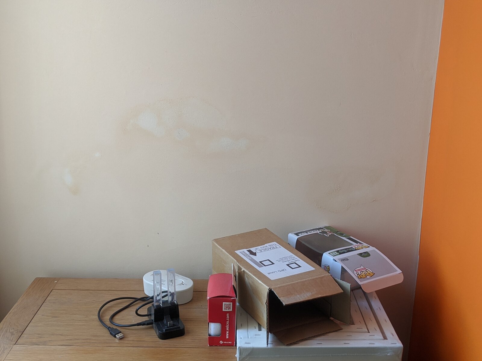

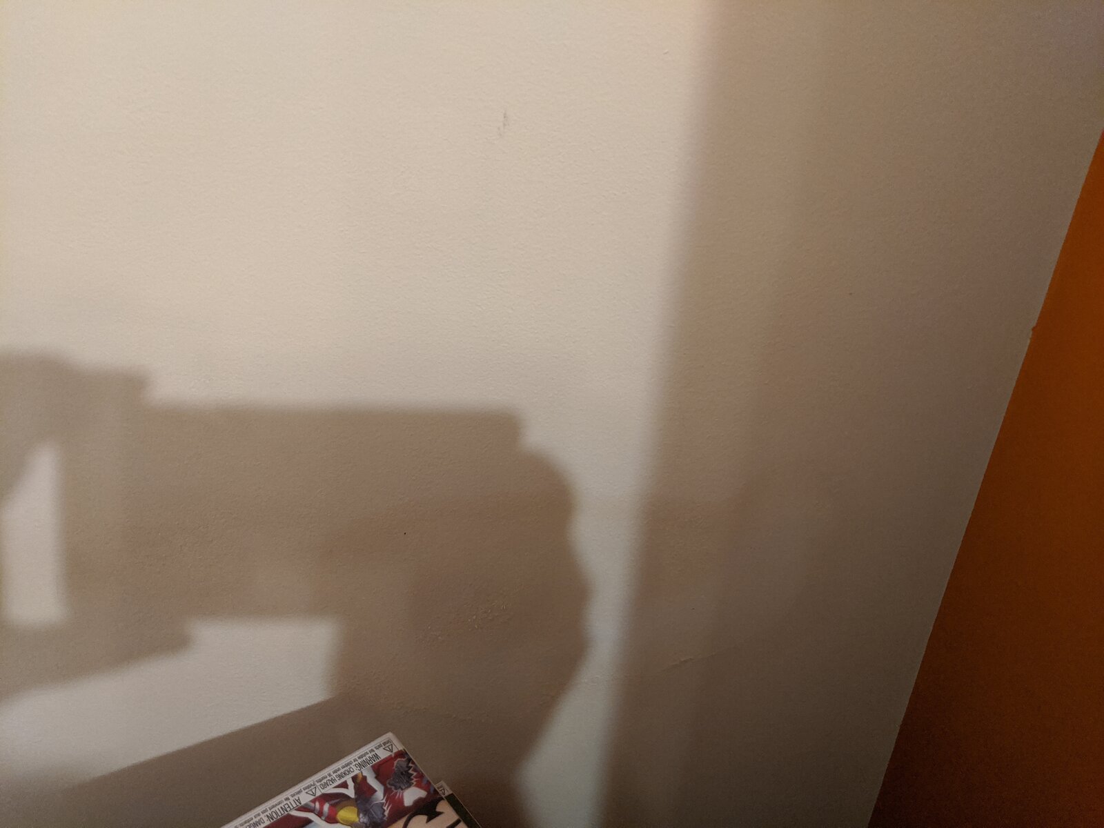

Few more pics as requested now it's light. Popped a piece of a4 by it for scale.
IMG_20200820_114000.jpg IMG_20200820_114007.jpg IMG_20200820_114015.jpg IMG_20200820_114047.jpg
the marks appear to be yellowish-brownish with a white centre. So not condensation, but water coming through the wall. I expect, with a decorators scraper, you can remove some of that paint that has been pushed off. You may find white crystals behind it.
Tape a piece of clear plastic tightly to the wall. you may find a mist or beads of water appear behind it. Do the same on your concrete floor (roll back the carpet for access and look for traces or damp, or plastic sheet round the edges of the concrete slab that might be visible at the skirting. Look for any damp marks on the floor.
The plaster on your wall looks quite smooth and may be relatively new. This is sometimes done to conceal a damp wall, which I suspect you have. Are you absolutely sure there was no old chimney that has been removed or blocked up?
Examine the wall in all lights and see if there is a horizontal line or difference in texture or colour at, say, 1 metre above floor level or therabouts where the plaster is slightly different.

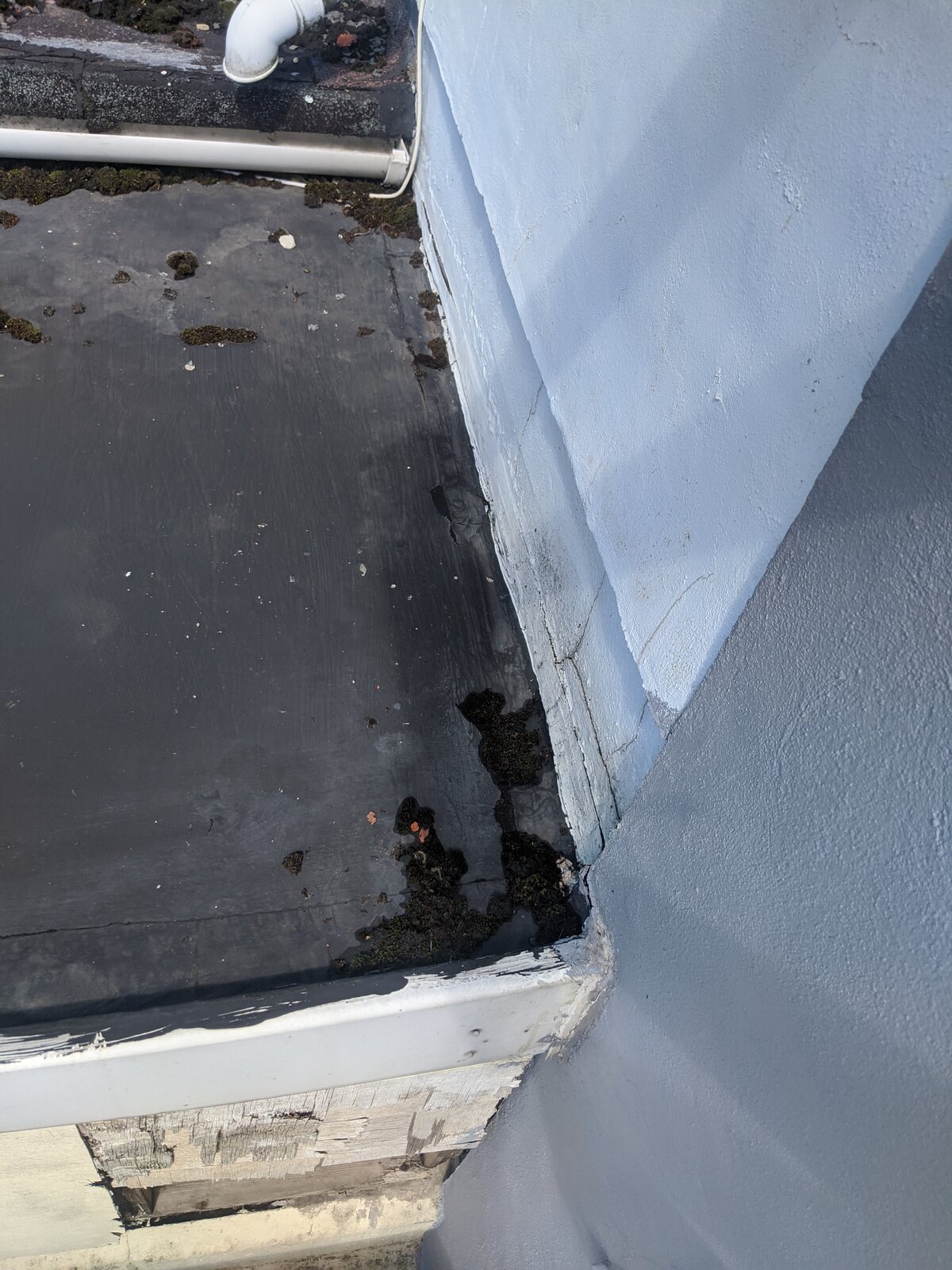

I would suspect a fault at roof level, could be your side or the neighbours. Damp around windows suggest they are badly fitted .External photos would be of more use than internal.

My prime suspect is the lean-to next door as the wall was fine when we moved it and seems to have gotten worse the more the lean-to has rotted. Will post some pics of the outside.

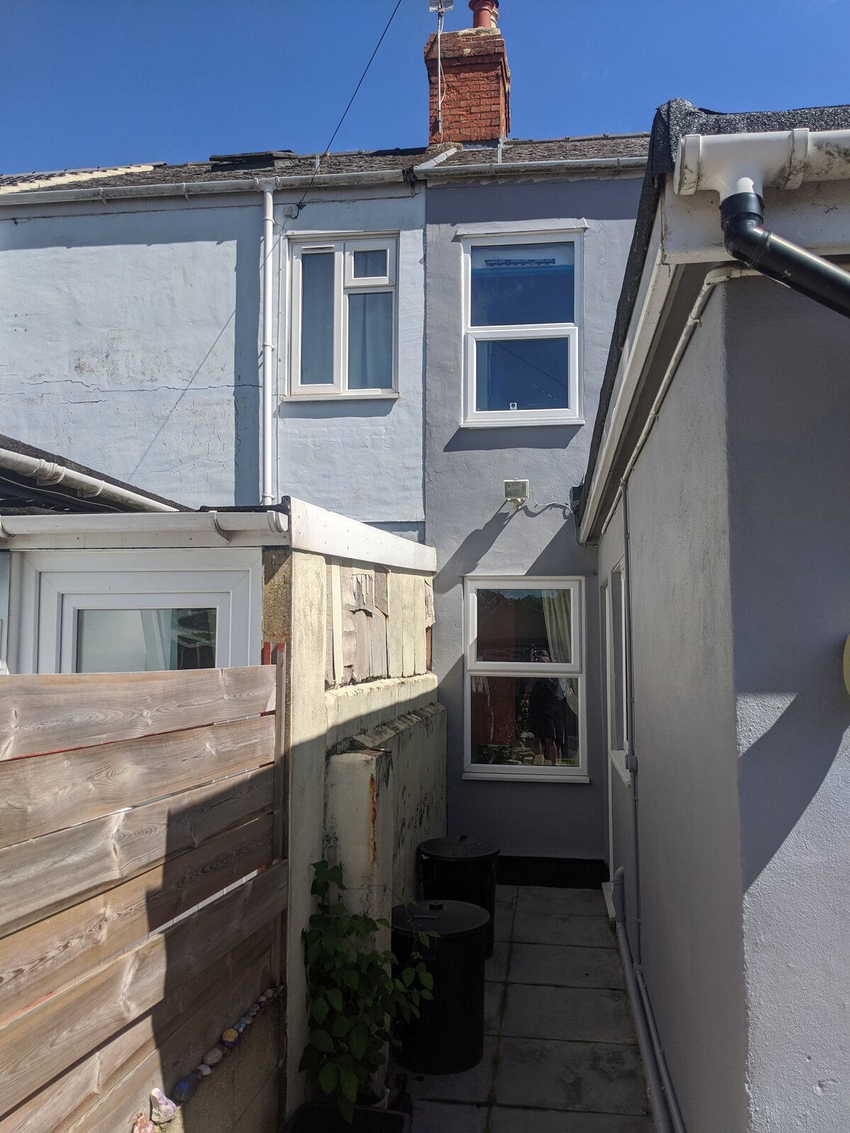

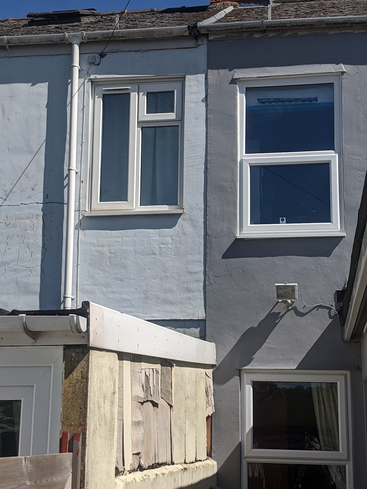

A few pictures from outside so you can see the state of the lean-to next door, as well as the room and chimney stack. Also took a picture of the room of said lean-to.
Where the wood has perished up by the house I've attempted to fill the channel/void at the bottom where it meets the wall with cement in case water was running down along there.
The back of my house is rendered so can't see the brickwork underneath, however where the external garden wall and lean-to meet the house it isn't rendered on his side.
