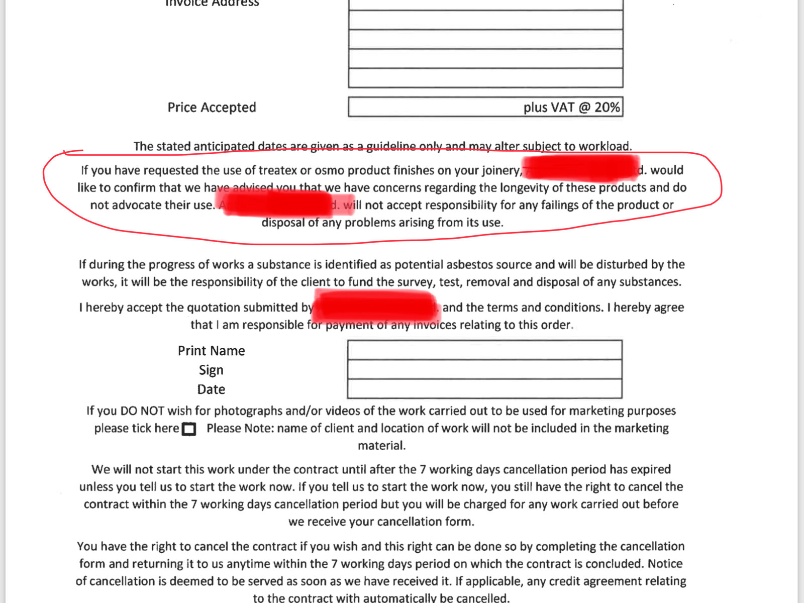

I recently had a quote from a builder who has stopped using Osmo products on joinery over concerns about its longevity...dont know if thats WT’s as well but worth a mention .
Interested to know what builder meant by 'longevity' and on what surface (floors, doors, worktops etc).
In part I would agree - owing to the thin layers that I apply I do have to re-apply to my floors and tables more often than I would with say varnish.
And it does scratch (to which I wipe on a bit more).
So perhaps I am missing something because of my 'patina' excuse.
