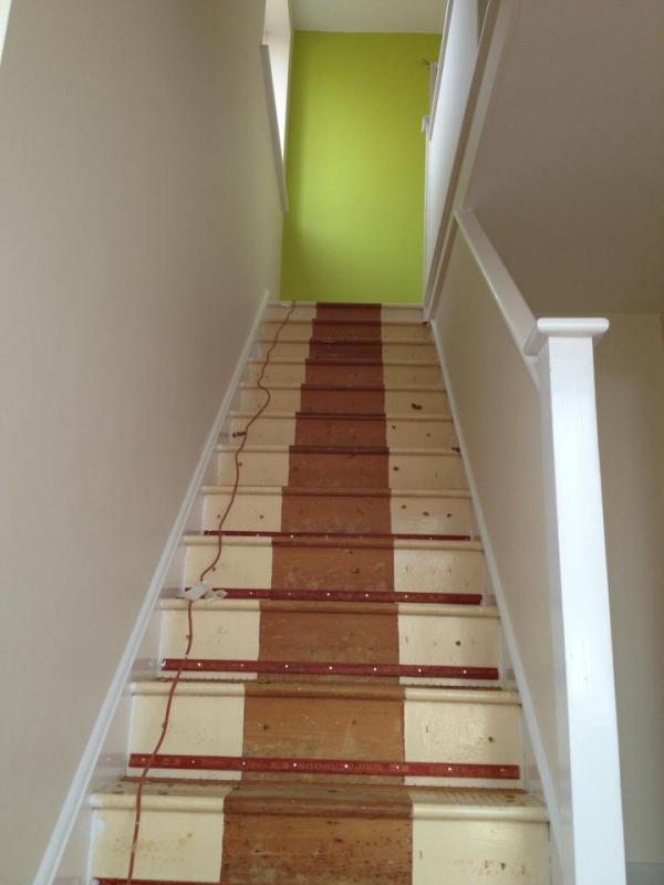

Hey,
Do they tend to be supported by whatever is below them, i.e. a wall, or are they self supporting?

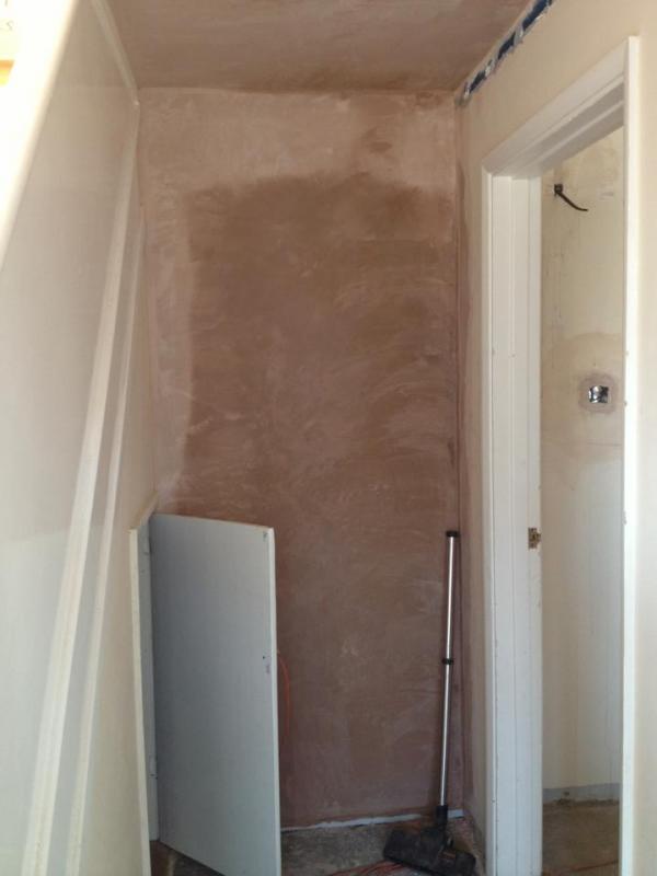

We want to move the door under our stairs over a bit (about 320mm) and make it taller so we can make some storage using kitchen wall units (310mm deep with doors).
Top of the stairs (showing nothing substantial above it):
Current door. Will be moved closer to the photographer. The space between the architrave on the door to the right and the back wall is 310mm funnily enough!
On a straight flight, the strings will be self-supporting. Think of the staircase as a ladder laid at an angle.
assuming there is a landing to the rh side off the stairs it may rely on that wall for support :?:
The tops of straight flights are usually supported off the trimmer in the thickness of the floor.
