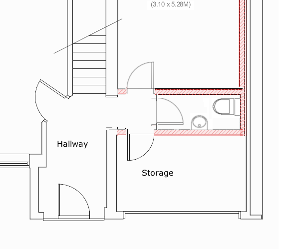

Hi guys,
Would someone in the know tell me if these two layouts would be allowed.
The first shows an open entry in the a downstairs loo. This opening would be very close to the bottom of the stairs.
The second is the stairs on the first floor. Was thinking of having a one step down landing so as you go up the stairs you end up on a landing with one step up to the left and one step up to the right into the new bedroom. With this layout do you then have to have another landing going into the bedroom on the right?
Or can it just be the width of the wall as shown.
Thanks in advanced for everyones help.
Sorry yeah an extension onto an existing house. Current stairs wind left at the top so trying to sort the best and neatest way to access a new bedroom on the right hand side over garage.

We've had this type of query numerous times and it boils down to the interpretation of what is the stair flight.
Some people seem to think the flight finished at the quarter landing so the 2 steps at the top are not part of the flight and do not need a landing.
Personally I take the view that the 2 steps and quarter landing are all part of the flight so the doorway into the extension would need a landing. That is just my preference as I think a doorway opening directly onto a step is really naff and bloody dangerous.

This design has brought the stairs forward towards the front door by 2 steps. Could move it the full 3 steps and completely unwind the winder but then it eats more into the hallway and a chunk of the box room upstairs as the head room needs rejigging.

If the stairs is existing it usually allowed no problems. But as you are changing the stairs they may be more strict. But if limited by space the BCO will usually allow it.
The door on the step is the worst part.
also consider the more you move that stairs forward the worse that bulkhead gets over the stairs.
