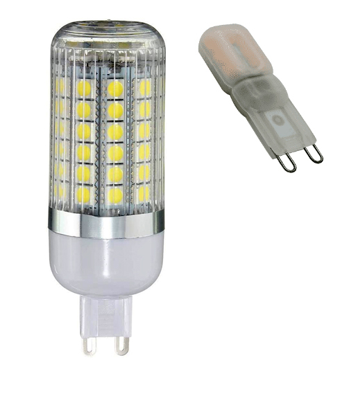

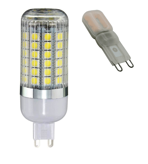

I had problems with G9 lamps, G9-comp.jpgthe small lamp would flicker and stay lit when electronic switch was off, the large one worked no problem, but one failed so I took it apart, the smoothing capacitor was nearly as big as the smaller lamp, I actually found a dry joint and corrected it, and put it back into use. The driver was also just a capacitor, but there was no wattage or lumen marked on the bulbs, or packaging, so technically illegal to sell in the UK, and also the covers which went over the halogen version would not fit. OK not required with LED as they were to catch the quartz should the explode so white hot bits don't fall on floor, but changes whole look of chandelier.

The one I got had 69 LED chips, think number G9-69SMD-5730 likely 10 watt and 850 lumen each, but depends on which web site you find them. Toolstation largest is 3.2 watt, Screwfix site similar, odd but screwfix still selling quartz halogen, 46 watt 702 lumen was their largest, still less than the 10 watt lamp I have shown at 850 lumen.
