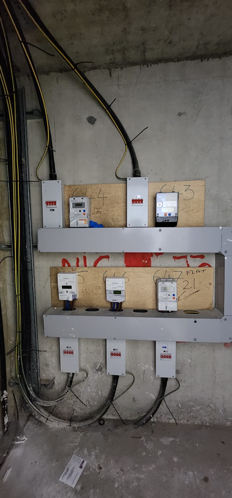

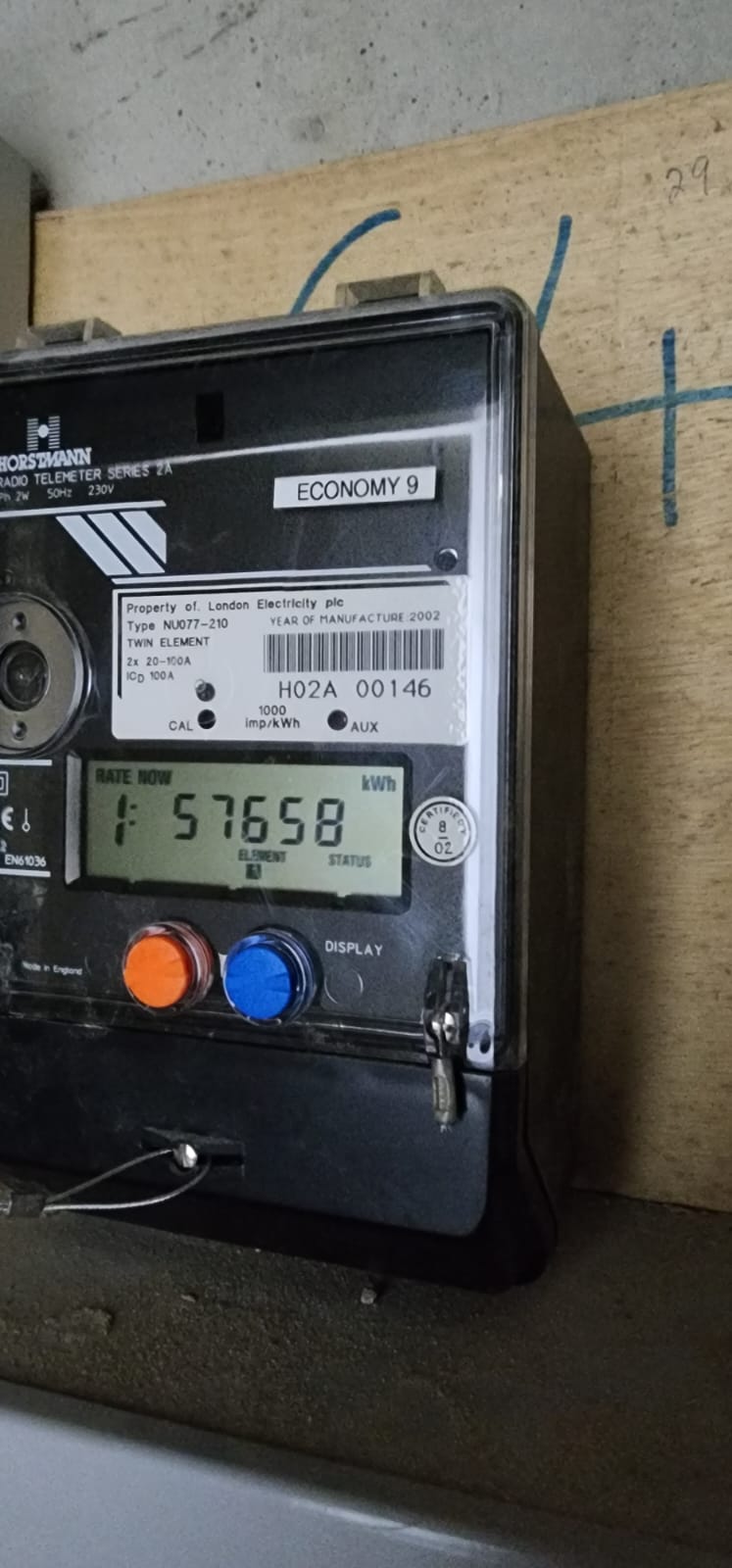

I moved to UK recently and my rented flat has Horstmann Radio Telemeter Series 2A electricity meter.
However, I have been asking both my electricity provider SSE and my Landlord on a query for which they are not having answers.
1. Does the meter consider all appliances usage during Off peak times or Is it only the storage heating appliances that are billed in off peak ?
(Attached image of the meter, It looks quite old model)

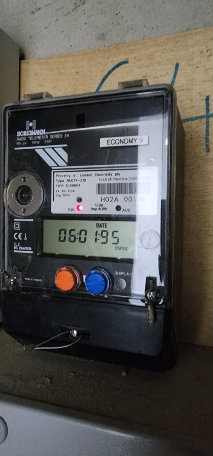

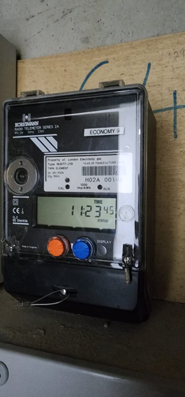

2. Also, the time shown in the meter is 1 hour ahead of my current time and the day is correct, but Year is 1995(it's similair to 2023, So shouldn't really matter). Does the time have any impact ?

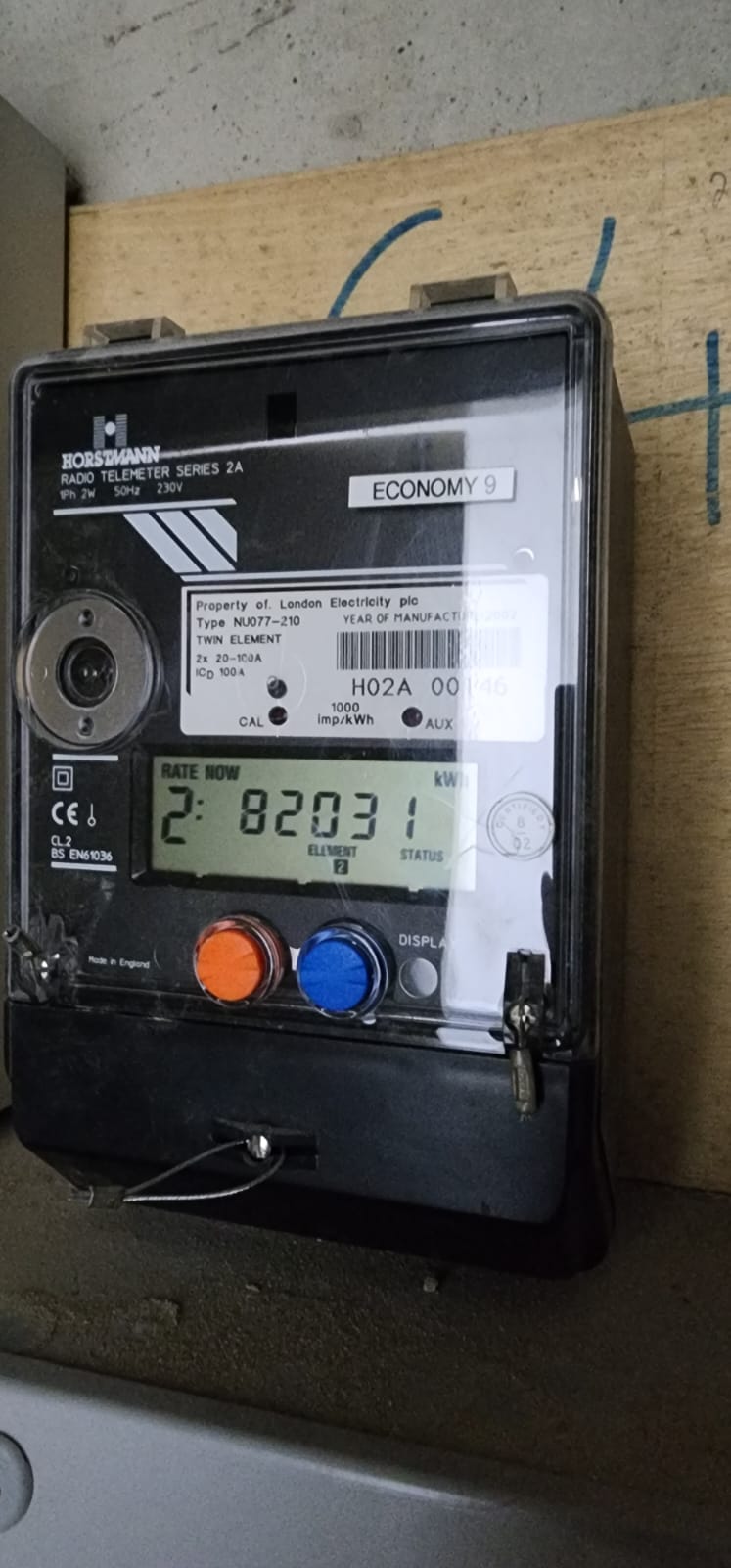

Observation: I tried measuring the consumption during my actual clock time(not meter displayed time) 1 PM to 3 PM last month, The electricty was getting consumed in both Readings 1 & Readings 2.
Reading 1 at 1 PM(actual clock time)- 57552
Reading 2 at 1 PM(actual clock time)- 81106
Reading 1 at 3 PM(actual clock time)- 57556
Reading 2 at 3 PM(actual clock time)- 81108
Note: The meter time was displayed an hour ahead
___________________
3. Does the meter show when off peak tariff is live ? I see status as 'D' in both rates 1 & 2.

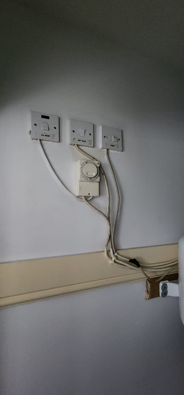

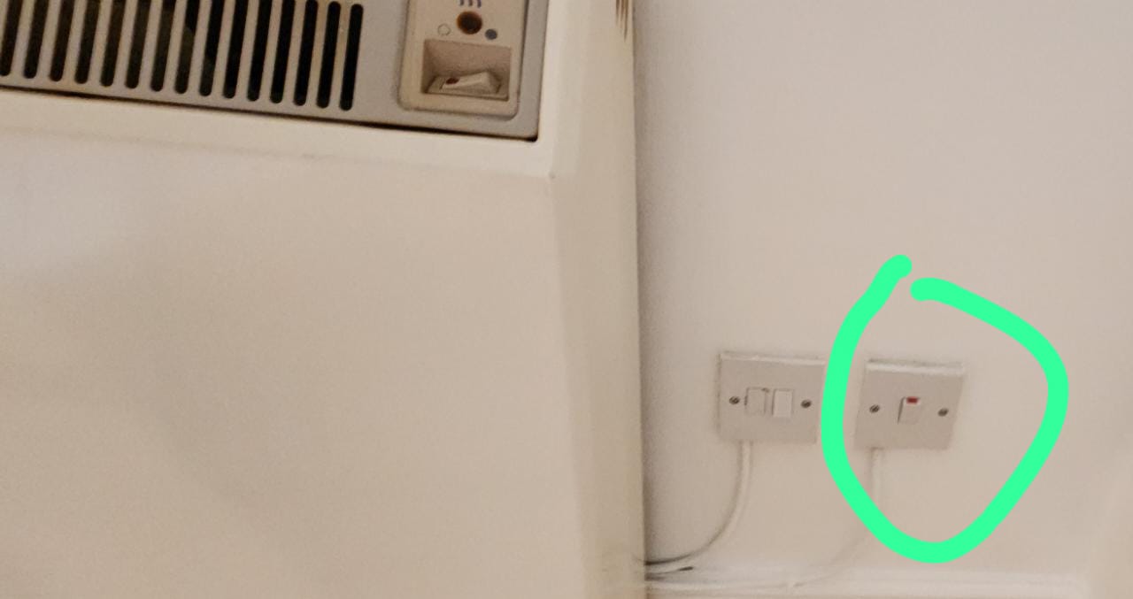

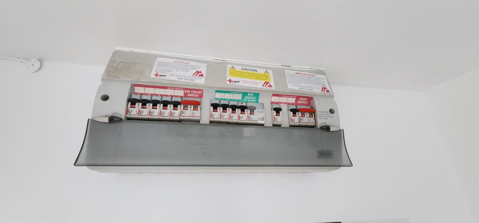

Attaching pictures of the circuits in the flat and the meter board.

Usually there are two consumer units. One is energised only when the cheaper electricity is available (Off Peak) and is for the storage heaters. The other is energised permanently (24 Hours) for normal use but will flick between the two tariffs according to the time.
That would be commensurate with your photo showing appliance isolators being marked 'Off Peak' and '24 Hours' However, you have only posted a photograph of one consumer unit. I assume that there is another one somewhere?
I don't think that the time being an hour wrong should matter as it's a Radio Telemeter, the tariff switching is done via radio signal. Maybe someone else could confirm for certain.
Why both readings were increasing during the off peak time is a mystery. However, you should be able to carry out a fairly simple check to test it.
1. When you get up in the morning turn off the storage heaters at their consumer unit so that they won't start to charge before you do the tests. About half an hour into an off peak tariff, turn everything off at both consumer units. [Between 12pm & 3pm would be good before it gets dark :) ] and note the readings of both tariffs. Then switch on only the storage heaters for 15 minutes. Again note the readings. Only the off peak reading should have increased.
2. Now switch off all the storage heaters at their consumer unit and switch on something that uses a fair rate of energy, such as an electric hob, or oven for 15 minutes and then take the readings. Again only the off peak tariff should have increased.
If you find that the standard rate tariff has increased, during either of the above, then you will likely have to get someone in to inspect the installation to find out why.
Sorry I don't know the intricacies of your meter, but often usually there is a display for tariff 1, tariff 2 and a total (1+2)

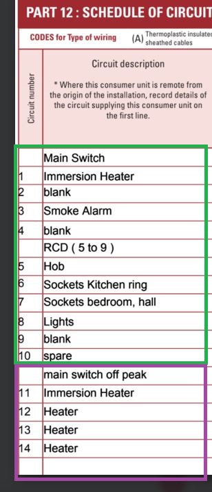

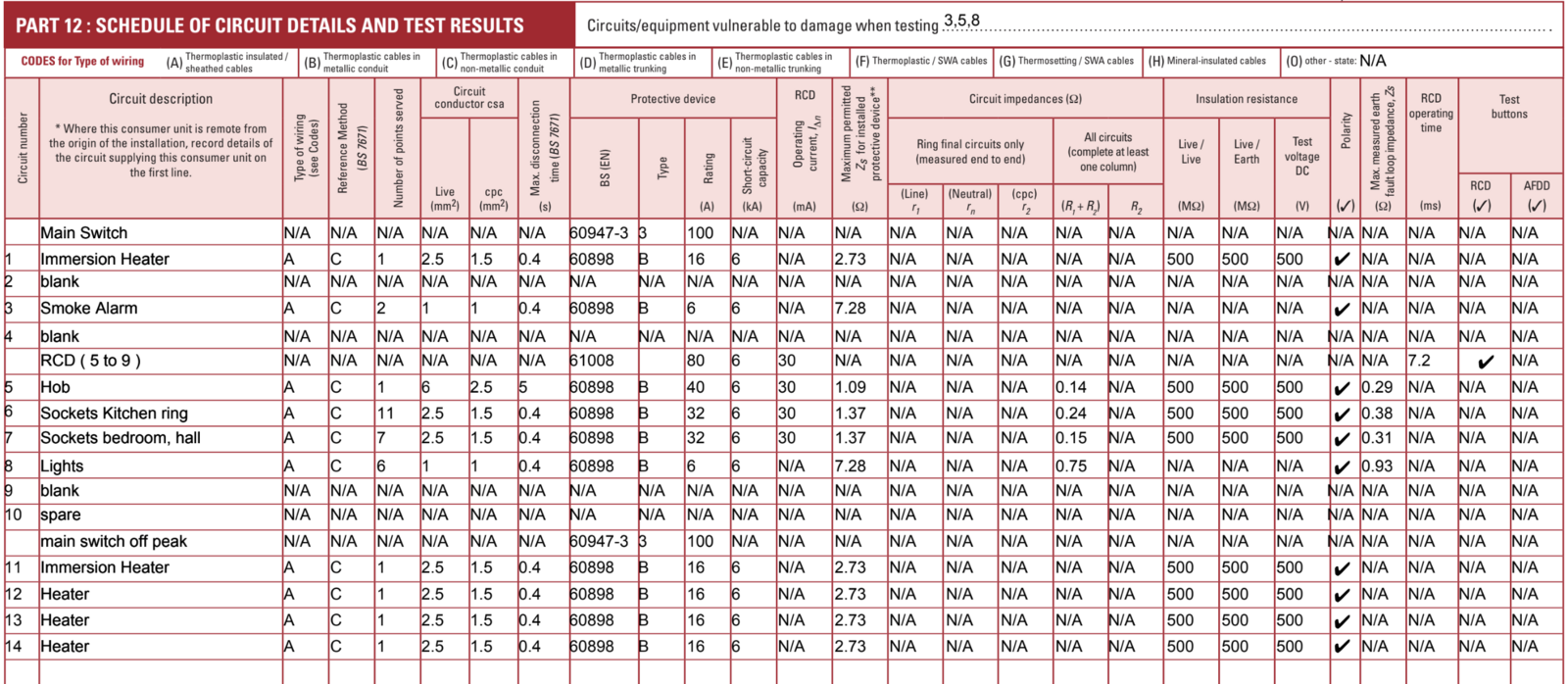

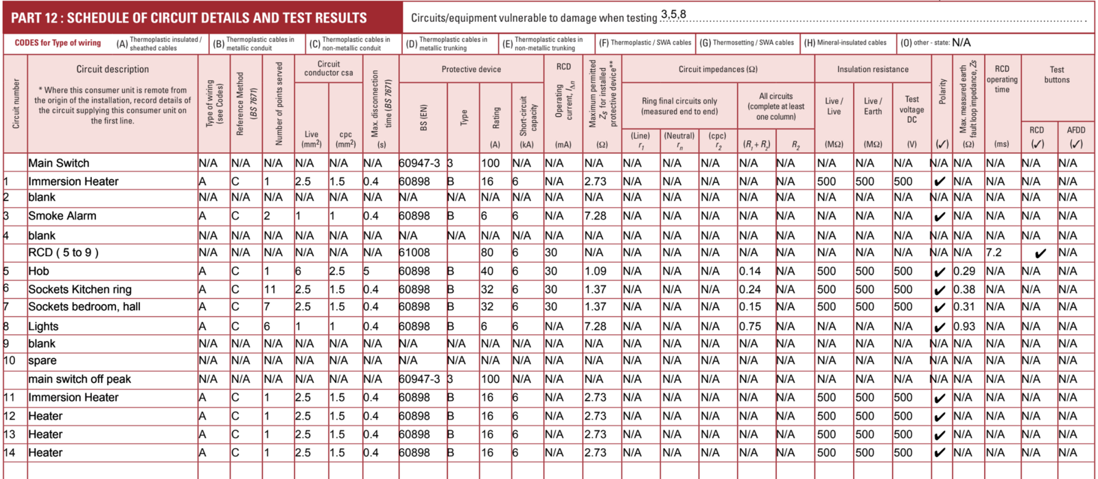

Thank you Stern, So, to give further details, this is a 1 bedroom flat, and I searched everywhere and could only find 1 consumer unit. I am now attaching a screenshot from the electrical installation condition report. Please tell me if this makes any sense ?
The two systems are shown. 24 Hrs in the green box and off peak in the purple box.
So it might be a split consumer unit with two separate supplies to it from the meter. I can't read the labels on the photo of the consumer unit you provided, but the off peak is probably the bank of MCB's to the far left. Although there appear to be 5 MCB's but only 4 are listed on the report. [11 to 14]
If it is a radio switch the actual timings can be very different - all you can guarantee is that you will get the number of hours. But equally so it could easily be a "smart" meter. The timings should be in GMT rather than BST.

The off peak electric supply started in this country around the 80's, original was Economy 7, which had two meters, the white one was off peak, and two independent consumer units, and had a teleswitch linked to radio 4 time signal.
As time went on people wanted to take advantage of off peak for washing machines etc, so the method of switching changed, and often a trigger wire was used to activate the storage radiators, and they all came from same supply.
However as @stem has shown your EICR seems to show you are still on the old split system although using a split consumer unit rather than two independent consumer units.

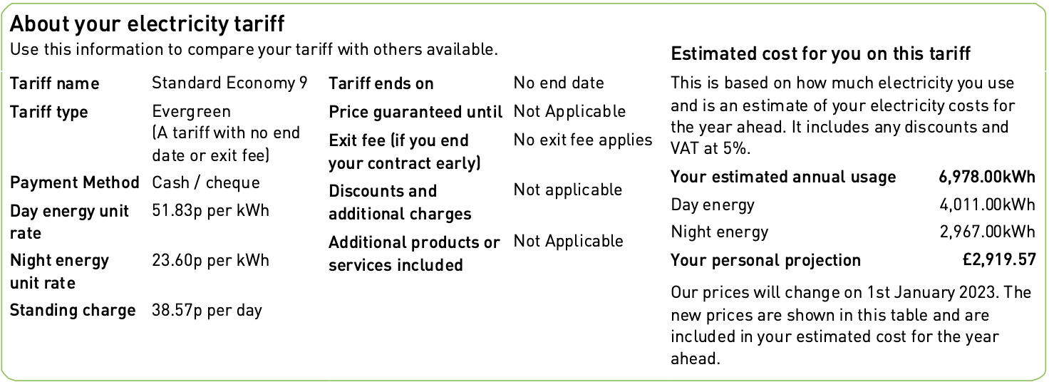

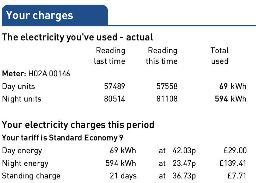

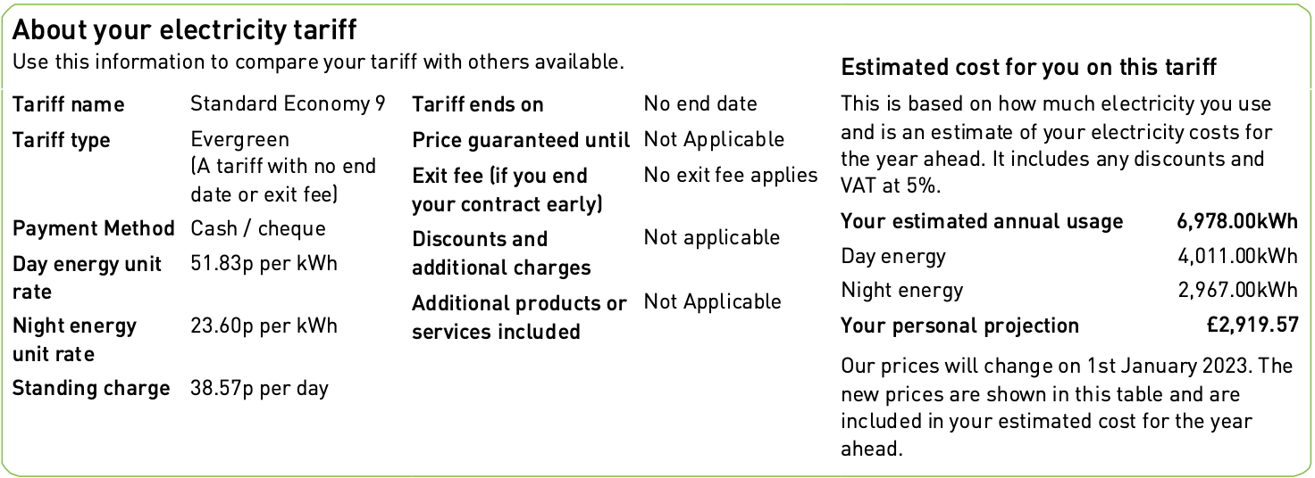

Thanks for the details, This is a snipet of my last month bill showing the tariff. This is being increased to 51.83 GBP/KWH effective this month.
