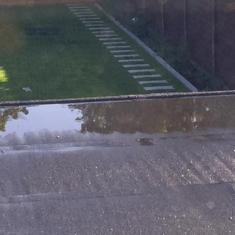

I recently had a 6m extension built with a flat roof which has a hidden drain (gully within the roof). Without going into details the builder totally messed it up and now I have standing water on the roof when it rains near the edge of the gully.
It does eventually drain off but takes a long time and I'm concerned that this will start causing leaks in the future.
What can I do to fix this without redoing the roof? Someone suggested spreading stones (6mm limestone chippings) across the whole surface which should help disperse the water. Any ideas?

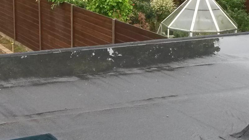

OK attached some pics I had on my phone. Looks like the gully edge was refelted at some point which has caused a lip preventing the water from flowing down.
Roof size is approx 50m2 but we have 2 big skylights so felted area is approx 45m2.
One gully which flows to a down pipe on the front of the extension.
I think the ponding evaporates and does not drain off.

I assume that the gulley is a square gulley roughly centred in pic 2?
Given all the above details then i think that you are going to have to live with it.
Maybe others, more experienced than me, can come up with a solution?
No experienced flat roofer would have built that roof that way - but you probably already know this.
FWIW: in modern residential flat roofing design, you never if possible design in chutes or internal drainage gullies - you most always fall the whole roof to guttering.

A little standing water at the verge is common and will do no harm.
