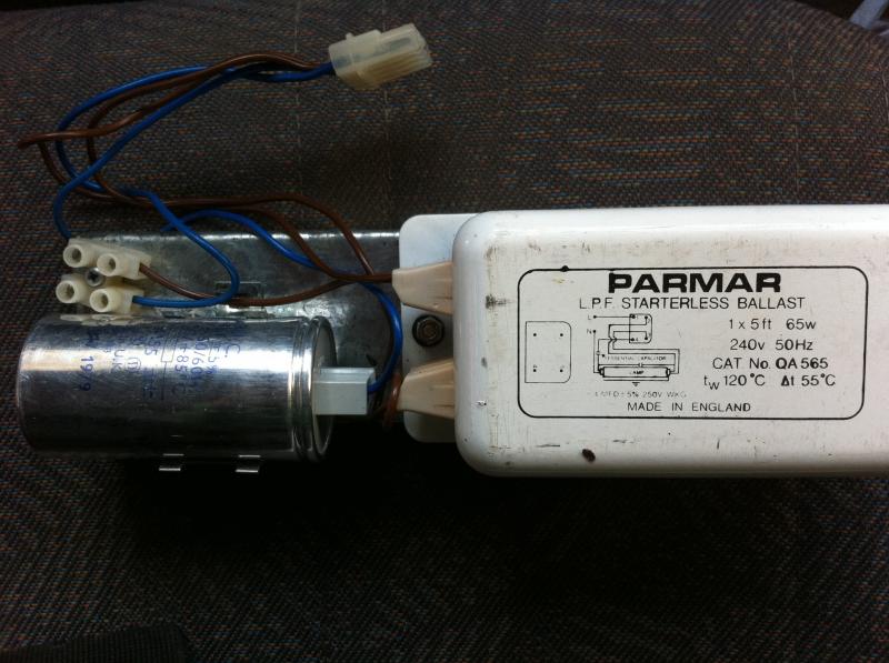

I am looking for a replacement for this:

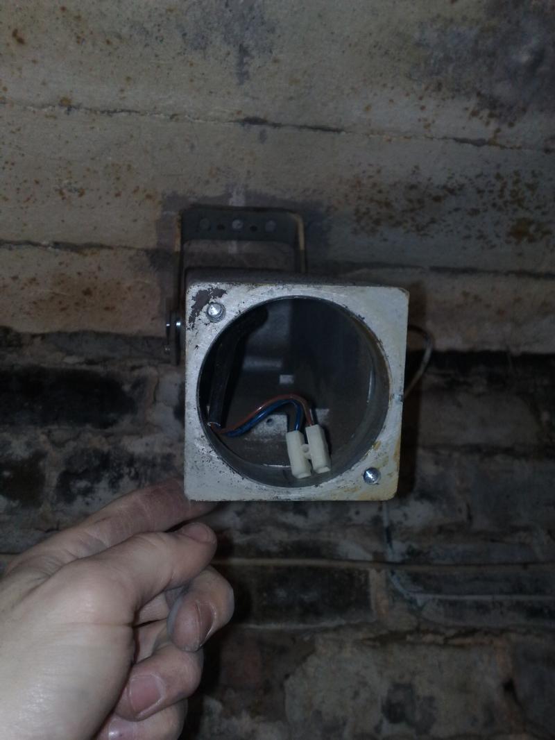

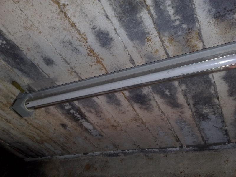

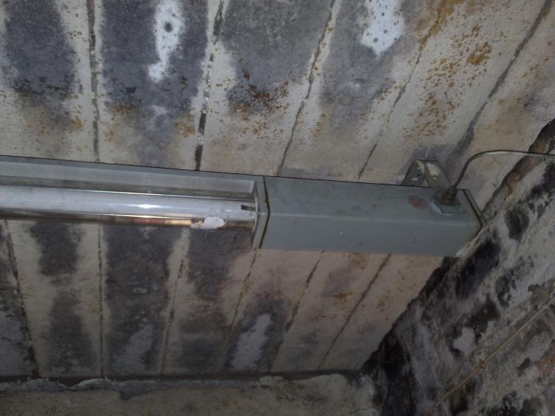

It is in a fitting (5ft) which is located in a room which stores (among other things) highly flammable liquids. There is ventilation to stop a build-up of explosive gases and these two fluorescent light fittings with a heavy duty sealed construction - the lamp is inside a clear tube and this ballast goes in a cylinder-shaped void accessible only when the fitting is disassembled.
For obvious reasons I don't want to use a ballast with a sparking choke. The only electronic starters I can find are too long. Max size it can take is diameter 81mm and 235mm long.
Alternatively anyone got a link to a suitable replacement fitting?

This one is 234mm length, which is 1mm shorter than the space you have, so should fit (but with no space).
However both ends have a mounting bracket which could be cut down to make the length 220mm or less, so that should fit easily.
Other dimensions 40x28, so no problem to fit inside an 81mm diameter tube.
Link to full specifications on the same page.
Well found, cheers. Have ordered one and will try it and see

Thats probably it :oops: It has a 58w T12. They have a stock of them and said that was what came out of it, but I should have checked with the other one. doh!
Bernard, they are now obsolete and there is no equivalent replacement according to Parmar
No such thing,
It is either
58watt T8 which is one inch diameter, or 8 eights of an inch
or
65watt T12 which is one inch and half diameter, or 12 eights of an inch, which i would try.
Turned out it was a 65w T12 after all, guess I should have made more notes when I was there the first time. Changed the ballast for the electronic one flameport linked to (thanks again) and the tube to a T8 58w and all's well.
