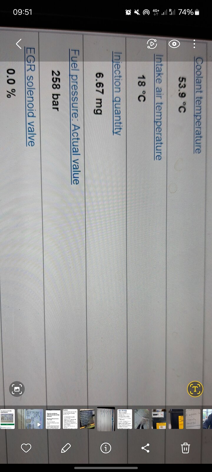

AA said no faults recorded but on one screen he said egr looks wrong. I have a photo, it says 0%. Car was idling at the time. Going through old service records, 3 years ago during a service it says Advise = Scanned engine and fault found on EGR sensor
On most cars the EGR is at 0% under idle. Show us the picture.
