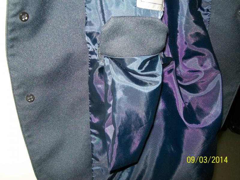

I sometimes receive static shocks, if I an wearing satin-lined garments against my skin in dry weather, and touch say, a stainless steel switch faceplate..:D:D:D
They don't make things like they used to, i.e. Wylex Standard Range Dual Screw connections, solid engineering. Same goes for the first generation MK din-rail system boards - they were really well built, with really thick plastic casings, not the thin plastic of modern ones.
Even the satin lined pocket in the ten year old jacket, was engineered out a single strip of satin fabric, without any seams, so that it could support the weight of a bulky Nokia 3210 mobile banging around inside it all day. Modern garnents have seams in the pocket linings, which tend to rip under the weight of an Iphone rubbing against them all day - a seam in satin fabric is pretty delicate by nature, when you got the weight of an Iphone on it, it will probably only last a couple of months before needing stitching up again, as the original stitching would have decayed!!:D:D:D

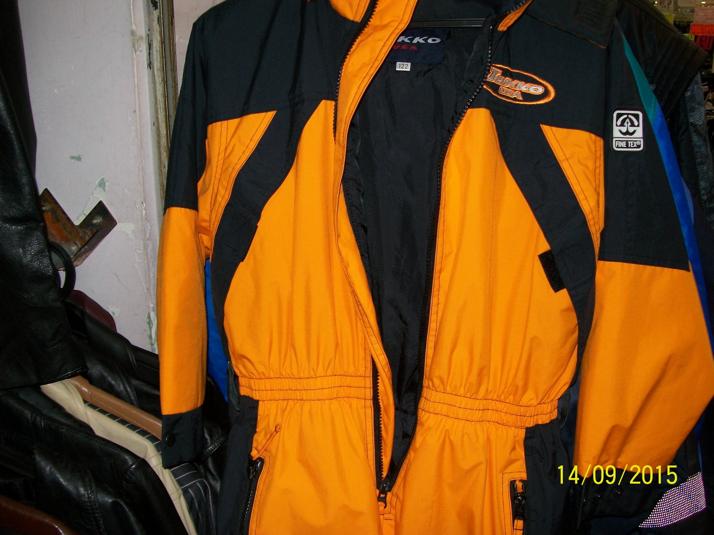

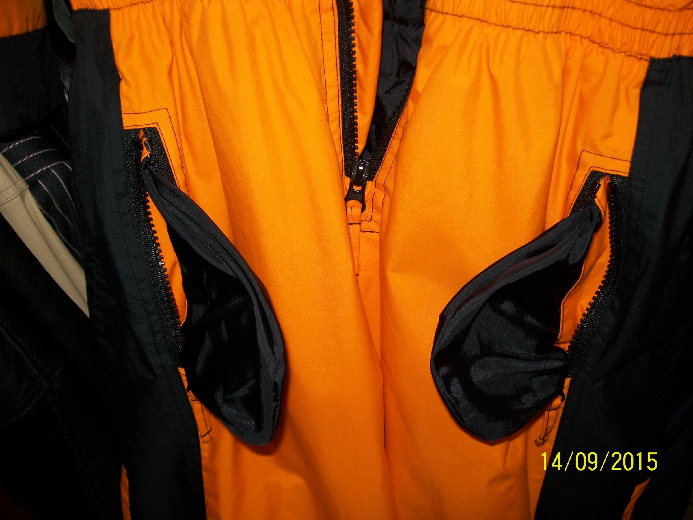

Here is a close up of the skisuit pocket linings - both lined with delicate soft satin - sure must bring a lot of static shocks if the hands are in there a long time!
I am surprised that both the delicate pocket linings are still appreciably intact, in a garment that is around thirty years old, usually the pocket linings will have long since disintegrated from the effects of coins, hands being inserted, perspiration bacteria, sharp fingernails and keys etc. They sure don't make things like they used to make them!
