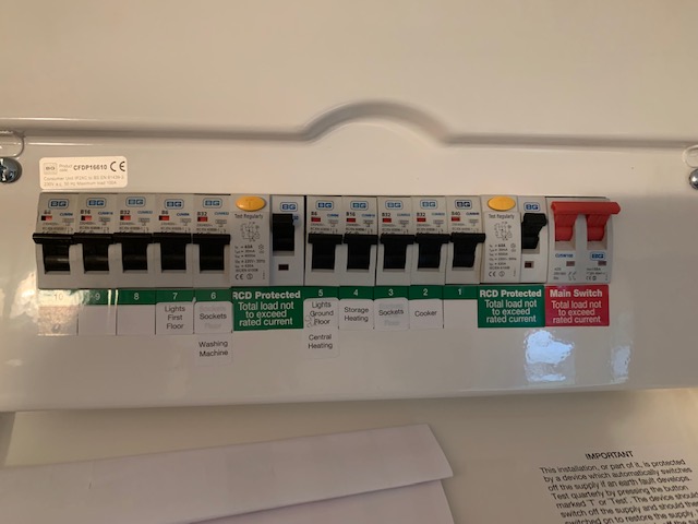

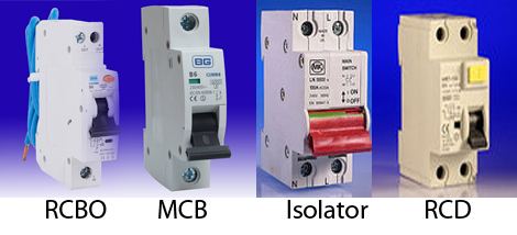

I have all RCBO's so in my case the trip only feeds cooker, but I had assumed it was a RCD tripping, and most people one RCD feeds many circuits. If the MCB is tripping then more serious.
So what is tripping
a RCBO has a test button as does a RCD the MCB has no test button, and isolator normally red lever.
Thanks for the reply.
Picture of the consumer unit attached. The first black switch on the right, immediately to the left of the two red main switches, trips.

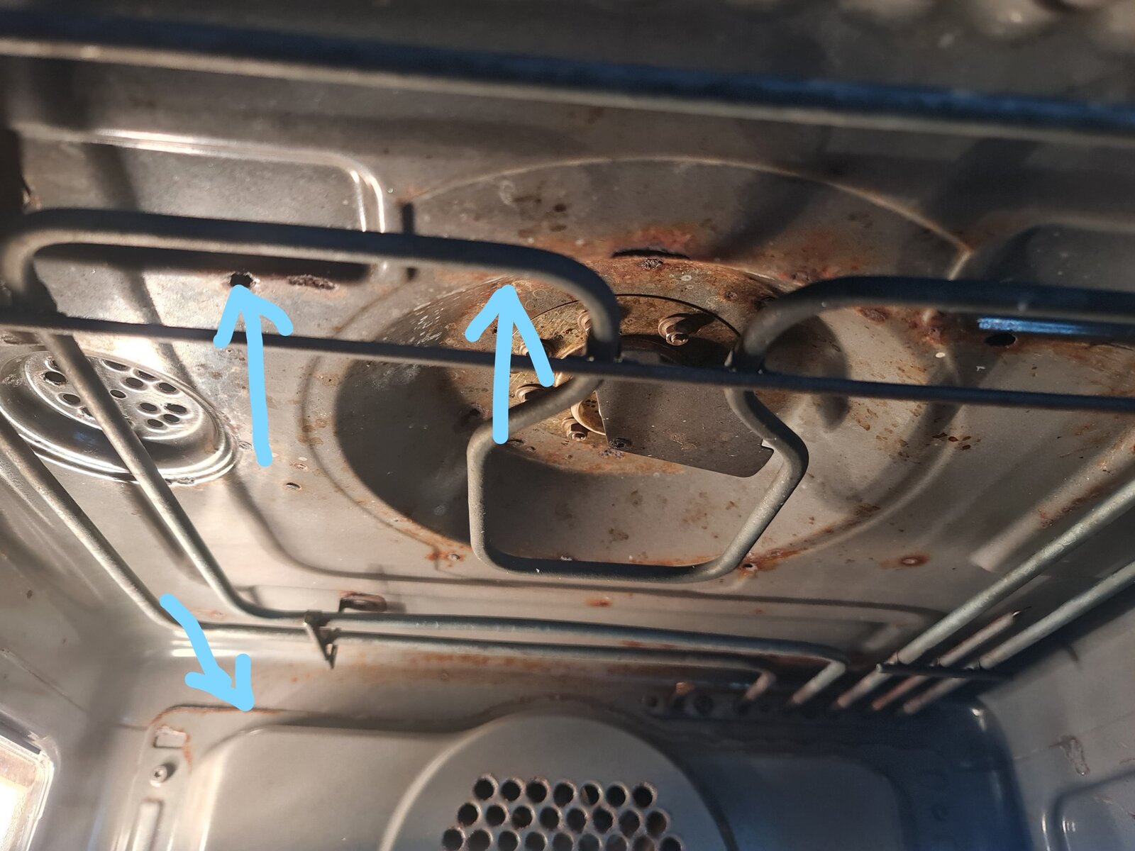

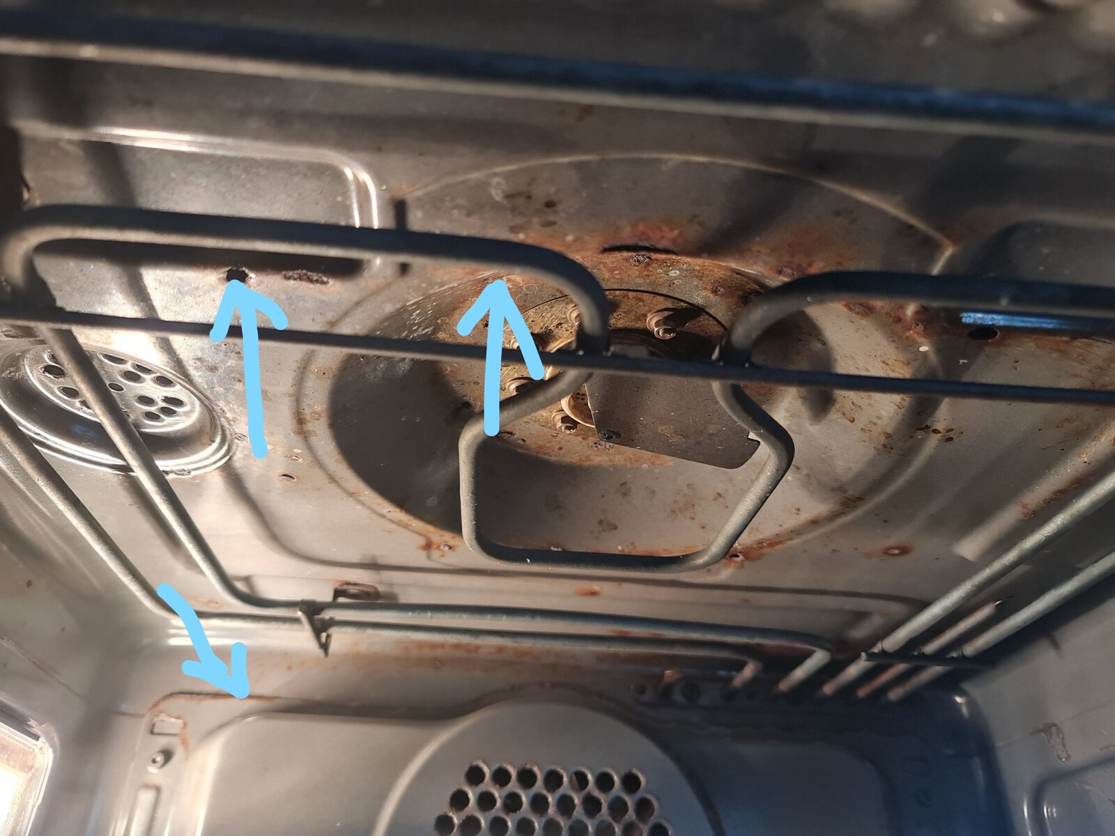

Have you looked in the oven at the top plate (read: lid)?
My mum's £1300 microwave combi oven needs to be replaced because of rust.
In her case, and not yours, the installation instructions do say that an air vent in the pinth should be fitted to allow the air to flow up and out of the top of the oven. Her's is about 8 years old as well.
I am a tad confused though. When you say it trips after two hours, do you mean that the oven will trip when turned on and empty? At a guess the oven has three heating elements, the one in the base, the grill on at the top and the circular fan at the back. You could always remove the wires to one of each and see what happens?
