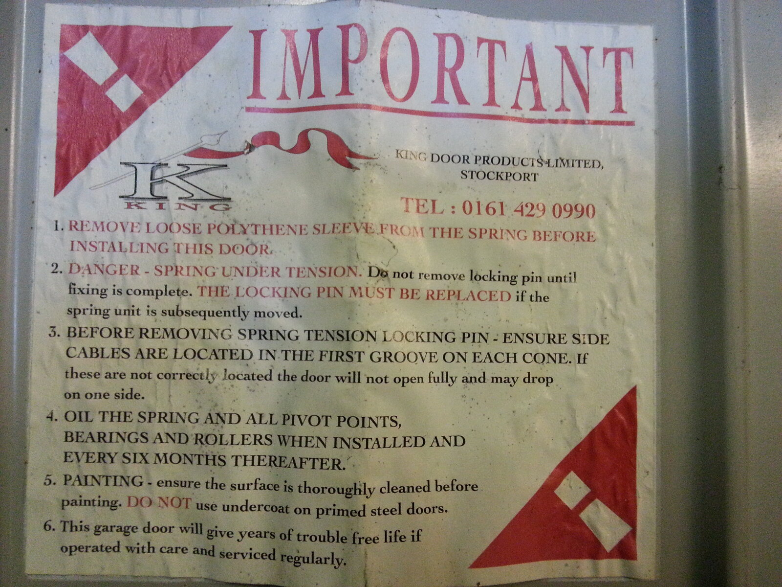

1995 vintage up and over. I've rubbed down the outside, down to bare metal in a few small areas. I assume I've therefore gone through the galvanised coating and wonder what to apply to these.
I have Fertan and Bilt Hamber Hydrate 80, but don't these need some actual rust to work on? Having said that the BH says it can be applied to non-rusted bare metal. I haven't seen any rust on the entire door.
I have some exterior "smooth metal paint" from Screwfix so was going to try that as a first coat and see whether the result is acceptable. If not, should I be going gloss or satin?
I assume note 5 on the label assumes the original primer is still intact, i.e. on a new door. The outside face is not as nice as the inside of course so an undercoat would serve to even out the surface would it not? Especially as its going from brown to white.
