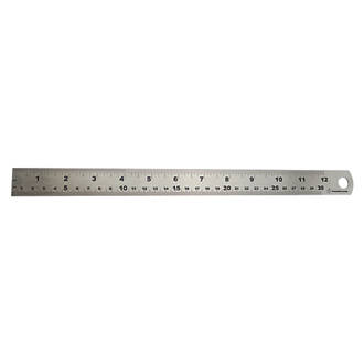

Thank you Woody. Are you suggesting that we can/should monitor it ourselves for 1 year? If so, any good resources for how to monitor?
and a diary basic but cheap . Works well (ruler available at screwfix) (y)
