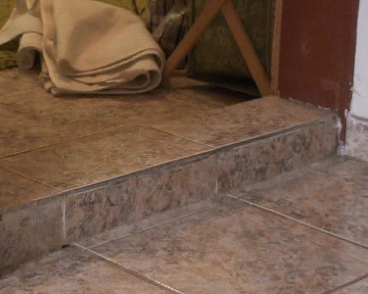

Now, this is driving me mad, take a look:
I have two options:
1, Remove the steps, then I'm left with a 10 CM gap under each door and I still have the problem of very high ceilings.
or
2, Raise all the rooms by 10 CM with an unbonded screed and then lay floor tiles. I think option 2 is better as it will make the ceilings lower which I prefer, but the problem is I've worked out the screeds alone would cost around £250 -£300 so would have to be done gradually. The thing is, are there any special preparations before I carry out the work? Although the floors are fine, I can screed directly over the tiles right? Should I lay membranes in each room and lay my screed ontop of them or is it unnecessary work?
So i just lay leveled battens on the existing tiles and shovel in the sand and cement mixture, let it cure, and then remove the battens and fill in the gaps? I can't remove the battens while it's curing otherwise I'll be putting my foot in it :mrgreen:
I wonder if there is something structiral under than tiled threshold, part of the frame, or if it is intended to prevent floodwater?
or maybe the builders intended to screed the floor and didn't get round to it?
knock one off and see what it's made of.

Hi JohnD, thanks for your input. When we viewed house, there were gaps of 10CM under every door and I think what has happened, the builder couldn't be bothered putting in the screeds to bring the level up to fill in those gaps so to make it easier for himself, he's just added steps instead :eek:
But to be honest, I'm wondering now what he's tiled over! Could be just bare earth for all i know. But the tiles are very secure but there are a couple of hollow ones. And the floors are absolutely freezing in winter i cannot describe the cold so those insulation blocks would be ideal. But would they be strong enough to walk on? Thing is with boarded floor, getting the wood is a bit tricky. They're not very struck on wood here, everything's concrete and tiles!!! :eek: I mean they do sell wood, but not a good variety and i dont like that thin laminate crap they do. You can't get plywood and hard board here or at least ive never seen it. I'm jujst not so sure wood would be suitable for the kitchen either so still not sure what is best. If only I could tile over insulation blocks :mrgreen:

Hi JohnD, decided to go with the more practical option of laying floor tiles instead of a floating wooden floor. Any advice on whether I would need a membrane down before I lay screed or do you reckon would risk damp problems such as condensation as the membrane would be placed over existing tiles?
The tiles are very secure and are laid on a concrete base. Can't lay insulation as don't have enough height to play with so will just lay the unbonded screed which will be about 70 -75mm leaving 9mm for new tiles and adhesive.
EDIT: Probably no need to reply now because was just thinking to myself, don't think would be necessary to lay membrane over existing tiles as the tiles form the barrier between existing concrete and what will be new screed anyway and there's no existing signs of damp.
