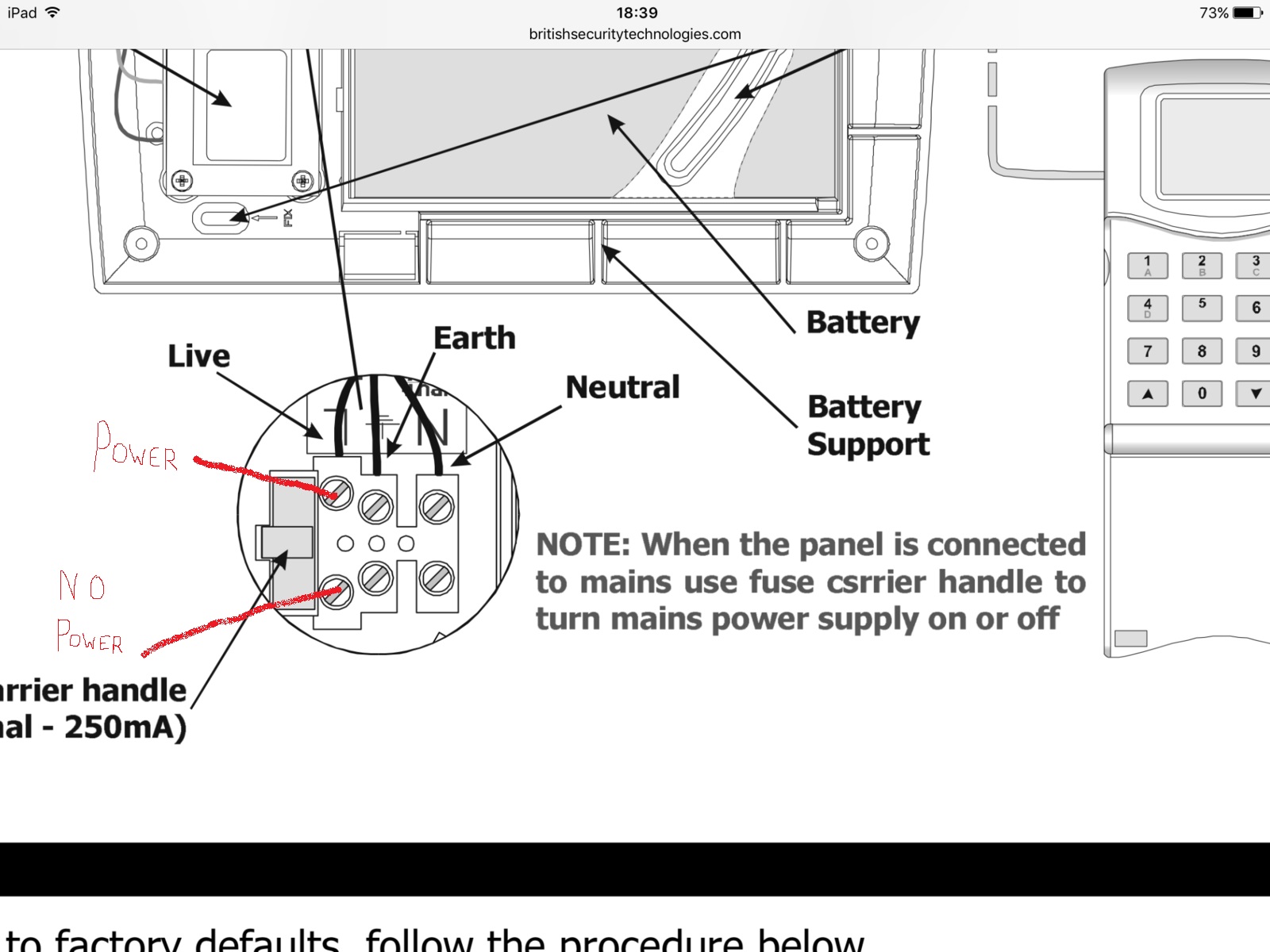

Hi guys, Hopefully after a bit of info, my mother has a sterling 10 alarm system which was fitted 10 years ago. Today for no reason ( the alarm was disarmed ) the alarm sounded for about 5 minutes then turned itself off. When I went over she told me what had happened, I went to the control panel to reset the alarm, no power at display. checked for power going into the main alarm panel, there is, so i took the front off to find that the mains wires goes into what I would call a chocky block, then wires come out of the other end of the chocky block but no live there. is it possible that there is / should be a fuse there ? this is bottom left hand corner. top left hand corner are 4 glass 1.2 v fuses, think the 2nd one down has blew, but don't think this has anything to do with mains power. Any ideas are most welcome.

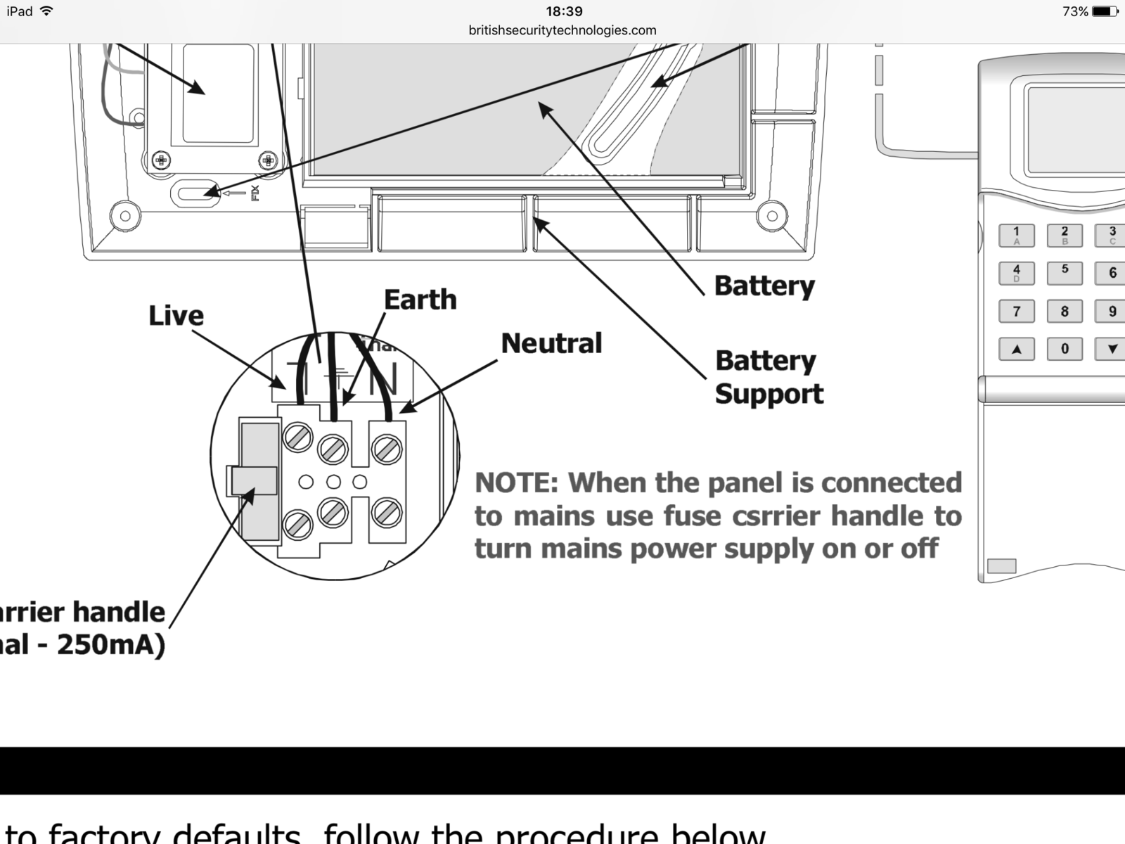

As per diagram
Probably a fuse in the connector block ( it normally pulls out ) but probably the battery is also faulty
right beside the chocky block or possibly even attached is what I would describe as a standoff piece of plastic, which could possibly house a fuse, maybe I knocked it out accidentally, if so would this be an ordinary 13 amp fuse ? with regards to the battery, I tested the output, obviously it was not charging with no power, but output was only 2.6 volts. Would this really make a difference ? as I was under the impression that the sole objective of the battery was only to kick in when the electricity went off.
Thanks for the reply

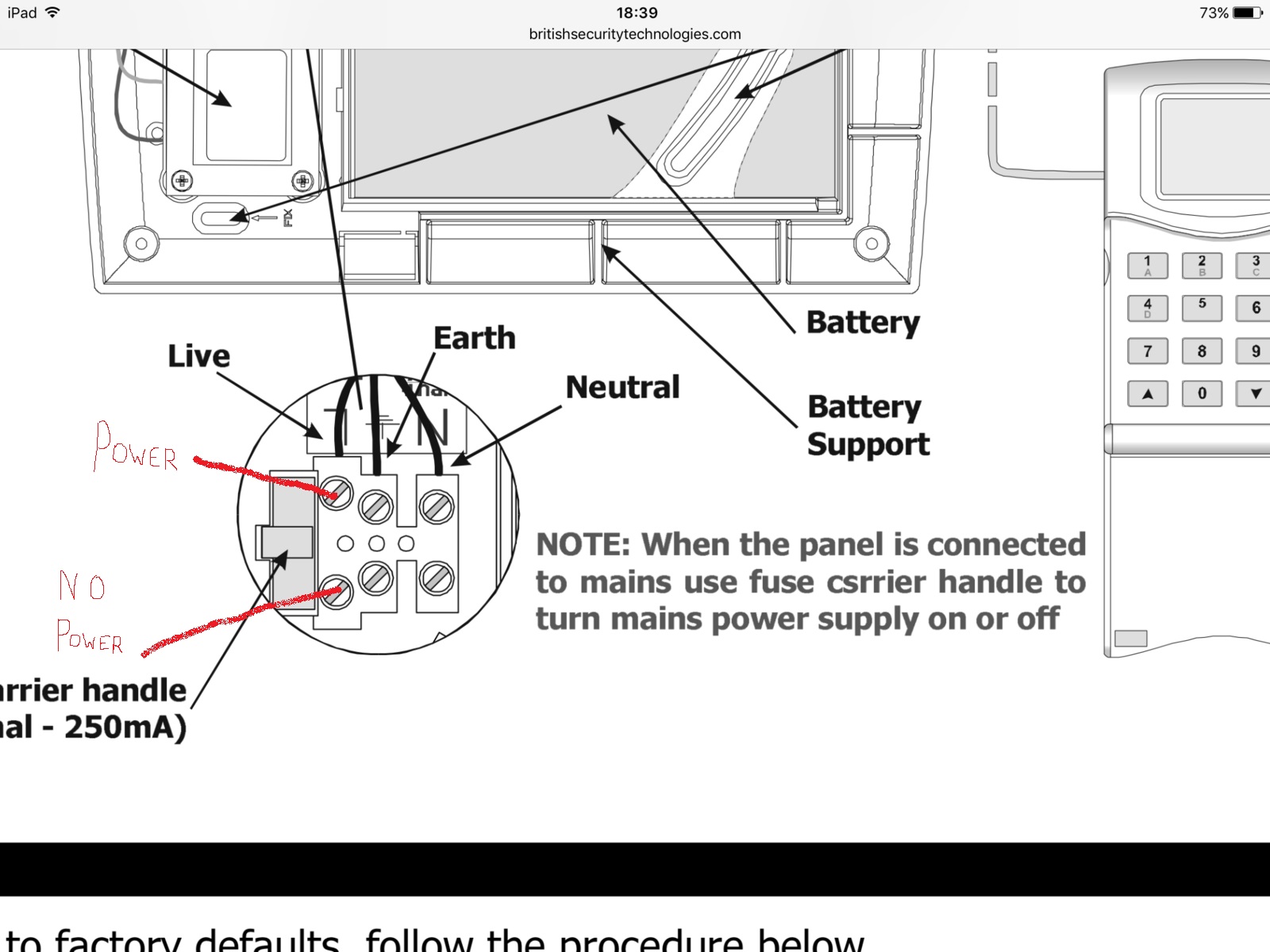

As per diagram
Cant really make the diagram out as it is too big, only getting so much of it, but the bit I described as a stand off bit of plastic, is called a fuse carrier in your diagram, does this push in and pull out ?as I did try pushing in and pulling out and got no movement at all from it
power at one side going in, but nopower at other end, coming out , does this fuse carrier take an ordinary household 13 amp fuse ?
