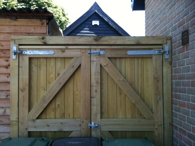

I fitted these gates and posts just before Christmas
and I was very pleased with myself.
Thing is, now they won't open. You can't really see from the picture too well but the coss beam has warped (upwards) slightly, and I'm thinking it has pulled the two posts closer together, and therefore the gates closer too.
Do you think this is the problem? If so, what should I do? Fitting another cross beam (which was a fence post - softwood), would probably result in the same problem?
Any help appreciated.

I looks like the gates are now just binding at the top - is that correct?
As the timber has moved a bit, by now its probably more stable.....can you plane one of the gate edges a little?
Failing that, see if you can adjust your hinges first!
A rain cap fitted to the top cross member - just to cast water - could be a good move to keep things sound in the future.
John :)
Timber swells (and contracts) across the grain, so the opportunity for gates like yours to 'grow' a few mill, width wise, is enormous.
I think you need to allow a bit more clearance.
wow some timber there pal.good job,as above its still growing,how much rain have you had?
coz it might pay to remove just a smidgen and then leave it,because if you remove too much when it drys out and shrinks the gap may be huge which will bug the hell out of you.
My gates move by 20mm over winter, in summer I have to turn the look keep over to keep it locking as the gap widens.
