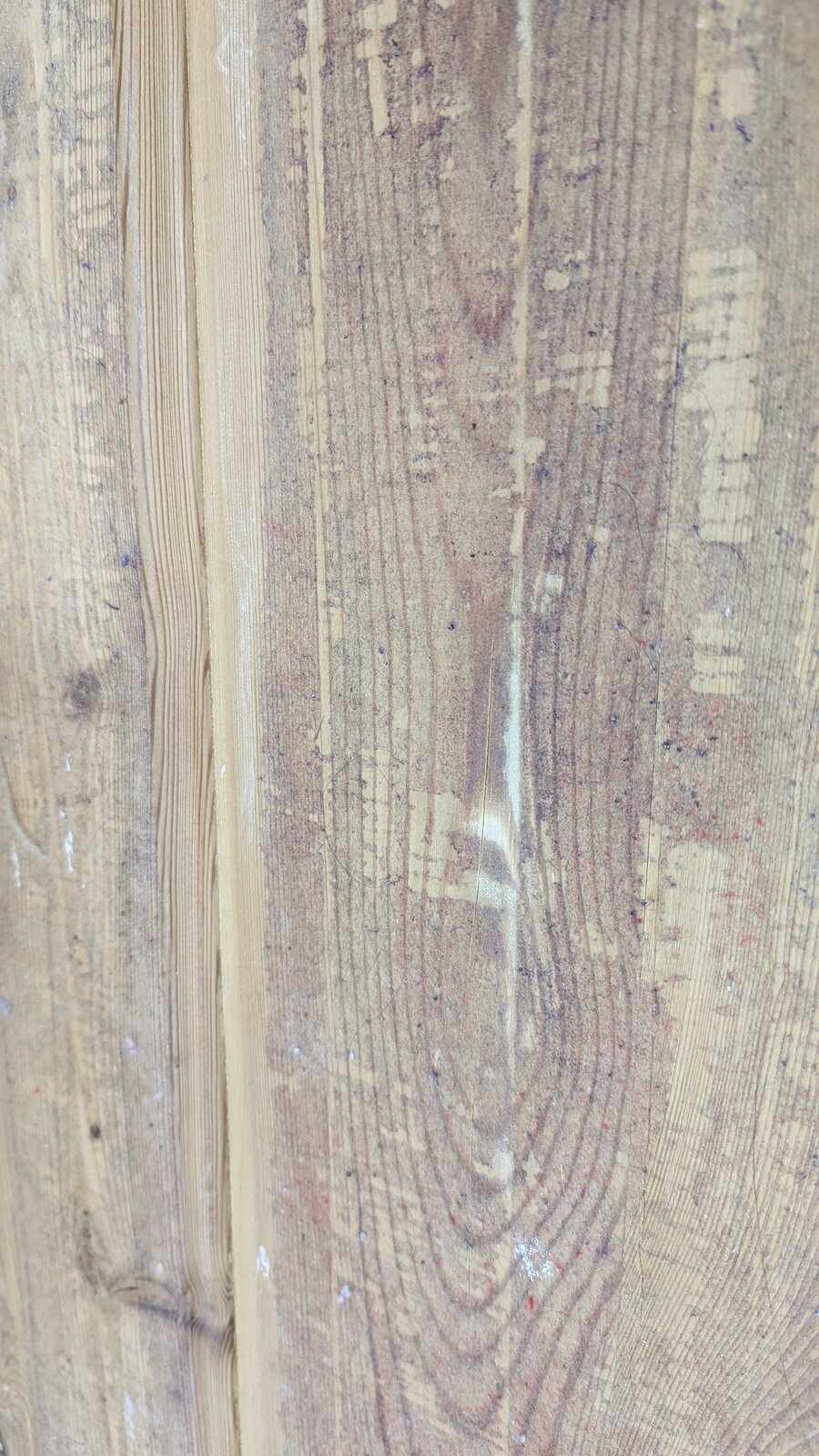

Hey,
We have an old wooden door that the previous owners which has some super sticky residue left on it from the previous owners along with accumulated hair and dirt D: gross!
Originally I thought I'd sand it off and then repaint, but I've just tried sanding with a machine using 80 grit at the highest setting and the residue doesn't seem to budge much, so now I'm thinking I need a different approach.
Are there any good solutions we could mix up that might dissolve or remove the residue? And then maybe after the residue is removed I can try a light sand and paint. The residue covers basically the entire door, rather than just one area
I take it you don't know what it is residue of? White spirit shifts an awful lot of sticky stuff, at the expense of stinking out the house if used inside, possibly for several days. Try on a patch, preferably with the door outside if possible?
Yea no idea! I thought maybe they stuck some kind of decal on the back of the door because it was a kids room, but they must have taken it off a while ago since there's so much hair/grime stuck to it now. Unfortunately we don't have an outdoor space but I could try white spirits
What sanding machine? Needs 40grit to start .
It's a Bosch Home & Garden 200 AES - I guess I could try with 40 grit. The 80 really didn't seem to do much, maybe just moved some of the stickiness around
is it solid or veneered wood? they might have oiled it.
oxidised oil forms a gummy varnish and is practically impossible to remove.

I think it's solid, they're pretty old, the house is victorian but I'm not sure they're original. The central wood panels are very thin and they're quite misaligned so the door isn't really in good condition in the first place.

If it’s from stickers lighter fuel will remove , does not leave a residue like white spirit .
