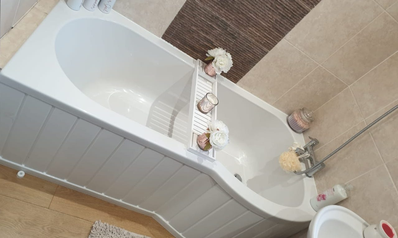

I have an odd shaped bath panel to replace so I want to make my own out of plywood. Is wrapping the whole panel in stickyback plastic a good way to avoid sealing/priming/painting the face and edges? I've not heard of it being done before so I'm just checking there's no obvious problem with it that I've missed. Can I use it straight on the ply without priming? (It's already sanded)

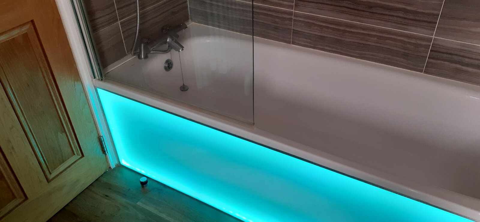

Here's one I did earlier, £10 of soffit will do two.
