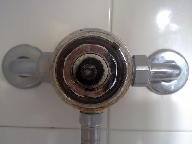

Hi,
I live in a 13 year old house with 2 identical showers in each of the bathrooms. Both have become stiff to operate - especially the temperature dial. I was wondering if I could service them myself. One problem is that I actually don't know what they are. Can anyone identify these? Once identified is a service kit and some silicon grease likely to solve the stiffness?
Here are some pictures of the shower...1 with the dial removed. It looks similar to a Mira 8.
All advice gratefully appreciated!
Cheers,
Daniel
it don't quite match the mira 8. looks very similar but the temp dial and the cover plate under the dial don't look right.
