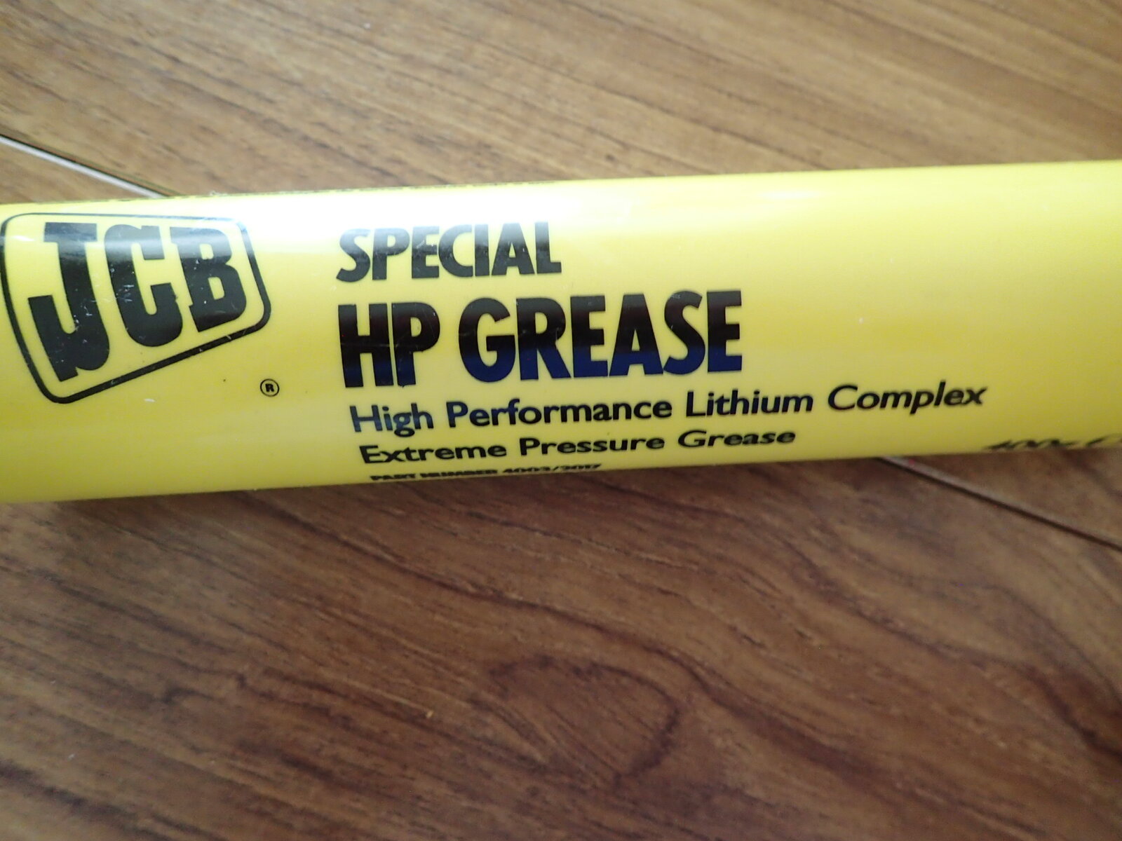

Tried 10mm nipple it fits, suitable to pump in grease then return to blank plug.
Would this grease be Ok the the Stilhl
Yes that will be fine.
