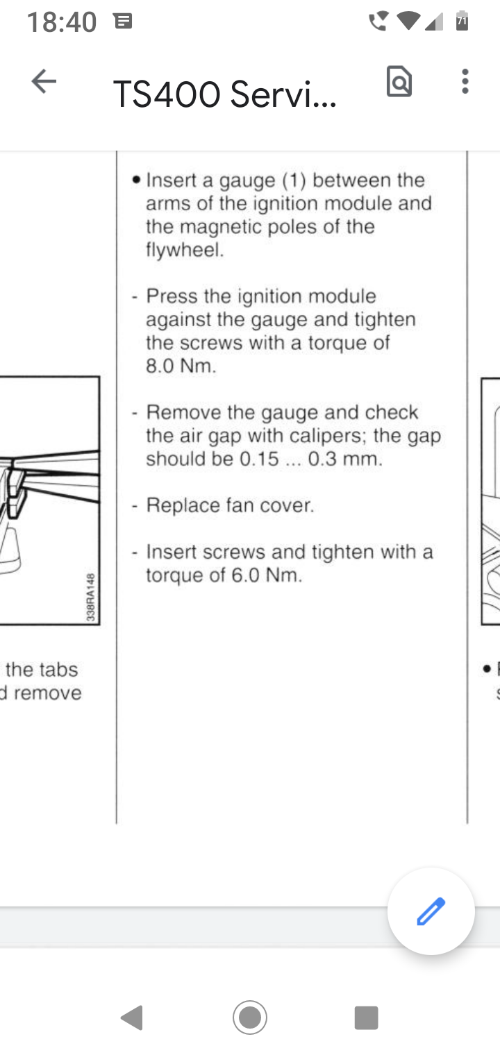

The igniter on these is pretty strong and the magnets on the flywheel don't fail. The air gap between flywheel and igniter should be only a tiny amount, two or three sheets of paper maybe.

Common A4 is .09mm so Johns 2 to 3 sheets are spot on
