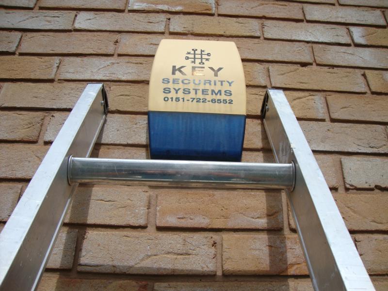

My son has a Accenta mini G3 alarm fitted with a remote LED keypad, the bell box type is unknown. recently the strobe light began to flash approx every 10 seconds. The alarm will set and operates in all the prescribed tests.

A picture of the bell might be helpful.
There is nothing on the keypad/logs, tamper and attack clear as is all zones. Unable to supply picture at this time. any help will be appreciated.

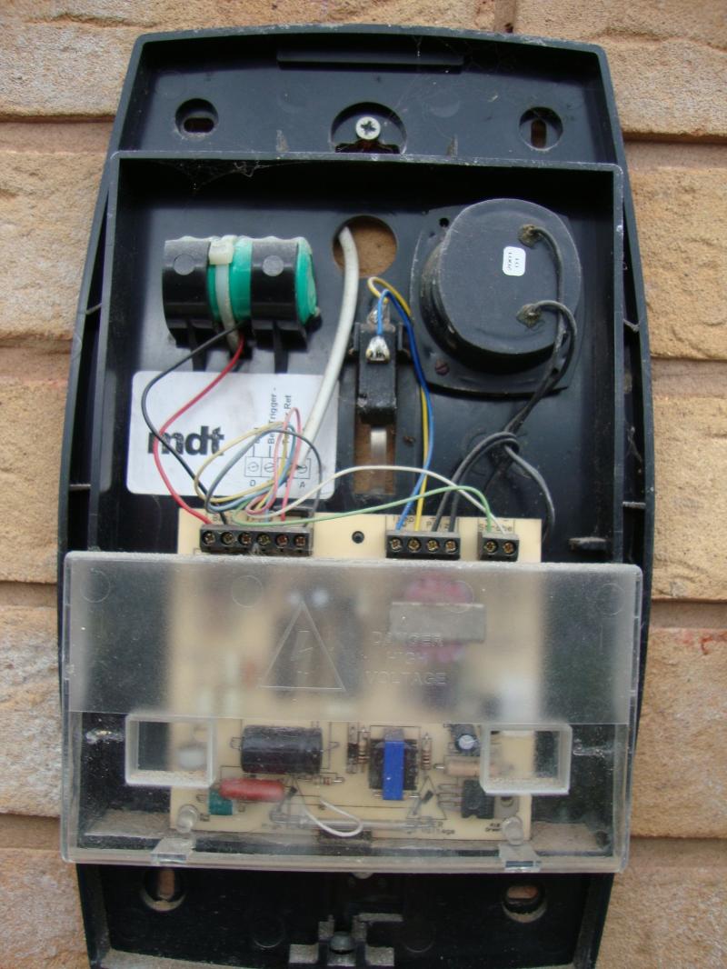

I would hazard a guess that you have a Texecom bell box (does it have two green LED's that alternate at the bottom?). There was a fault with these several years ago where once the strobe was triggered, it would carry on flashing, regardless of the state of the panel. The built in "strobe tube saver" software of these bell boxes slows the flash rate of the strobe down to around 8hz one hour after activation (one flash every 8 seconds or so)
This may explain your problem!
Hence asking for a picture :D
Find above pictures of bellbox, My son powered down the system and removed the battery from the panel, the strobe stopped, on reconnection the strobe remained off until the mains power was resumed. All the logs where ok and the system was fully operational apart from the strobe which was flashing every 10 seconds approx.

Where you able to identify the bellbox from the pictures?

Yes and no, Avanti maybe?
