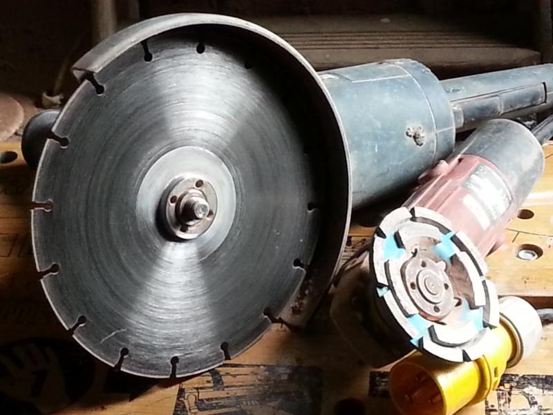

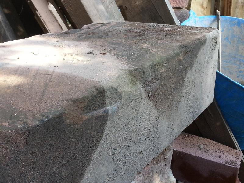

I've dismantled a stone staircase (down to a cellar) and want to rebuild it. But first I'm cutting the stone and grinding the surfaces flat to remove a century plus of wear.
The question is, what do I use for the final finish to remove the inevitable marks left by the wheel action?
I presume there must be some sort of flat carborundum medium to remove the disc marks and scratches.
Where would I get such a thing?

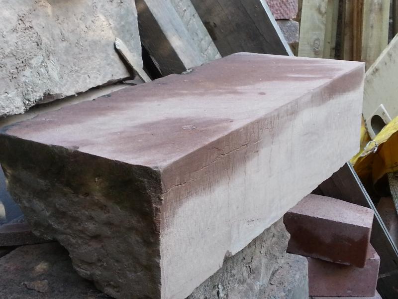

I want it dead flat & smooth, as would've been originally.

did you use a continuous diamond disc and water when you cut them?

Used the wheels I've pictured to cut and flatten.
Used them dry. Am I best using water?
To be fair, it's not a bad job, they're pretty flat.
I just need to get them really smooth like originally. If I use sandpaper it's obviously not going to have much effect on the stone.
Is there an obvious alternative to get the steps smooth?
