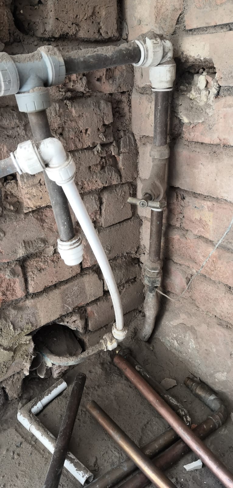

Hi all,
We have a stop cock that is leaking at the gland nut (where the tap is turned off/on). The main water pipe is lead.
I will just replace it with a new one but should i just get a 22x15mm stop cock or get a 22m version and then reduce to 15mm. Is there any point in using 22mm all the way to the bathroom about 2.5 meters directly vertical to the bathroom? the lead pipe inside diameter is probably 15mm anyway?
https://www.bes.co.uk/brass-stop-cock-22-x-15mm-23524/
I asked for a quote from Thames sometime back and they said 3.5k or something which is too much! Not sure how they would charge that as the main stop cock just outside in the front garden is blue pipe to that. anyway i'll stick to the lead.
Ignore the other connections you see, needed to hook up the garden hose temporarily and just used what i had available. Cheers.
If it is 22mm x 22mm currently I'd replace it with a similar one.
looking at your pictures, the copper pipes into the stopcock are 22mm, so why use anything else?

Stick to a 22 x 22 stop cock as you have - gives better flow - every little helps ! You could replace the lead with plastic blue pipe yourself if the outside stop cock is within your land. Or get a quote from a private plumber.
Hello all,
I'll get a 22mm stopcock then... for some reason I have 15mm stuck in my mind! Glad you've corrected the situation :)
