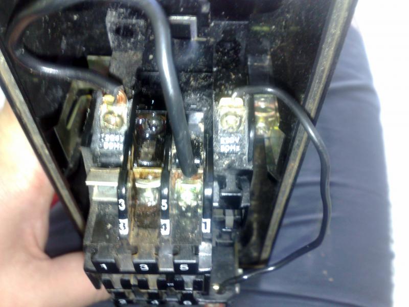

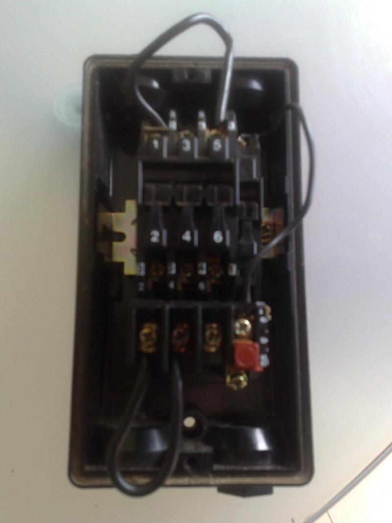

Hi people need help basically with a stop / reset switch that im going to wire up in my father in laws garage to feed a water pump its the correct rated contactor to do the job its a Danfoss CIM 12a reset / stop button which was doing the same job somewhere else but unfortunately when they disconnected it they didnt note any connections down so now im left with this theres no circuit diagrams with it either and no information on the side which is of any relevant use for wiring it and basically contactors are a alien to me ive supplied pics of just hoping someone can point me in the right direction the links have been left in tho from its previous use ..........Oh and the water pump is a single phase pump just want this to drive it
The photo on the right shows the top left terminal saying 264 v 60 hz and the top right says 220v 50 hz and you can see how these were linked quite confusing really

The terminals you speak of are for the contactor coil. What causes the pump to start (contactor to energize) and stop (contactor de-energize)?
I take it these are the only 2 terminals for the coil?
cheers for your response spark123 erm forgive me for sounding like a complete novice but I dont understand completely if they are the only 2 terminals for the coil or not I understand how the contactor works but ive never wired one ever and on the side of it it doesnt say which terminals are for the coil ........I just need to know what terminals to wire by incoming feed to and supply load to, obviously the earths to the earth tab but these links which were in there to begin with have confused me should I remove them ?

The terminals you speak of are for the contactor coil. What causes the pump to start (contactor to energize) and stop (contactor de-energize)??
If you could answer Spark123's question it would be a big help. Are there push button switches on the front of the contactor (i.e. it's a DOL starter) or was it switched remotely?
Oh ok sorry it just has one red stop/reset button on the front i havnt been round to the garage yet to have a butchers he dropped this into me yesterday I just rang him now hes using it for a pump to pump water into his garage as hes a mechanic im presuming itd be on continuously until he puts the stop button in ....Hope this is enough info for ya and your helps much appreciated

a contactor needs a supply. when the supply is started it pulls in some contacts (funny that) one set of contacts (or two) supplies what ever (pump in your case) the other set override what it was to start it in the first place.
to stop it a stop switch(or more than one) is wired in series with the supply to the coil

cheers Breezer looking at my pictures where would u say to wire then i.e the feed coming in going out
i wouldnt. sorry but your pictures speak a lot but say nothing.
i would be inclined to get a meter out and find the coil then and then take it from there (you only want a minimum of two pairs of contacts that go closed when coli energised)

The stop button should be the very first item in series in the control circuit, for safety reasons.
