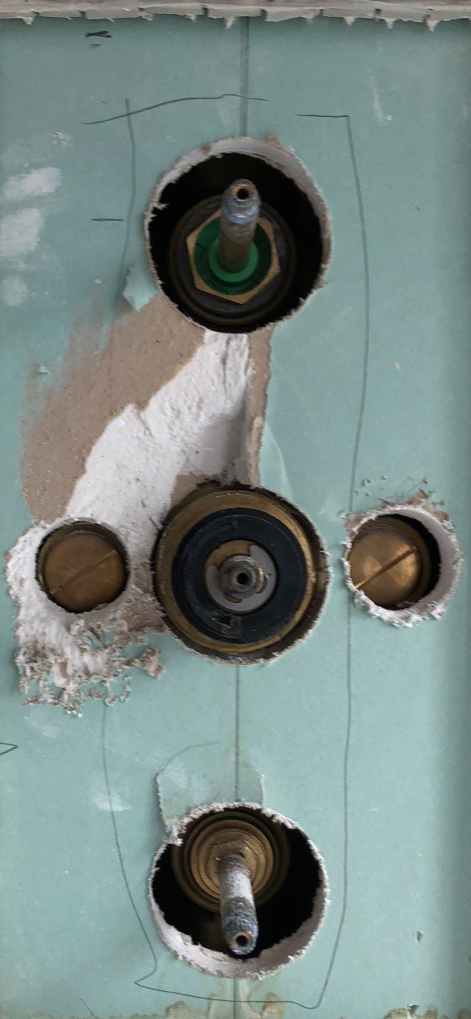

My concealed mixer has developed a drip so I figured it was time to change the cartridge.
I took the controls and panel off and the tiler had only cutout for the 3 controls, so I had to use a holesaw to expose what I presume are the stop valves either side of the mixer control. (I mention this incase anyone presumes they must be the stop valves since they have been cutout by the plumber/tiler).
Unfortunately the stop valves don't seem to have any effect on water flow. I turned them clockwise until tight. I then tried anti clockwise and they start to leak after being turned 45deg from the original position.
Has anyone come across similar looking stop valves? Or am I an idiot and theyre not even stop valves :(
I thought it best to check, rather then forcing them to turn further (with some sort of lever) and potentially damaging them.
I have another bathroom, but the Mrs is getting twitchy already, so any help/advice greatly appreciated :(
Hmmm, having done some further searching I presume these are in fact the filers/check valves :(
I guess (hope) the stop valves are under the bath as there is a grouted in panel there. But I'd presumed that was for accessing the drain, rather then stop valves, as to me it would have made sense to place them by the mixer :/
Don`t look like any isolating valves I`ve seen. They might be in the loft if the pipes comes down from there.

Thanks for the response. I'm coming to the conclusion they are in fact filters/non return valves for the mixer :(
I've cut out some more of the board and can see one of the supply pipes runs down towards the bath. So think (hope) the plumber has put stop valves under there. There is a grouted/screwed in tile panel there. Not easy to remove the grout and dont want to chip a mosaic tile, so either got to grab a grout knife or be lazy and pay for one of those electric removers :/
There is also a supply shut off for the whole house. But I have a megaflow and 3 other bathrooms, so would rather not faff around draining then refilling the entire system.

They are filters and or NRVs.
As you are looking to change the cartridge you must have the make and model of the mixer, which means you would be able to get the MI's no? They would give you the info you need on the valves.

Just to update the thread for anyone else that comes along with the same issues/questions:
1) They were filters and not stop valves. Opened them an cleaned them
2) Shutting off the mains didn't cause any issues as you all advised.
3) Finding a matching cartridge was a PITA. Lots of generic ones that looked similar, but were out by a couple of mm's. Eventually I realised the colour of the cartridge was the key, I searched on that and found a matching one on Amazon :)
Hope that helps anyone else with the same issue.
