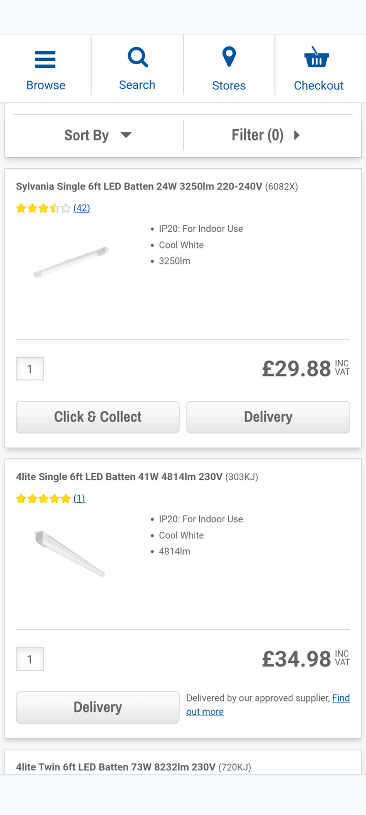

Just weighing up the choice between the above and replacing the whole fitting with a dedicated LED fitting that has a non-replaceable lamp.
Has anyone bought LED tubes for a standard fluorescent fitting?
Were you impressed?
i just replaced 3x 6ft tubes in my large 3 car garage with the screwfix complete unit - very easy and so much brighter - no idea on the LED replacement bulbs/tubes - but my lights where going rusty and 1 was buzzing and i have used the screwfix lights before, had one fitted just to use when DIYing - sawing, etc at the front space where the car would go - used that a lot, and its been great , before covid , so always intended to change the others
They where on offer at screwfix around £30 each, twin LEDs and daylight - cant find the order - strange....

LAP REEVE TWIN 5FT LED BATTEN 45W 4050LM 220-240V (146PP)
maybe i paid £24.99 on offer .....
Just looked at those, thanks. They have external clips and end feeds. No good for a kitchen.
