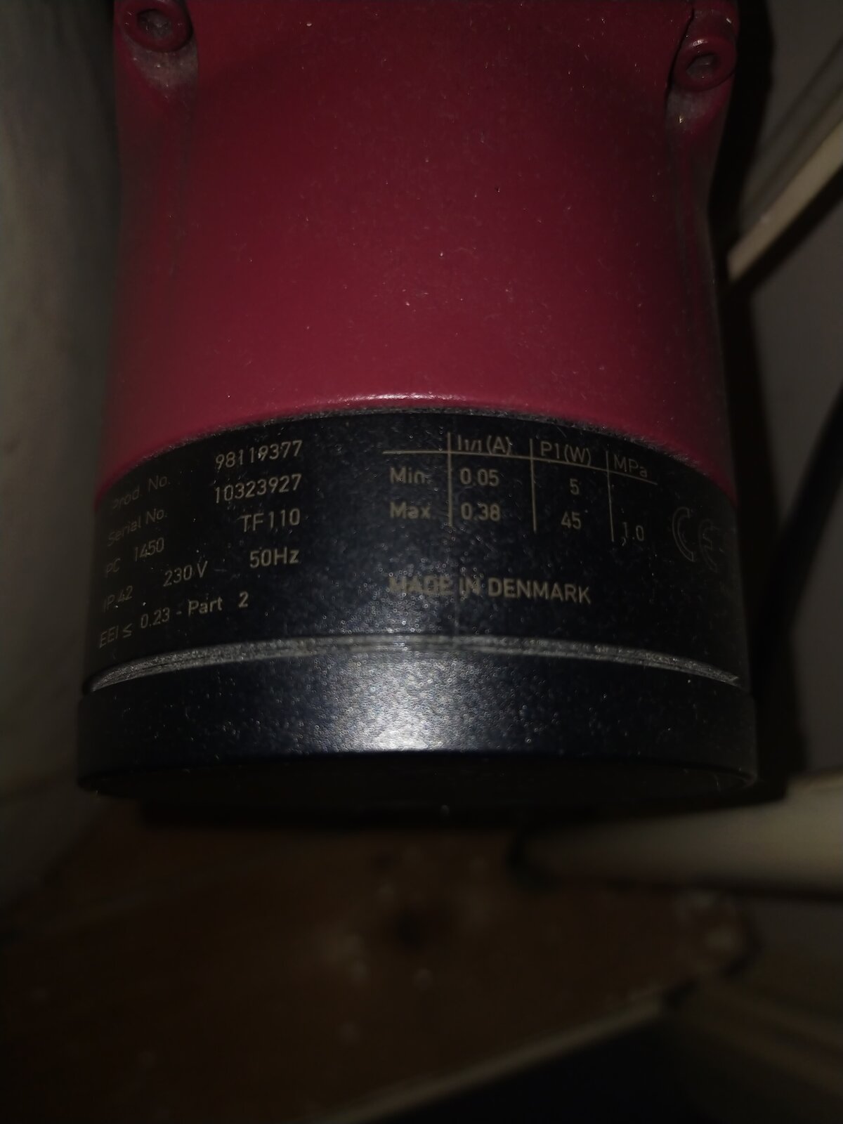

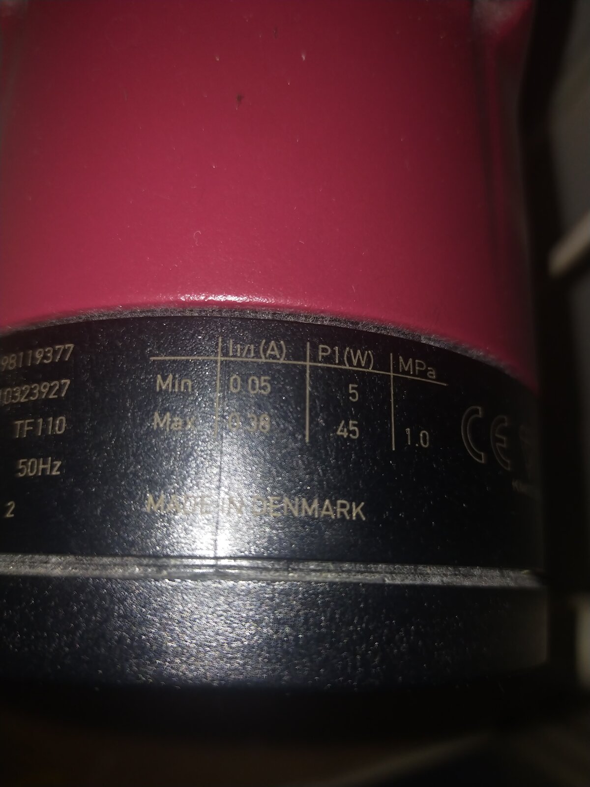

There is definitely something up with that pump, 20/22W on CP2 means the pump theoretically anyway is pumping nothing but it must be circulating something if the HW cylinder & (some) rads are heating up?, I would remove the pump head as suggested above.
Just confirm that this is your pump, a 6M.

Well, you will have to check out the condition of that pump, I would remove the head and inspect it before throwing a new pump at it, how old is it?
a few years now it was swapped from the original pump awhile back by British Gas, when it gets warm, ill have a look at taking pump off, unless it goes to crap before, what sort of pump should i be looking at to replace this one with at some point, 14 Radiators 6 up 8 down.

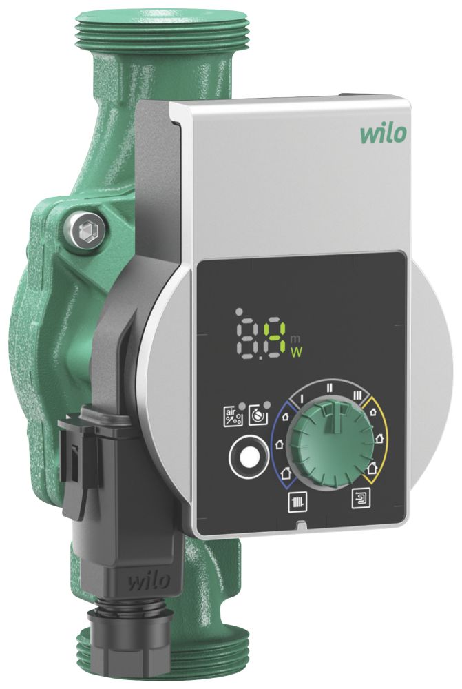

6M Dab Evosta 3 which also displays the flowrate as well as the power. OR like my own, a 6M Wilo Yonos Pico, probably a bit cheaper but a very nice quiet pump, mine is 5 years old.
Thanks ill take a look.
