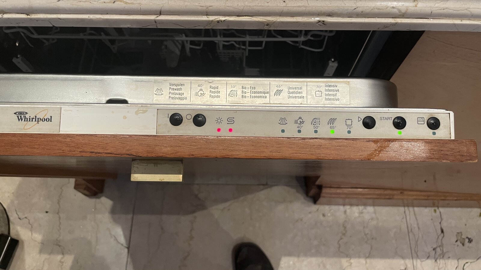

Hello community
I have a strange glitch at this dishwater.
I read a lot here and other sites before posting.
When I run a diagnostic test.
Nothing will fail.
When I want to run the eco 50*program.
It will stop after a while and stop before using the soap
With many beeps sound
Start flashing
And prewash light still
God bless
  1. Check the door latch: The dishwasher may stop if it detects the door isn't properly closed. Make sure the door latch is functioning correctly and the door is securely closing.
  2. Check the dispenser: If the dishwasher is stopping before it dispenses the soap, it could be a problem with the dispenser mechanism. It might be jammed or broken. Try to manually open and close it to see if it’s functioning correctly.
  3. Inspect the water inlet: Make sure the dishwasher is getting enough water. If it isn't, it might stop part way through the cycle. You can check this by starting a cycle and after it fills with water (before it should dispense soap), open the door to see if there's enough water at the bottom.
  4. Check the heating element: The Eco 50° program requires the dishwasher to heat the water to 50°C. If there's a problem with the heating element, the dishwasher might stop.
  5. Clean the filters and spray arms: Sometimes, the problem could be as simple as clogged filters or spray arms. Make sure they are clean and not blocked.
  6. Inspect the drain pump and hose: If the dishwasher can't drain correctly, it might stop part way through the cycle. Check the drain hose for clogs and the pump for any blockages or failures.
If the problem persists, you might have an electronic or sensor issue that requires professional assistance.
