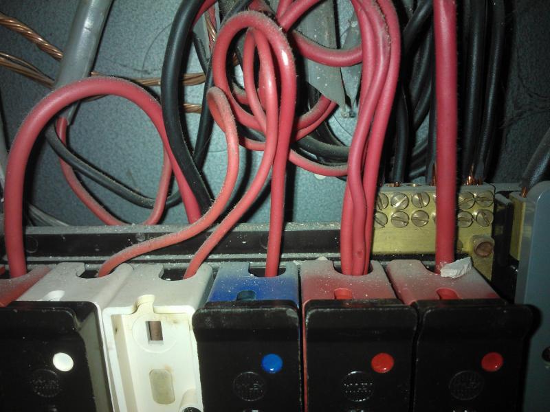

Firstly, my fuse box has 6 fuses (see picture). There's a fuse for circuits as follows and in order from left to right; shower, d/stairs lighting, u/stairs lighting, water heater, plug sockets, cooker.
I was replacing a couple light switches around the house today and decided to pull all the fuses except the fuse for the sockets as I wanted to keep some stuff running.
But I noticed that as well as the plug sockets, the combi boiler was on too, which I would have thought would run on a different circuit to the sockets.
I would have assumed it would run through the 'Water Heater' fuse at the fusebox as we had the combi boiler installed in place of the old water heater etc in 1997.
Out of curiosity, I went and pulled the fuse for the plugs out and instead put in the fuse for the 'water heater'. When I did this, all the plug sockets and the combi came on.
Is it dangerous to have the boiler on the same circuit (seemingly) as all the sockets, and how would two separate fuses control the exact same circuits?
It seems possible that the (assumed) ring circuit supplying the sockets and boiler has each end fitted to a different fuse.
This really needs rectifying pronto as the next person who makes assumptions that the place is wired correctly might have a very nasty shock

Here are a couple more pictures inside the fuse box. Don't worry it was all isolated, apart from the live tails coming in of course, I can't isolate those regrettably.
Looking at the two fuses in question, does this tell you anything about how it may all be wired up?
Three wires going into the 'Plugs' fuse and one wire into the 'Water Heater' fuse. As an untrained person, this baffles me.
Can't really say just from looking where the error is. It may be as Plugwash says, theres a link bridging the circuits somewhere in the house. It could also be that what you have is the two ends of a ring split over two fuses.
It will probably need a certain amount of disconnecting and testing continuity here and there with a suitable meter.
If you don't feel comfortable doing this (or you on't have any test equipment), then it may be time to bite the bullet and call a sparky in before someone has a nasty accident.
There is no obvious link between the 15Amp fuse and the 30Amp fuse at the Consumer Unit. Assuming the 30Amp has a ring final circuit and a spur and the 15Amp is a single radial final circuit.
But your description of what happens when you energise the two circuits separately suggests to me that you have a bridge on the ring final circuit - possibly between the combi boiler and the water heater.
Whatever is the problem is does need sorting out asap.
That all looks quite normal and fairly neat compared to many I have seen.
I doubt if the fault is in the fuse box so that needs to be closed up.
It could also benefit with some updating but you have a moore pressing situation to sort out and to be blatantly blunt Is time to call in an expert unless you think you have the ability to identify every cable in your power circuits
They don't really show anything that couldn't bee seen in the first picture. The immersion fuse has one wire as would be expected. The sockets fuse shows three wires which is a little unusual but not nessacerally wrong (it's acceptable to take a spur from the origin of a ring or radial circuit).
As I already said someone needs to map out what wiring goes where so that they can work out what changes are needed to safely seperate the circuits.
You either have a bridge between circuits or your RFC is being supplied by two fuses.
The only way to find out for sure is by having the circuits tested.
You could try removing each conductor at a time from the fuse protecting the RFC. See what powers off!
Some one could have been altering circuits and parked the old immersion circuit in the RFC fuse and the other leg of RFC in immersion fuse.
But I would recommend having it tested for continuity/r1+r2

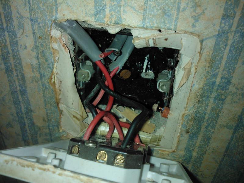

I've found a few bizarre things today though. For instance, I was changing the double light switch in the kitchen and found a wire tucked away at the back of the box that had been cut and had bare ends! I couldn't test with the multimeter as there's no neutral present at the switch but I taped it up firmly for now.
It would appear the cut off wire was one of the original lighting wires for one of the two kitchen lights. Another T&E has been added as you can see, practically on the surface of the wall and coming in at an odd angle.
But then what's this in the bottom right of the box? Why it's a bit of 2-core lawnmower flex. Luckily I discovered that had been cut off both ends, it leads into a pantry area. I reckon someone had tried to use it for a light, not realising they needed a neutral too.
Just had a second look at the pictures and now think you really should be calling a spark in sooner rather than later.
