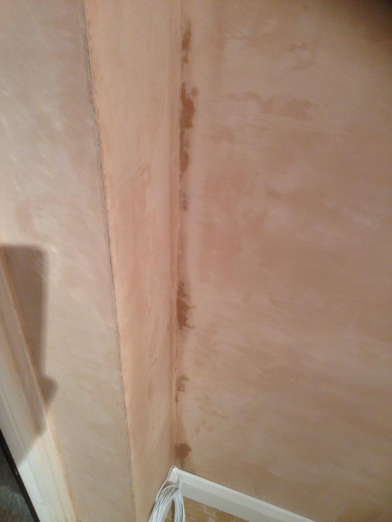

Hi.
Someone may have seen this before.
I did some plastering last week and the skim seems mostly dry except for some strange small damp patches just in the corner.
And a bit closer
Underneath -
I replaced a wood & glass partition between the hall and the lounge and built a wall with thermalites blocks.
The bulk of the area on the right was dry lined with d&d plasterboard, leaving just a small strip about 4" wide up against the corner. (Where the damp is).
This was filled with bonding and the whole wall skimmed with multi finish.
The bonding went on last weekend and the skim on tues eve.
There's no plumbing anywhere near and there was no obvious problem in the corner before.
I'll leave it a bit longer to see if it clears, but the damp looks localised but very pronounced.
Any ideas?
Left the internal door open last night and it seems to have eased a bit.
Maybe moisture from the bonding just taking its time to work out.
Should imagine that's the problem newby,,The bonding would have soaked up a lot of water and being thicker than the skim would take a bit longer to dry out.. If there was no damp before you did it then there shouldn't be any now,, ;)
Thanks Roy.
I'd expected more damp there, but was expecting a uniform strip about 4" wide, in line where the bonding was. I was surprised it was just little patches that were very pronounced. Not seen it before.
I had wondered if putting pva over the damp bonding next day had perhaps sealed it a bit and then the damp could only get out in limited areas.
Either way, I'm hoping it will clear on its own.
