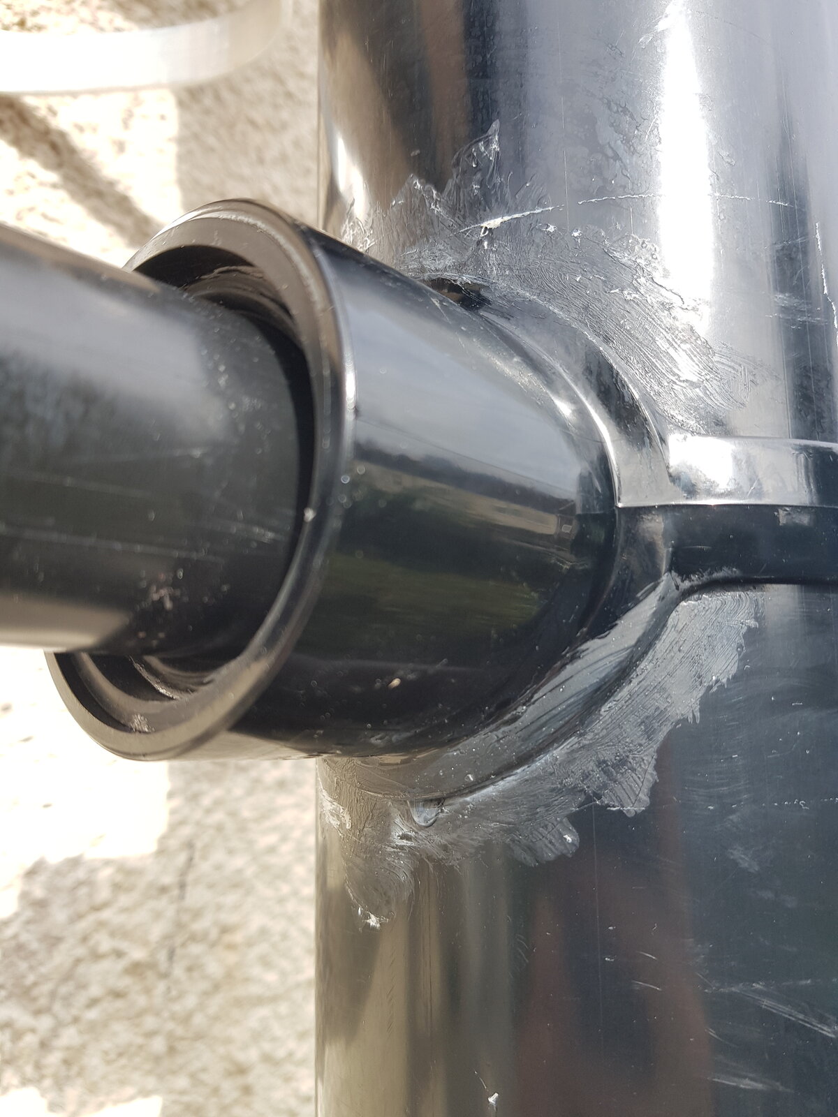

I just did my soil stack and to my dismay where the 40mm pipe joins the 110 soil stack with a strap boss, there is a very tiny leak on the underside where the strap boss connects to the 110 pipe.
I did scratch up both surfaces and used adequate solvent weld glue, so not sure why this happened.
Can it be fixed somehow? It would be a nightmare to get it all off
I know it's messy, I tried to get a little more solvent glue in at the end which was stupid!
Try some fernox LS -X round it - can't look any worse ;)
It's quite expensive that stuff with delivery!
Would it be pointless to dab it with solvent glue a few times in that area? It must be the tiniest little gap, as its just a drip every so often.
I know, it looks bad! But it's sort of high up, so luckily not something most people would notice I hope!
Yes, dab with glue(y) can you get the pipe out and dab inside with a gloved finger ?
Ah good idea. Yes I could actually as I didnt glue the other end yet. But I think the inside has a rim on it, so I dont think I can get to the part where its leaking or anywhere to make a seal. I'll have to look
