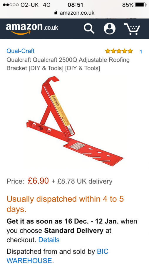

I'm about to undertake stripping half an old garage slate roof before it's demolished and looking for some tips from the pros.
I was going to work off my roof ladders as a builder who is on site has a dodgy manitoo with an even more dodgy work basket that's falling to pieces that I will definitely not be going up in.
I've looked up roofing brackets on line so I can put a scaff board on then to have a safer footing and somewhere to stack the slates but come up short except these from amazon which will take a while to deliver.
I've seen roofers in the past with wooden ones with boards on at intervals up the roof.
Question is are these homemade or are these called another name that I can't find online?
Next question - the slates are to be reused elsewhere and have seen roofers just using a claw hammer and peeling slates off.. is this the best way or should I use a ripper?

Any idea about the brackets?
its a garage, why would you need jacks?

Just to reply to datarebel - The garage and roof is pretty big, (formerly an old working car garage and workshop) it's being semi demolished to make way for a new house being built on the land. I was unsure about the jacks but from what I gather is that they're more for use when slating rather than stripping.
