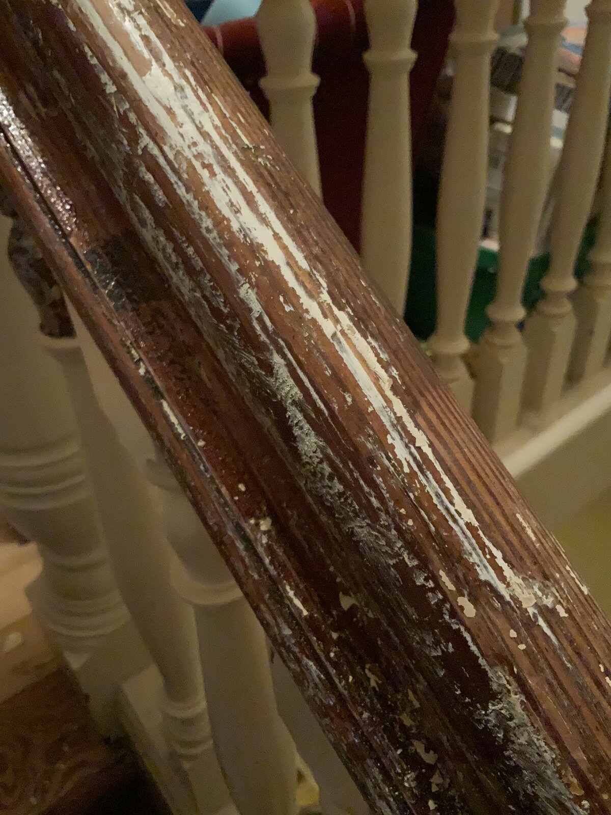

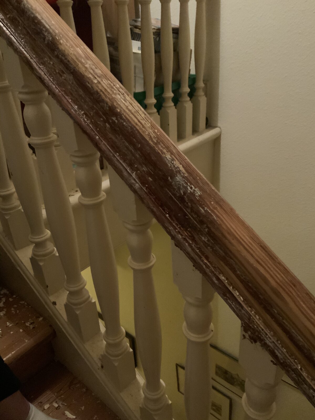

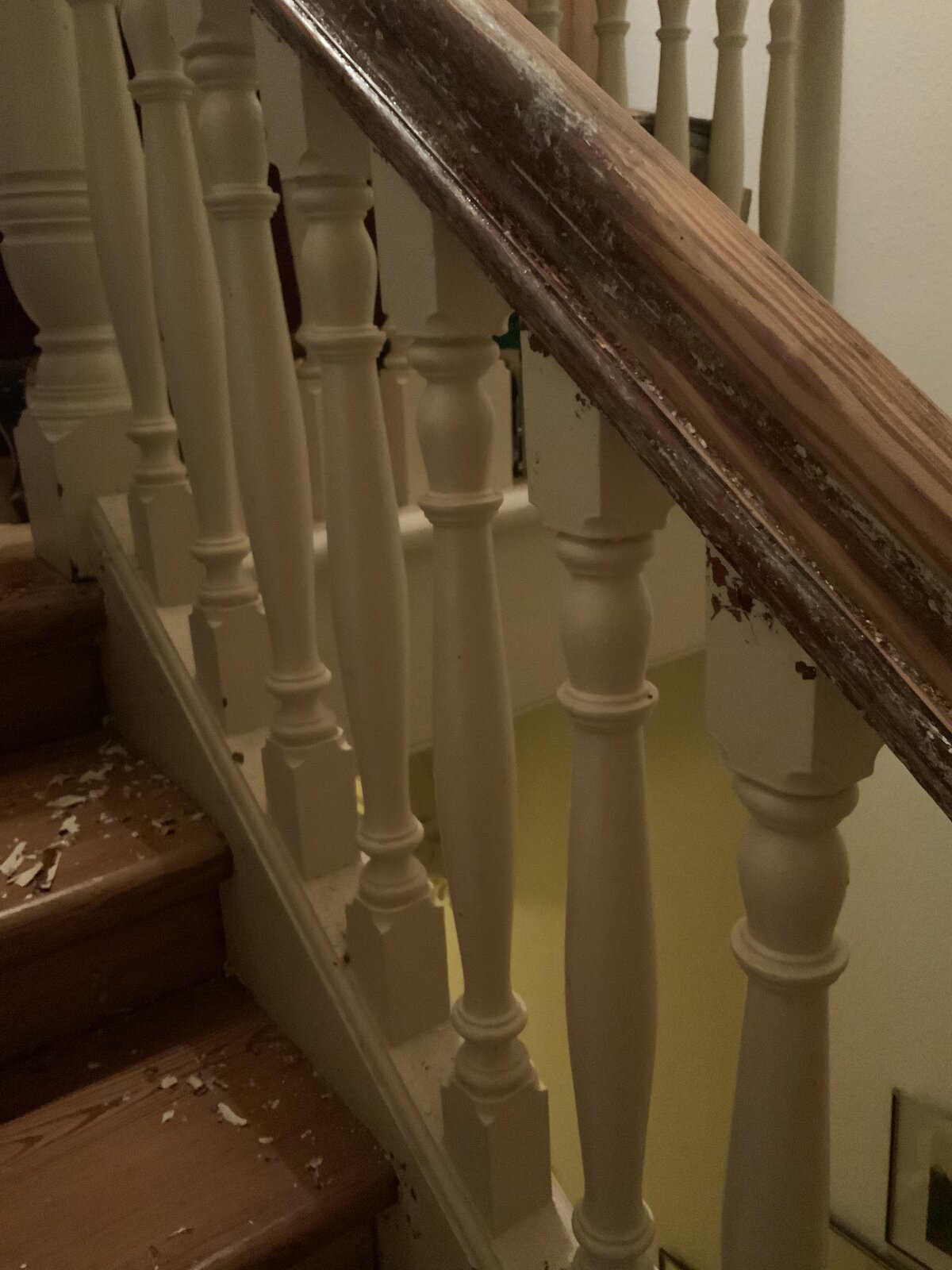

Good evening all,
We have started to strip decades worth of paint from our staircase banister. It's going to be a lengthy project and one that could end badly. So far, we have stripped a small section using a scraper and heat gun.
I have included pictures to see what people would advise next. Are there chemicals out there that will removed the ingrained paint? Would sanding down be the next step? Be interested to hear what may or may not work.
Ideally, once it's all stripped back to the original wood we'll varnish it and leave it in its natural colour.
See the attached pictures.
Any advice appreciated.

gmd06, good evening.
That looks like a nice old bit of pitched pine, will clear up well.
You have done well so far, suggest you now consider using sandpaper.
My preference is to use actual sheets of sandpaper, added to foam pads, the pads assist in maintaining the curves and contours, a sanding machine can leave you with "flats" on the curves which can be felt especially on a handrail.
Ken.
Thanks for the feedback. I agree that hand sanding may be better than machine.
I am thinking of replacing my scraper with a wire brush moving forwards as it'll be easier to get into the curvy bits.
I would be very, very wary of a wire brush, they tend to "raise" the grain of the timber.
Again my preferred method of getting into corners is a wood chisel, but not used as a normal chisel I use the chisel as a scraper, scraping towards myself and in the tightest of corners I have used a Stanley blade, again not in a cutting way but as a scraper, very carefully. try and get the edge of the blade into the corner.

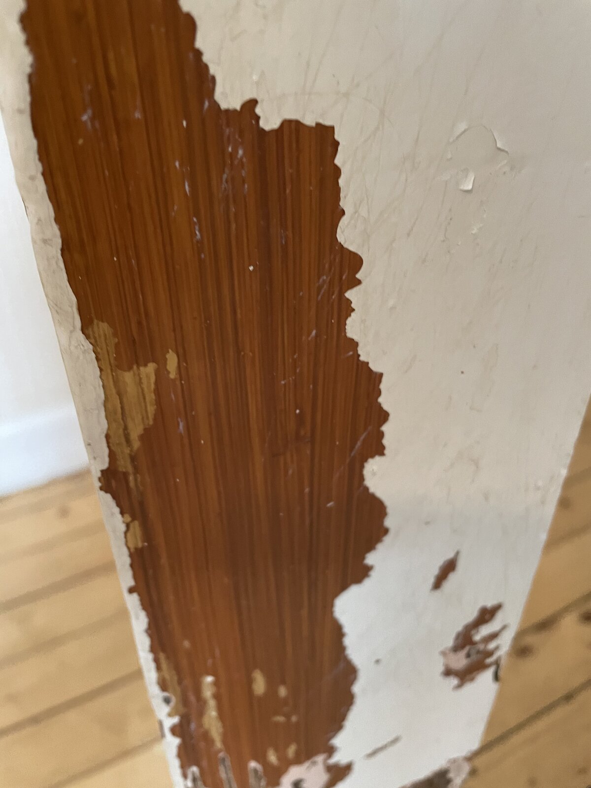

We are progressing slowly with this using the heat gun, scraper, wire brush and then sanding the aftermath. It's certainly not a quick job.
Wee bit worried now with the lead paint concern. We know that the top coat of paint was put on approximately 10-15 years ago so that won't be lead. Below that there was some wood effect brown coating that would have been applied in the 70s. We think that's all the coatings it has had. Why on earth anyone would want to cover lovely wood with wood effect coating is anyone's guess. See attached pic for what I mean. I also have a tester pot of the peelaway but not tried it yet.
