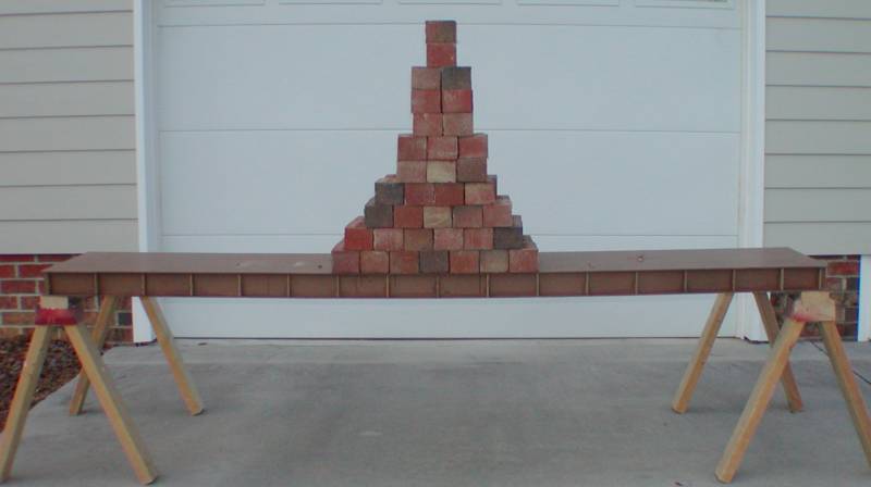

Just a little indication of how strong and rigid a properly constructed torsion box can be:
Above: Lightweight torsion box made by Alan Schaffer

That is a real torsion box and is not Photoshopped. It was made from 3/16in (4.8mm) thick hardboard for an article he published in American Wood Worker (magazine). It was 8 feet (2.4 metres) long, 14in (350mm) wide and 2in (50mm) thick with the ribs on something like 6in (150mm) centres. In the photograph it is shown loaded with over 300lbs (136kg) of bricks yet it is deflecting only 1/2in (13mm) in mid span. The first time I saw something like that demonstrated about 30 years back I was astonished. The first time I built a test piece I was equally impressed. Hopefully that illustrates the my comments effectively
