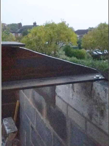

Here's one supporting an external wall where they went over-enthusiastic in cutting the web to accomodate a lean-to , but it worked.

A 7 m span for a 203UC is quite slender. Span to depth of 34.
Yes, wondered about that; be interesting to know what limit SE has assumed for deflection, particularly with a point load from the incoming beam.
