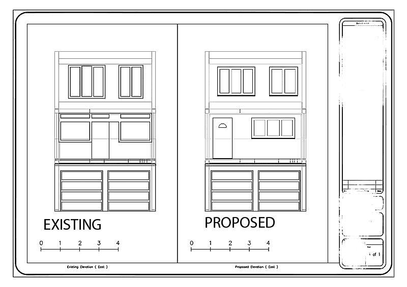

Picture quality is somewhat bad, looks like it has been resized or recompressed when uploaded. But hope still will give an idea of what I want.
[UPDATED] The wall in question is first floor with the door.

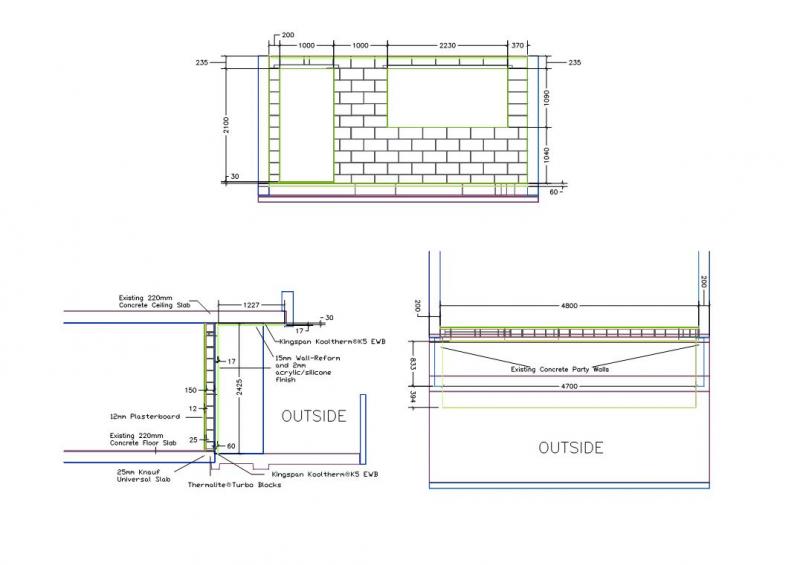

Other thing, on second floor there is internal partition wall of solid reinforced concrete resting across 2 slabs dead in the middle of the span.
It is 80mm thick, 2400mm heigh and 3.4 metre long and (assuming density of 2400 kg/m^3) weighting almost twice as much as my proposed wall with door, windows inside/outside render etc. included. (Slabs are of the same depth )
My proposed wall has a blocks/mortar weight of under 500kg and total weight including everithyng is under 900kg. Over 5m span.

The wall in question runs alond the whole span of single slab. It is not on ground floor but on the first and below are 2 garages.

I might be missing something too, but you basically want to replace a timber stud wall sat on a hollow core plank, with a new lightweight block wall, sat on the same plank? The wall itself is obviously not loadbearing?
Can't imagine the increase in load would be that great, but as Jeds said, without knowing exactly what slabs have been used, it's difficult to determine their capacity.
Have you thought about beefing up the heat and acoustic insulation values of the existing wall? Or replacing with a new, improved stud wall?
Alternatively, if you are set on using blockwork, you could give additional support to the existing hollowcore plank by inserting steelwork underneath.
Probably wouldn't be able to bear the beam into a reinforced concrete wall so would need columns or piers too...then footings as well...might get expensive... :eek:
