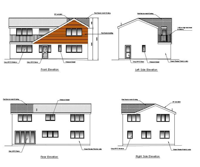

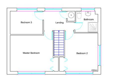

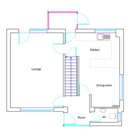

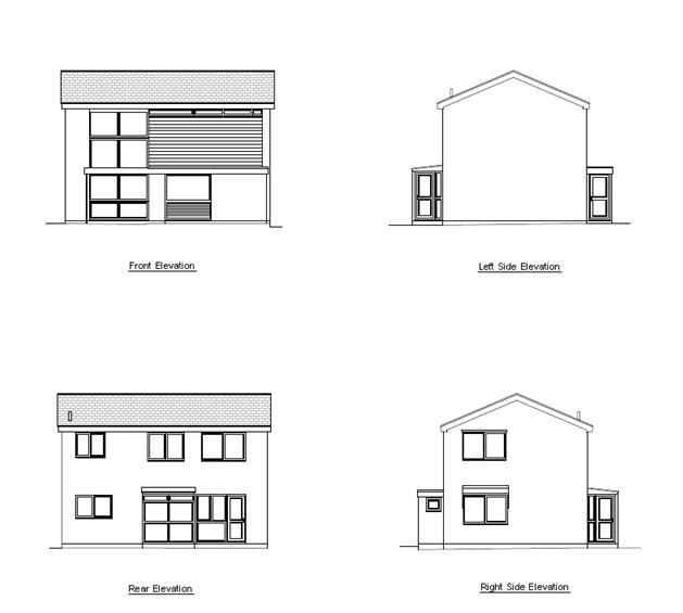

if it helps here are the floorplans and elevations. It is quite a big project with most of the front and side coming off.

I have to say though that I am deeply unimpressed with your "architects" plans. I suspect the engineer has increased their fee quote to reflect the extra time trying to work with those very basic plans and the extra design input they will need to adopt.
I assume those are just the planning drawings. It might be worth going back to Fast Calc with the detailed Building Regs drawings when they will have a better idea of the detailed construction. Or maybe get a new "architect".
The architects are 2 very nice guys however unfortunately that is where the good part of the service stops. As mentioned previously I haven't been impressed with their service / competence hence why I would rather use someone like fast calcs.
The drawings are only for planning (and in all honesty the layout / design was done by me in the end and they have just laid it out for the planners). The building regs drawings are supposed to be forthcoming after the structural calculations are completed.
I have been told by a number of people the plans are extremely basic and given that this is my first project I have maybe been a bit naive with my choice on this part. Anyhow it has been done now so onwards and upwards.
